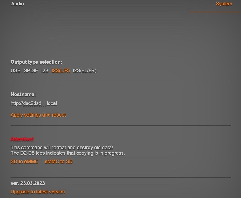

Hi Pavel,
Thanks for continuously support of the firmware, wondering what's difference between I2S and I2S(L/R)?

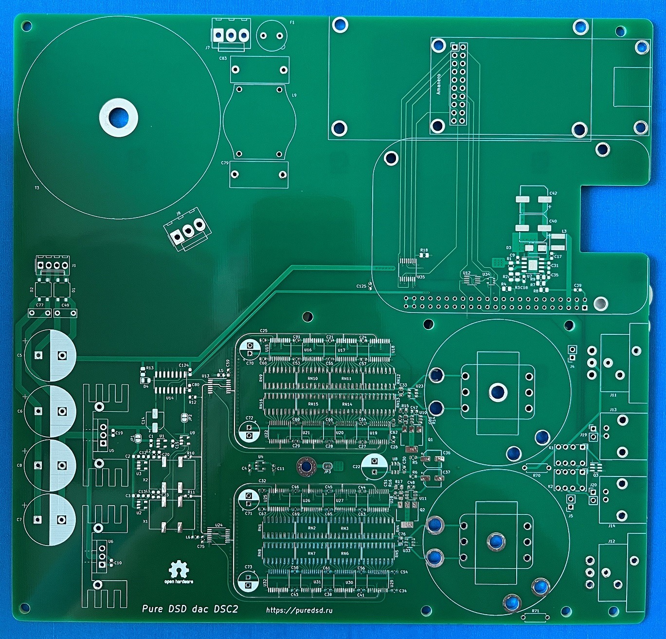

I decided to stop working on the DSC2 project.
The development of the latest version of DSC2 is completed. But not yet implemented as real PCBs. I hope someone can bring this version to its logical end.
I offer a complete set of project files in the KCad format - http://puredsd.ru/dsc2expra_rel.zip.
The project documentation and source code is published on an “as is”.
The project consists of two parts:
  1. main - main PCB DSC2 with transformer output and Open Hardware License. Interactive BOM for KiCAD
  2. output_nazar - active output PCB for replacing transformers. Circuit decisions are taken from open sources. But do not support Open Hardware License Interactive BOM for KiCAD
Thanks to Jussi, as the author and everyone who helped to develop this project.
