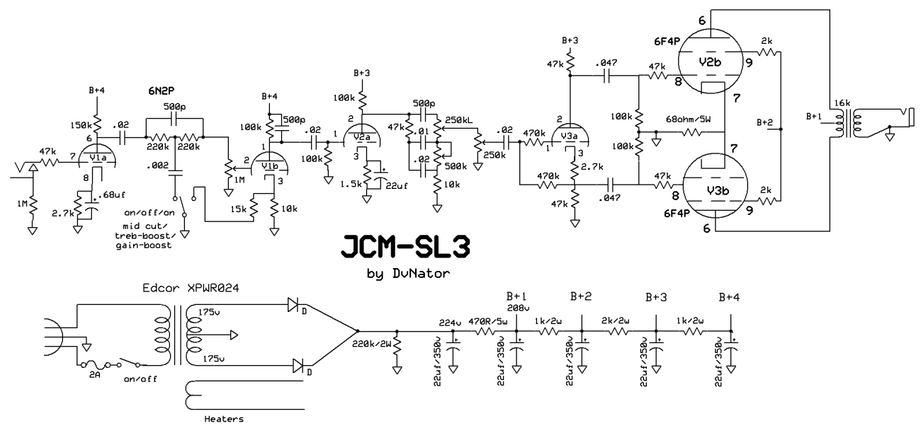

Ah. I missed that. Don't have much familiarity with European valve designations.The 6DX8 is basically the exact same valve as the ECL84/6F4P that I'm trying to use.
Only one way to find out if you're happy with it, particularly when it comes to "tone", aka, 2nd harmonic content. 🙂I was wondering if it (12AU7) would be an appropriate fit for V1.
But the very low rp (6k - 7k) of the 12AU7 might be a slight advantage here - it can very easily drive two paralleled pots (for your two channels) without any significant loading, because of the very low output resistance (compared to a 12AX7 triode, with 60k rp).
I have a similar low rp triode as V1 in my little DIY amp (it's half of a 6JW8 valve). It works okay, but the tone is very, very clean. Not a problem, I made sure that subsequent stages in the clean channel generated the tone I was looking for.
I was after the same thing, and I found that it took a lot more "uncleanness" to achieve this fattened-up tone at low volume.I don't want "so clean it sounds sterile" but I'm thinking of a mini Fender Twin sort of sound where it mostly only fattens up and sounds thick.
I think it has to do with the way the human ear responds to quiet sounds (Fletcher-Munson curves). We're less sensitive to treble at low volume, so we don't hear a tiny sprinkling of harmonic distortion in the mix. So the amp sounds sterile-clean unless there is a significant amount of harmonic distortion in the mix.
Because gain is cumulative as you go through the amp, normally the last stage is the first to distort, and the preceding stages are quite clean when this happens.I should have enough signal to get distortion at every stage.
This doesn't seem to produce very rich-sounding distortion, though, more of a Jimi Hendrix fuzz-box nastiness.
The way around this dilemma is to insert voltage dividers between stages. These will throw away some gain, but also allow preceding stages to distort to some degree without overdriving the heck out of the subsequent stage(s).
Leonidas Fender, the penny-pinching former accountant, would never have done this (gain costs money, so you can't throw it away, right?). But if you look at some newer and higher-gain valve guitar amp schematics, these interstage voltage dividers are very common.
The thing is, clean amps don't need FX loops! Because the (clean) preamp doesn't distort, the sound of FX pedals at the input will come through unscathed. So I kinda agree with AquaTarkus, the simplest place for FX pedals in a clean amp is at the input, and there is no real downside to having them there.fx-loop...put it in the clean amp...
Things are different with a "dirty" preamp. If you put FX pedals at the input, the sound of the pedals is distorted and modified (and maybe wiped out) by the preamp. So it's better to have an FX loop, to get the distorted signal from a "dirty" preamp to go through your FX pedals, rather than the other way around

The PTs arrived sooner than expected so I started assembling the cabinet. As you can see - there's a left and right set of controls. You can also see my little full-range speakers mounted. It's not lightweight at all - Im thinking around 20 lbs-ish? But it's not obnoxiously heavy either - considering how much stuff I'm going to be putting in it.

I think maybe I'm having some fairly significant lead dress problems. I can hear it well enough to say that all parts of the circuit are probably working, but I'm afraid that I've got way too much gain and way too much noise. It only sounds like a guitar amp at extremely attenuated signal levels.
I know you guys would probably be happy to offer some advice but I think I need to draw up my actual schematic first, and measure some voltages. I'm just happy to be this far along.
Agree, and congratulations on making the beast live!I think I need to draw up my actual schematic first, and measure some voltages. I'm just happy to be this far along.
Don't forget, you can lift one end of a coupling cap and remove preceding gain stages from the chain - then tweak what's left to sound good, before re-adding the preceding stage by putting the capacitor back.
Rinse and repeat, working from the output back towards the input. By the time you get back to the input, the whole amp should sound good, if everything went as planned.
Also, don't forget, you may need to attenuate the signal between stages to produce the tone you want, without having too much unwanted gain. You can temporarily insert pots between gain stages during testing. Once you find the right amount of attenuation, replace the pot with two fixed resistors.
In my limited experience, you are now at the most time-consuming part of the DIY valve guitar amp process: starting to tweak a design that makes noises, but doesn't sound good (yet)!
