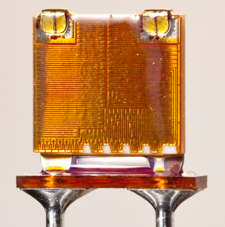

Also Z-foils datasheet somehow overlooks directionality. For some reason it emphasize how stable it is at any conditions. They also mention impedance ratio between 100MHz AC and DC of only 1.001 (source here) meaning that the Z-foil construction is non-inductive and non-capacitive among other properties. Also interesting to actually see the Z-foil resistor construction. Note trimming marks at the bottom.
