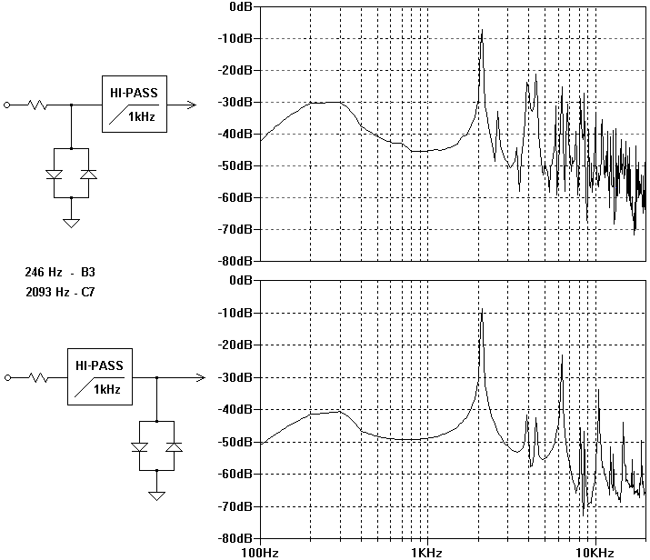

signal chain in guitar preamp, boost before eq or eq before boost
Here’s an example: A circuit consisting of a hi-pass filter @ 1kHz and a pair of clipping diodes. The input is a complex wave consisting of two sinusoidal waves. Frequency response of both circuits is identical, so is clipping threshold and clipping characteristics (pattern of harmonic distortion) with sinusoidal wave input. Only difference of the circuits is whether the hi-pass filter is located before or after the clipping diodes.
If the signal passes the circuit unclipped and undistorted you will not hear a difference in output signals of these two circuits. If clipped, they sound very different. This is explained by introduction of intermodulation distortion and by the fact that the post clipping hi-pass filter leaves higher magnitude for lower frequencies to contribute to intermodulation distortion.
Basically intermodulation distortion will add sum and difference frequencies of all fundamental frequencies – and their harmonics.
Look at FFT plots: In both cases fundamental and few of the following lower order harmonics of 246 Hz component are attenuated due to filter while fundamental of 2093 (and upper harmonics) Hz remains unattenuated. Everything else is by-product of both harmonic and intermodulation distortion. The striking difference is in the amount of those other harmonics created by the intermodulation process. You can see that the other plot with post clipping filter is rather “convoluted” due to that. The circuit that attenuates lower frequencies before clipping has strikingly lesser amounts of overall distortion.
Note: This was plotted with a “complex” wave that consisted only of two frequencies. When you pluck a single note a guitar signal probably introduces about 11 harmonic frequencies in addition to the fundamental so you can guess that in practice the IMD is much, much worse than it is already in this little example. The overall concept, however, should be pretty clear.

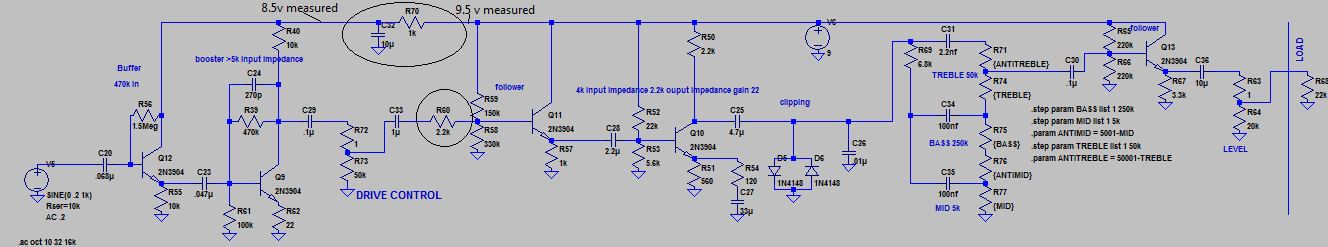

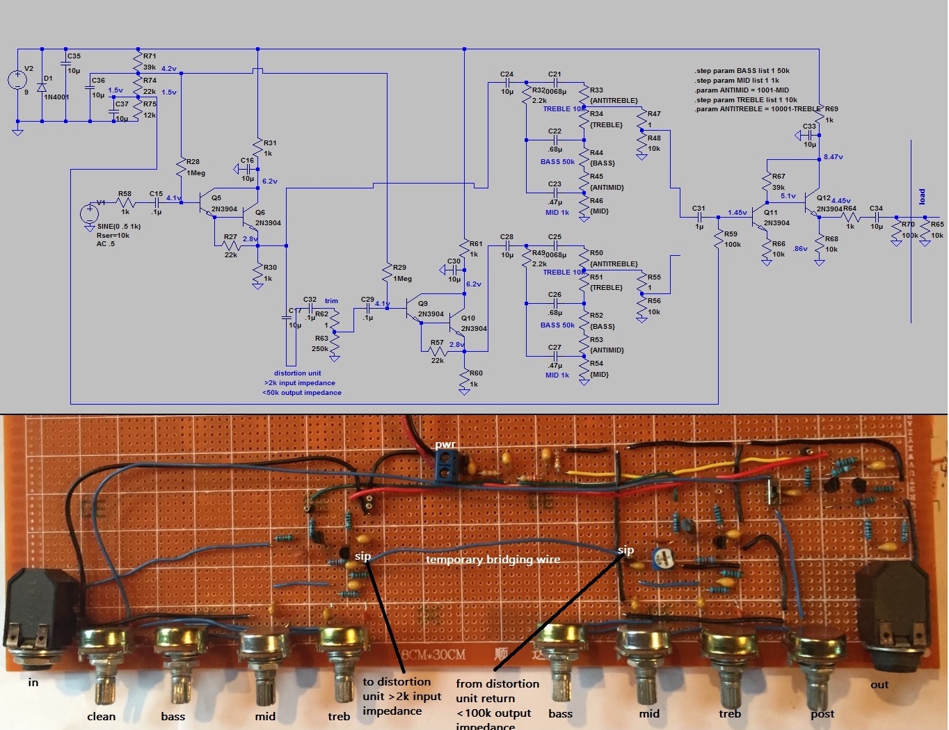

getting oscillations in distortion circuit
I was wondering if anyone had some insight or idea into why this circuit is oscillating. Anyhow this is a distortion circuit similar to a boss Ds-1 circuit, but a different input buffer, and instead of an op amp with gain 22, I used a follower into a simple class a transistor amplifier gain 22. Then there is a tone circuit.
Anyhow, if you turn the guitar volume to 1 out of 10 or lower, you get oscillation with the drive pot on the circuit turned all the way up at the very top of the pot rotation, in other words when there is not series resistance between stages. So I measured the resistance required to prevent oscillations and then multiplied by 3. That ended up being 2.2k so I inserted a series resistor 2.2k.
Also similarly when the drive volume all the way down, guitar at 1, same thing, oscillation. So I varied a resistor until the oscillation disappeared and multiplied by 3. That ended up being 270 ohms, so that is between the pot and ground.
Circuit seems to work fine like that. If anyone has insight into what is happening. I guess these resistances must be interrupting a positive feedback between the stages coming through somehow.
Should I introduce feedback somewhere in the circuit to stabilize it somehow? Do I need to "decouple" the stages in some way. Or should I just leave these resistors there and consider it "fixed"?

...you get oscillation with the drive pot on the circuit turned all the way up at the very top of the pot rotation, in other words when there is not series resistance between stages.
Common emitter stages can oscillate, but they usually aren't as touchy as common source (FET) or common cathode (valve) stages. Still, why not add a "base stopper" and see if that does the trick?
Also, this sort of thing (oscillations when a pot is turned either towards ground, or towards max gain) is often caused by layout, grounding, or power supply decoupling issues.
Are all those transistors running off the same B+ rail? If yes, that could be the problem; you might try inserting the same sort of RC power supply decoupling filter that you see in every valve guitar amp power supply schematic.
In similar vein, do you have any filter caps across the power supply, from +9V to ground? None are shown in the schematic. You almost certainly need both a big fat electrolytic cap (say 100 uF), and a parallel small ceramic or film cap (say 0.1 uF). The small cap in parallel is to take care of supply decoupling at high frequencies, where electrolytic caps don't work well (too much effective series resistance and inductance).
One more thought: do you, by any chance, have this assembled on a breadboard? The dozens of closely-spaced metal strips inside a breadboard can cause nightmarish problems with stray capacitance and unwanted coupling everywhere. Building a high-gain, multi-stage amplifier on a breadboard is often a frustrating exercise in futility.
That is one way to look at it, you may have positive feedback through the +9V supply rail due to excessive impedance at high frequencies (lack of bypass caps), or positive feedback through a bad ground layout, or positive feedback because the output signal is being coupled back to an earlier stage by stray capacitance.
Guitar cables and pickups can act as RF antennae, feeding RF and noise into the input of anything they are plugged into. That's why most guitar preamps have some sort of series input resistor right before the first active device. I don't see anything like that in your circuit, either.
If the problem is being caused by poor supply decoupling or layout, that is the thing to address first - tackle the cause of the problem, rather than try and cover it over with a Bandaid, you know.
Good luck!
-Gnobuddy

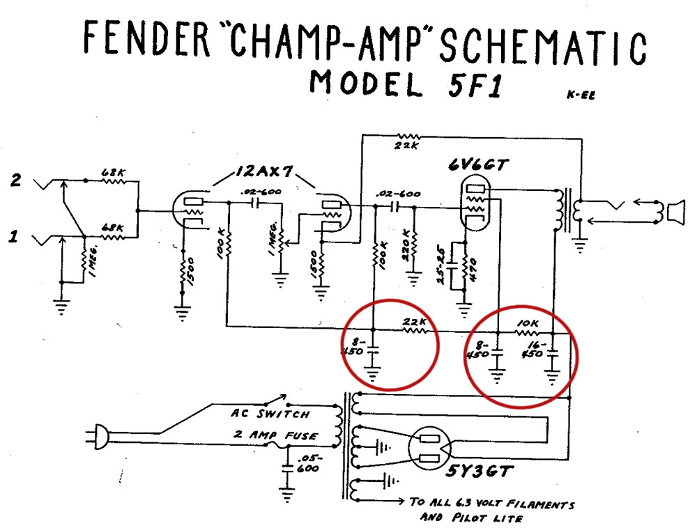

everything is hooked up to the same positive rail.
That's a big no-no, see attached schematic of an old Fender Champ. Leonidas was an accountant, so he would never spend a penny on an unnecessary part - even so, that champ has three filter caps, with two resistors separating them (inside the red circles).
What this does, basically, is create separate, clean, power for the output valve (6V6) anode, for the screen grid of that same 6V6, and for the preamp valve (12AX7). Those RC filters prevent noise and signals from one of those stages leaking back to other stages, causing oscillation and instability.
I have been studying basic circuits but still haven't put a lot of complicated circuits from simulation to breadboard.
Simulation is a wonderful tool, but the simulated world is often nicer and more polite than the real world. In the world of LTSpice, there is no such thing as a bad layout, there are no stray capacitances, there are no unwanted power supply rail impedance at high frequencies, et cetera. 🙂
I am not familiar with the "RC power supply decoupling filter that you see in every valve guitar amp power supply schematic."
See attached image. One rule of thumb is to never run more than two valve gain stages off the same B+ rail. With opamps, the rule is to have decoupling capacitors right next to the power supply pins for every single opamp. With transistors? They are usually less sensitive than opamps and valves (because of less gain and lower impedances respectively). But the "no more than two devices on the same B+" rule of thumb might be a good starting point, at least.
Are those the 100u electrolytic and .1 ceramic cap you were talking about?
Kinda - Leonidas' amp just uses a 16uF electrolytic cap as the first filter/decoupling cap, then two more 8uF electrolytics.
I don't know why he didn't use smaller ceramic or film caps in parallel, perhaps to save a few pennies, or because he found out he could get away with it?
The small caps are intended to take over at high frequencies, where the electrolytic caps stop behaving like capacitors, and start to behave like inductors. Those little small-signal transistors you're using are very fast, they work quite well at RF frequencies, so we have to make sure the power supply rails are well behaved even at frequencies up to several MHz. Otherwise your "audio" circuit can turn into an RF oscillator instead!

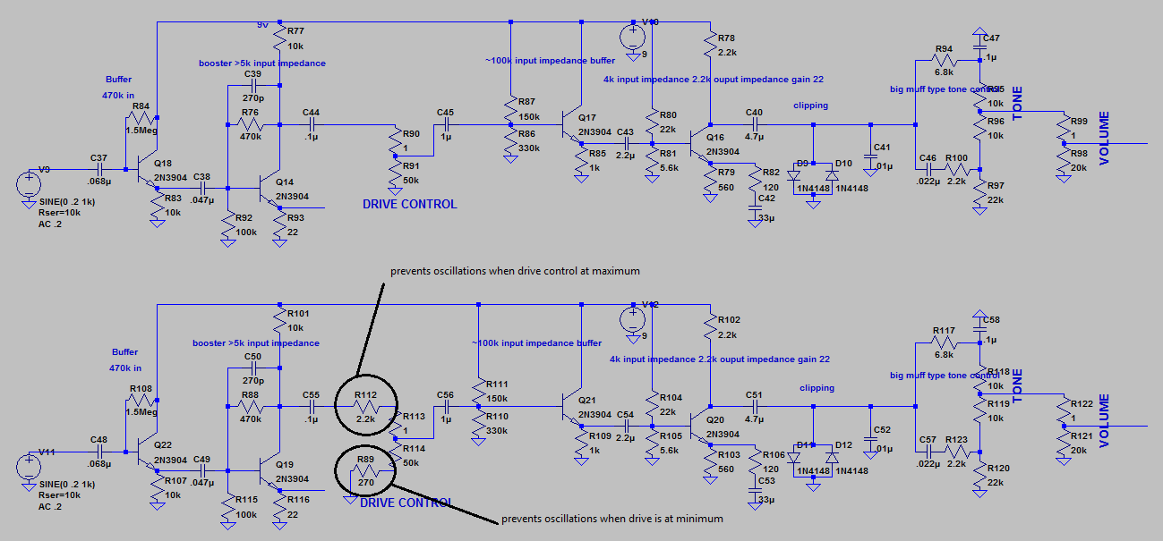

Made a few changes and no more oscillation
Thanks Gnobuddy for the review of the circuit. Very helpful and educational.
I made 2 changes that did the trick, first I added a 1k supply line resistor and 10uf ceramic capacitor to separate the first stage which has the highest gain from the rest of the circuit which has much less gain comparatively. This dropped the voltage from 9.5v measured to 8.5v measured across the series resistor. This fixed the problem except when the drive control was at 100%. The "base stopper" seemed to stop that problem. (I was guessing a "base stopper" was a resistor right before the base, I hadn't heard that term before.) I then added bypass caps positive/negative rails (not shown) which might have made it a little less noisy but not much change. Its still assembled on the experimenters solderless breadboard, so if it works there hopefully will work fine if I were to solder it. Oh and in the schematic I put a tonestack, volume and follower at the end of the circuit and ran it into a 22k input impedance power amp to 12" open back cabinet for listening. Thank you very much for the help. The other thing I was wondering about was about decoupling stages in the multistage design. It seems to me like you'd lose a little voltage everytime you add a supply line decoupling resistor (and cap) between stages.
Excellent, isn't it fun when theory and practice actually agree? 🙂
I was just being silly, I have never seen the term "base stopper" in any of the hundreds of books on solid-state electronics that I've read over the decades. Since "toobs" are popular here on diyAudio, I borrowed a term usually used in thermionic emission land. 🙂

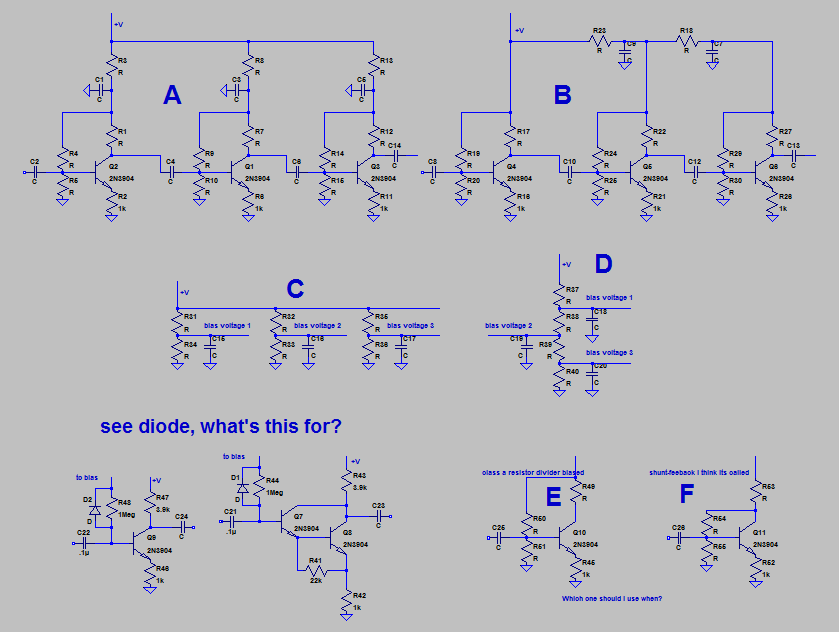

Here are some general questions about guitar preamp circuit designs. They probably belong after the long paragraph tirade below them but in case I have written to much here are some specific questions I have been pondering. (see attached image for questions 2-5)
1) ground lift - should I put on on the preamp, if so, at input, output or both. Can I just put a ground lift on all the time instead of a switch and just leave a fixed ground lift?
2) supply line decoupler - when using more than one decoupler, should they be in series along the supply rail or just above each stage in parrallel (see attached image)
3) When using resistor dividers to make bias voltages for stages, can you
string them all in series or should they be in parallel, or does it not matter. (see attached image)
4) I noticed a diode in opposite direction of biasing resistor on some schematics, is this some type of protection to transistor? I saw this when using darlington configuration. Maybe it has something to do with that. (see attached image)
5) shunt feedback vs. class A. I've seen both used. I have made circuits with both and am generally able to design the biases and gains, etc, (although input impedance of shunt feedback a little tricky) When I need a certain stage, I am not sure when to pick which type. Is one more stable or otherwise adventageous? (see attached image)
6) When the guitar is not plugged into the input on the amp, should the input be grounded with a switched jack for lower noise? Also I saw on an amplifier schematic I was studying a high and low gain input to presumable deal with very hot guitar pickups. Is there a very simple circuit for doing this. The one I looked at appears to just lower the input impedance at the amplifier, which I think could actually potentially change the signal substantially.

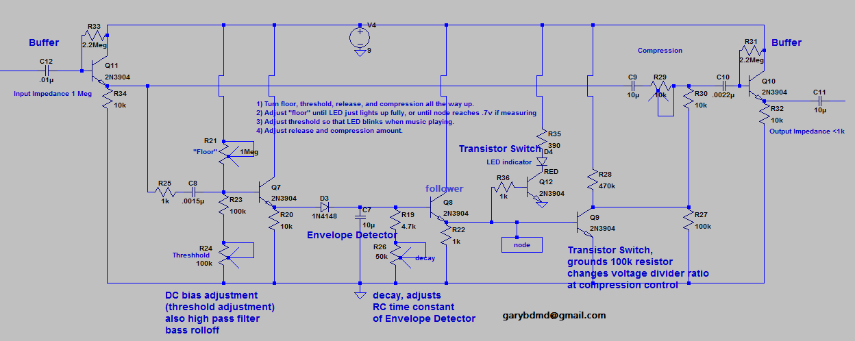

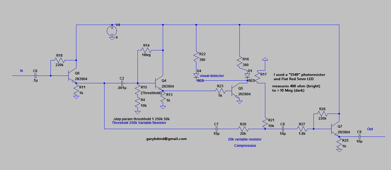

I used some of the concepts I've been learning in the attached circuit I made today. Basically I made a clean/distorted channel preamp, but left the distortion out, this way, I can insert whatever disortion circuit with gain control the preamp to test out different ideas.
It has a gain of about 3.0. 0.5 peak amplitude x3 = 1.5v amplitude ~1vrms. (The emitter voltage is set at .935 and collector is at 5.1v. The emitter waveform starts to hit the collector waveform when the signal is .85v or a bit lower.) So any signal above .85, in practice probably .8 (1.6v peak to peak) will clip. I may just employ a high and low gain input type schematic if I want to keep a 9 v supply.

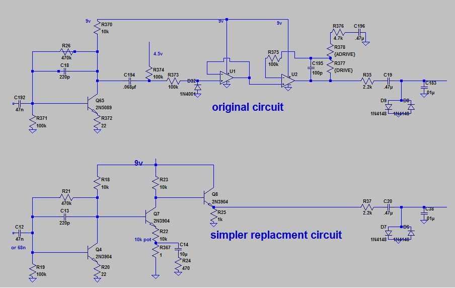

...discrete building for awhile for learning...then move on to op amp circuits.
That's certainly the original historical progression - people had to figure out how to work with these newfangled transistor thingies, which were very different from vacuum tubes, and develop new circuit topologies that played to their strengths.
But, with all the hard design work now decades behind us, I'm not convinced that the best path for a newcomer to electronics is to retrace history. From the users point of view, op amp circuits are simpler. All the hard stuff is hidden inside the chip, but the whole chip is really easy to use - sort of like a super-transistor, with vast amounts of clean gain, simple biasing requirements, and extremely precise behaviour controlled by a resistor or two.
Is there value in learning the details of how things work inside the opamp? Yes, certainly, but it's not necessary in order to use opamps in simple circuits. As a crude analogy, most people who drive cars today don't have a clue what an oxygen sensor is, or what role it plays in keeping the engine running properly.
I hate "black boxes" myself, and would prefer to understand every little detail, but the world has gotten complex to the point where I have been forced to the realization that this isn't possible any more. Much of the workings of the PC I'm typing this at is a mystery to me...
If we're talking about mains-powered circuitry, the combination of the phrases "ground lift" and "guitar amplifier" make me very nervous. When you play guitar, your fingers are in intimate contact with the guitar strings, which in turn are grounded through the guitar cable to the guitar amp.
So if the amp chassis is not solidly grounded, the guitarist is in peril - any voltage on the chassis will flow through the guitarist to ground. And he/she might not even be able to let go, because electric shock causes the muscles to contract, and it is quite likely the fretting hand will clamp onto the guitar strings with a death-grip. The word "death" might well become literal, here. 😱
So, my suggestion is no ground lift, ever, in any kind of guitar amp. We want that amp chassis solidly grounded any time the amp is plugged in.
2) supply line decoupler - when using more than one decoupler, should they be in series along the supply rail or just above each stage in parallel (see attached image)
Series implies lots more filtering - each successive stage in the chain removes more ripple, so the DC is very clean when it gets to the most sensitive (input) stages of the amp. But series resistors involve more DC voltage drop along the way.
In the era of vintage valve amps, when electrolytic caps were expensive and limited in capacity, and there was plenty of B+ voltage, series filtering was an obvious choice.
3) When using resistor dividers to make bias voltages for stages, can you string them all in series or should they be in parallel, or does it not matter. (see attached image)
I'm not sure I understand the scenario you have in mind. But if it works, doesn't make nasty noises, and is stable, it's a good design!
Looks to me like the diode is designed to keep the transistor base from going more than 0.6V more positive than the positive rail. This might protect the collector-base junction from going into forward bias and potentially being destroyed.
These are completely unrelated concepts. If only one transistor is amplifying both positive and negative halves of the audio signal, it has to be class A. Oversimplifying slightly, every preamp circuit you've shown is class A, and you have no choice in the matter.
Note that a class A circuit may have no feedback, it might have series feedback, or it might have shunt feedback. The same goes for class B, class AB, and class C. Once again, there is no connection at all between "class A", and "shunt feedback" or "series feedback". They are entirely independent concepts.
Is one more stable or otherwise advantageous?
I think you're asking about the two biasing schemes in diagrams E and F, right?
If I understood you correctly, the answer is to be found in the family traits of transistors. One trait is that transistors have very wide spreads in current gain - the same part number may have a current gain of 250, or 900, or anywhere in between, and you won't know unless you measure it.
Another trait is that the voltage drop from base to emitter, with the transistor operating normally, is almost guaranteed to be somewhere between 0.6 volts and 0.7 volts. It varies slightly from one transistor to another, and also varies slightly with collector current, but will still usually be in that small range between 0.6 V and 0.7 V or so. Unfortunately, though, for any given transistor, changing that base voltage by a very tiny amount causes huge changes in collector current - in fact, an 18 mV change will double the collector current!
So, if you're an electronics engineer circa 1950, trying to figure out how to bias these new transistor contraptions, what do you do? You can't bias by setting the base current - the wide spread in current gain will cause huge variations in collector current. And you can't do it by setting the base-emitter voltage, either - there's no way you can set it accurately enough to get the collector current you want.
Some clever person figured out a third option. You set the base voltage (not base-emitter voltage, just base voltage with respect to ground). You let the emitter settle where it wants, within roughly 0.6V - 0.7V of that base voltage. And then you connect a resistor from emitter to ground, and Ohm's Law will set the emitter current for you. Done!
What I have just described is your circuit "E". For the NPN transistors you show, the base voltage will ideally be sufficiently positive so that normal variations in VBE (0.6 - 0.7V) cause very small changes in the emitter current. I would suggest the base be at least at +2.7 volts with respect to ground. The emitter will then be at about +2 volts. The emitter resistor will set the emitter current.
This works very well when you have sufficiently high supply voltage. But note that we've lost 2 volts DC at the emitter, so with your low 9V supply, there are now only 7 volts remaining for the collector. The transistor should have at least 1V DC across it at all times to operate properly, so that leaves you only 6V peak-to-peak signal at the collector. That's only about 2 volts RMS. Anything bigger, and you hit clipping!
Also, circuit "E" uses a lot of components. Four resistors and three capacitors per transistor (input cap, emitter bypass cap, coupling cap from collector to next stage.)
Your circuit "F" is a later evolution of "E". If the current through the transistor increases for any reason (including higher than expected current gain, or lower than expected emitter-base voltage), there is some feedback that attempts to correct the error.
I'm not very fond of "F", myself. The feedback lowers the (already low) input impedance. Circuit "E", if properly designed, already works well. And finally, the future of transistor amplifier design went in an entirely different direction - both "E" and "F" became obsolete.
The new direction was DC coupling first two, then gradually more, transistors, until eventually a fully DC-coupled transistor amplifier emerged from the process. The next step was to put that on an integrated circuit, and the modern solid-state opamp was born.

In summary there is an "overdrive" leading into soft clipping circuit, into a bridge t, then a hard clip of peaks, then more tone stack filtering. I am extremely pleased with the sound. To me it sounds better than any solid state amp I have owned, but of course I built it to sound what I thought was ideal, and that can be different for different people.
If anyone wants the schematic posted I would be happy to post.
Originally I thought maybe the boss ds-1 type circuit might work out ok but this blows that away.
Regarding the boss Ds-1, I did find a nice and easy way to replace the op amp with fewer parts (2 transistors) and sounds just fine. I'm including it in the post for completeness in case anyone happens on this thread interested in building an all transistor Boss Ds-1 distortion. Fewer parts simpler, etc. The whole circuit is not shown just the op amp replacement.

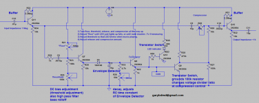

One other circuit I came up with is a relatively simple compressor. I'm also very happy with how this works. This is for the clean channel of the preamp. It has 2 controls, threshold and compression, and uses a 5mm flat red led contacting a photoresistor (I used '5549' photoresistor). I put them next to each other and used a lighter and heat shrink tubing, no glue. The heat shrink tubing molded easily around everything was really simple to do. (Mash the heat sink tubing around the legs while its hot also, may need gloves or a moist paper towel) It has an indicator LED so you can see when the signal is going above threshold. The LED comes on simultaneously with the vactrol. Very rudimentary but seems to work fine. In the circuit it looks like I'm rolling off a lot of bass on the LED driver and I am. I had to roll off a lot more than I thought I would have to. The LED still comes on with all strings including the low E. Rolling of the bass stuff really helped with artifact and distortion I believe because the wavelength/period is too long for low notes. The circuit shown has 4 transistors, but I will only need to add 3 transistors to the clean channel of my preamp to put the compressor in, so its an easy add on to what I've already built.
I am working on another simple compressor that uses a few transistors and no vactrol, but I'm not sure how it will end up sounding. Its going to kick on and off differently and a lot "harder" compression, so I'm not sure what result I will get. I'm going to use an envelope follower to a transistor switch that pushes a resistor to ground and changes gain of the signal. It'll be interesting to see what it sounds like.

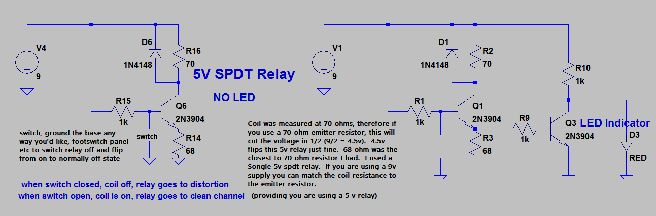

Also if anyone reading this thread is interested, I've shown the relay circuit I'm using for channel switching. I tried several different circuits this one worked the best. I made the circuit so that any way you choose to ground the base of the transistor relay driver, that will shut off the relay. So I have a switch on the panel of the preamp and a footswitch which goes to ground. The coil has current going through it while the clean channel is on, and no current in coil while on distorted channel. The high gain/distorted channel was picking this up the coil, so I found it better to leave on during clean channel state. I also added an LED indicator, which added just the slightest amount of noise while the distortion was on. When I say noise I'm talking about all gains set to maximum, it was not as noisy as a typical distortion pedal or the peavey amp I have. Definitely was usable. I didn't scrap it because of noise, I really scrapped the LED indicator on my preamp because i didn't care to have it.
Here's my try at a simple transistor guitar compressor with no vactrol
Here's my try at a simple compressor. Basically I got the idea that I would change the resistance ratio of a voltage divider to change the gain using a transistor as a switch, forcing a resistor to ground when the transistor comes on. Basically the threshold is changed by changing the biasing resistors of an emitter follower. This leads into an envelope follower (diode detector), with variable time constant or attack/decay. When the envelope detector gets above .7v about, the transistor switches on and pushes the resistor to ground lowering the gain. The compression amount can be adjusted by varying the top resistor in the voltage divider. I played my guitar through it and it seems to work. To set up the threshold, you set all pots all the way up and then adjust the resistor (labelled floor) down until the indicator led comes on fully around .7 volts where the transistors switch on/off (labelled node). Then turn the threshold down so the led is peaking. You'll hear the gain change pretty obvious. Then lower the decay to acceptable level by lowering the RC resistor in the envelope detector. Then you can lower the compression amount. I'm not actually sure if this qualifies as a compressor in the sense that once threshold is reached the whole signal drops, but you can for highly dynamic guitar peaks I think it seemed to work. I would like to try it out on a mix and see what it sounds like.
Thanks for looking and please any suggestions appreciated. It would be nice if anyone knows any simple improvements on an envelope detector, this detector is about as rudimentary as it gets.
