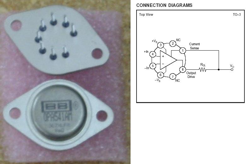

Is this something like what your looking for?
OPA541AM High Powered BurrBrown Opamp in 8 pin T-03
The only problem I can think is how Im gonna sink these suckers....dont want to drill 8 little holes in a heatsink
I got these as samples from TI, but I work at TI so I don't know if outsiders are limited to the 11 pin plastic package.
Also one cool thing about the 541AM is that the case is isolated from the actual circuitry, so it doesn't need any seperator sheet on the heatsink 🙂

Ok I see that these suckers are $100 a pop at Digikey...so chances are smaples are gonna be slim 🙁

i have got at least 9 of these from TI in sample form. i see that they have been removed from the sample program now though. 🙁

Hmm...ya sorry, it still shows them available for me.
