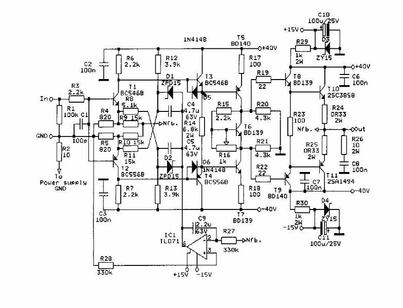

For Esperado I attach another such design dating from the 80s showing the concept form a french designer I believe but Im not sure.

This amplifier is one of my early design. Today I would do it a bit different way, and some compensation would be necessary, to avoid oscillation.

Nice DC servo circuit.
Yes but the drawing is bad, because this solution needs non inverting servo.
