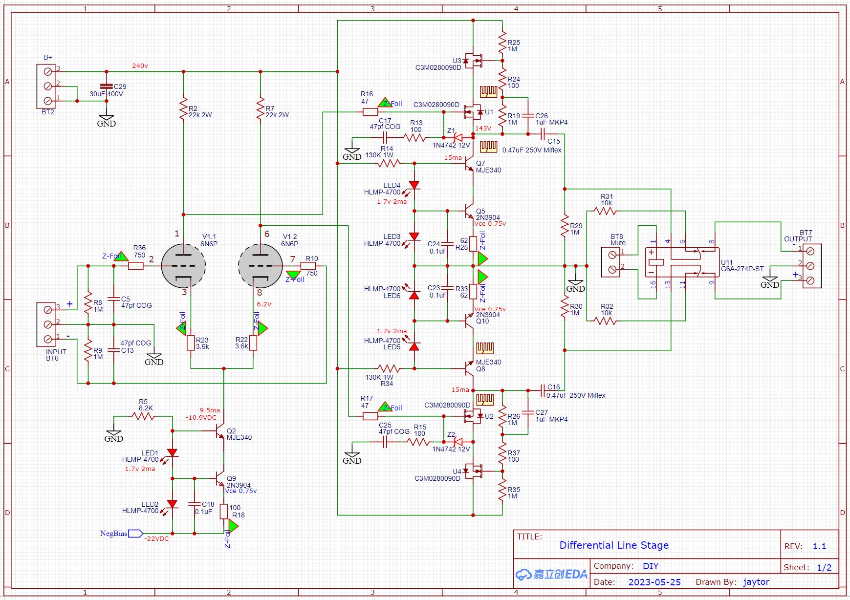

I'm working on a hybrid line stage with a tube voltage amplifier (6N6P in LTP) feeding a source follower output stage. The source follower will be cascoded and use a CCS load, with a B+ of around 250V.
Besides the higher cost, what are the pros and cons of using a SiC Mosfet for the source follower (and cascode)?

Thanks for the responses. I was (am) considering a SiC MOSFET only because I saw a couple of posts (can't find them now) that mentioned that the author preferred the sound compared to other power MOSFETs.
The parts are not going to be under a lot of stress, with about 50V and 15ma across them (once the tube is warmed up) and they are on a decent heatsink (each SF mosfet plus cascode shares a 7C/W HS), so I'm not too worried about thermal performance.
The SiC MOSFETs seem to have low capacitance and high bandwidth, but this doesn't necessary make them good for this application. The SiC MOSFET I was considering is the Wolfspeed C3M0280090D. Other non-SiC parts I was looking at are STP3NK60ZFP and IRFBC20PBF.
I've attached my current schematic. I have already finished the PCB layout (has not been sent to fab), so don't really want to change too much unless there is good reason to do so.

Spirito instability means that even when you have a circuit that fixes the total drain current and you have adequate cooling of the whole power MOSFET, you can still get damage. Due to random variations, there is always some part of the MOSFET slightly hotter than the rest. This causes the threshold voltage of that part to decrease and the current through it to increase, which causes a further temperature increase. If this temperature increase exceeds the original temperature difference, you have positive feedback with a loop gain greater than one, and get thermal runaway; in the end, an excessively large part of the total drain current (which is supposed to be fixed by the external circuit) will flow through the hot spot and will possibly melt things. If the temperature increase is smaller than the original temperature difference, you have positive feedback with a loop gain smaller than one and everything will work fine.
You can recognize Spirito instability in the datasheet SOAR graphs as parts where the allowed current drops faster than inversely proportionally with the drain-source voltage. That's assuming the manufacturer actually characterized it properly, which is apparently not always the case.
Figure 22 of the Wolfspeed datasheet shows no sign of Spirito instability, but nothing is guaranteed beyond 100 ms. It will hopefully work fine because you stay very far below the various ratings.

@MarcelvdG - Thanks for the info regarding the Spirito thermal effects. I wasn't aware of this and will make sure I pay more attention when operating MOSFETs in the linear domain.
I've decided that I'm going to use the IRFBC20PBF to start with. This is a relatively inexpensive part with good specs for my operating points and also has decently low thermal impedance from junction to case so I think I will be well within the safe operating area.
After doing some more research on 6N6P operating points, I've decided to increase the LTP CCS current to ~22mA which necessitated a few other component changes.
Once I get this circuit built and tested, I'll post the final schematics.
