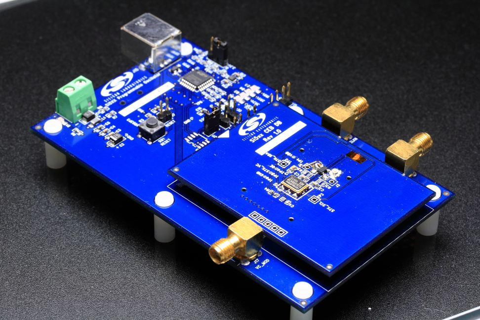

Si570 based 2ps RMS low jitter universal audio clock project
