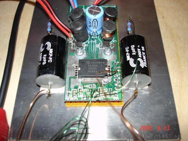

A paralleling input cap upgrade question
Hi, Im currently running 2 stock SI's bi-wired in parallel to some Wharfedale diamond 9.6's they are 90db sensitivity, and sound pretty amazing, easily blowing away my crappy all in wonder mini systems, except for the obviously lacking bass at higher volumes.
I plan on modding my two T-amps and putting them into one box with a single stereo pot (alps blue?) and all 8 outputs.
I also wanted to upgrade the input caps C3/C4 to improve the bass. My question is, does this need to be done on both amps. because one will drive low frequency and one highs (no active pre here) would there be sonic benefits to keeping small cap size for the dedicated higher range amp?
Besides RCA ins and upgraded binding posts this will be the only major update on the board itself i plan for these amps. I have 2 more waiting as backups/further mods in the future.
In regards to the capacitors to be used, i am a bit of a novice, and would appreciate if someone could tell me which will be the easiest for upgrading C3/C4 and a part number, i would really appreciate it, I have read the posts on this subject, but can't determine which is best for me.
FYI I have some 10uf 16V caps on hand but don't know if this would be too big. And I will be powering via an 12V SLA Coleman powermate jumpstarter with two car lighter outlets that I have adapters for plugging the SI into. (Its what I have on hand)
Thanks for the help, any and all input is appreciated, especially a few pics of the upgrade to C3/C4! That could change my life.
W
I think the easiest method is to use poly caps and mount them off the board - unless you don't have enough room in your enclosure. Also, it's a little easier to solder this than SMD parts. I followed the mod from panomaniacs website. I used 2uF Solens that I had lying around. It sounds good to me.
