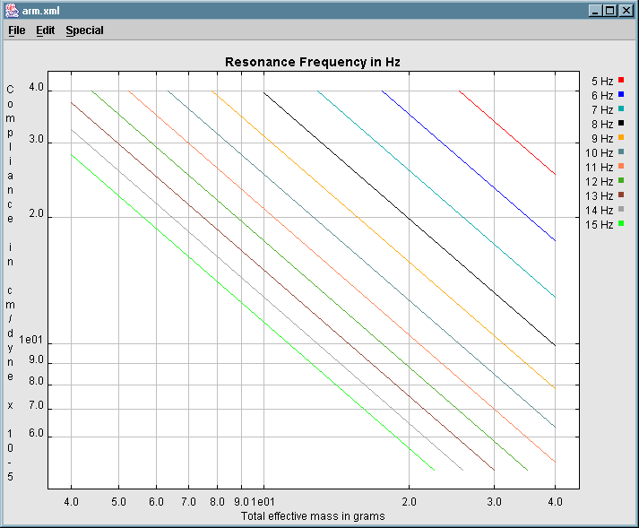

8 x 10^-6 cm/dyne sounds likely, making it a low compliance cartridge, best suited to higher mass arms. 32g total mass would give the optimum 10Hz, so if the cartridge weighs 6g, plus 2g for mounting hardware, an arm with an effective mass of 24g would be ideal.

EC8010 said:8 x 10^-6 cm/dyne sounds likely, making it a low compliance cartridge, best suited to higher mass arms. 32g total mass would give the optimum 10Hz, so if the cartridge weighs 6g, plus 2g for mounting hardware, an arm with an effective mass of 24g would be ideal.
Whilst I agree a 9Hz to 10Hz target is admirable for a high
compliance cartridge I'd suggest for a low compliance cartridge
11 to 13Hz is more sensible, giving a range of 18g to 27g total.
Any arm effective mass between 10g and 30g would work well,
but around 20g effective mass is ideal.
sreten.
