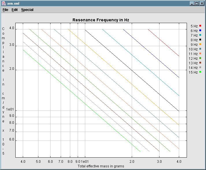

I think you need the advise of an arm/cartridge expert here. I suspect that the Rek tonearm is high mass. You'll need a cartridge to suit.
If the arm is an ancient design a high quality cartridge is pointless.
The Grado's (all 20 cu) suit medium mass arms around 10g
effective mass. 20 cu seems to be settled on as a standard
compliance for modern cartridges. (15g total mass gives 10Hz)
Effective mass higher than this is now the province of the DJ
world - because cartridges designed for high mass arms, > 15g
effective mass, total mass > 20g, work extremely well in medium
mass arms for DJ'ing type shenanigans, e.g. back cueing.
Grado don't even publish the compliance unit values of their
DJ cartridges.
High mass arms need 5cu to 10cu and this covers all the range
of Ortofons "Disco" cartridges which cover 6 cu to 9cu.
the graph shows 6cu to 40cu and 4g to 40g mass, note total mass
= arm effective mass + mass of the cartridge. Target is near 10Hz.
Also note that for a 5g cartridge mass an arm effective mass <
5g is essentially pointless and will severely compromises rigidity.
🙂 sreten.
