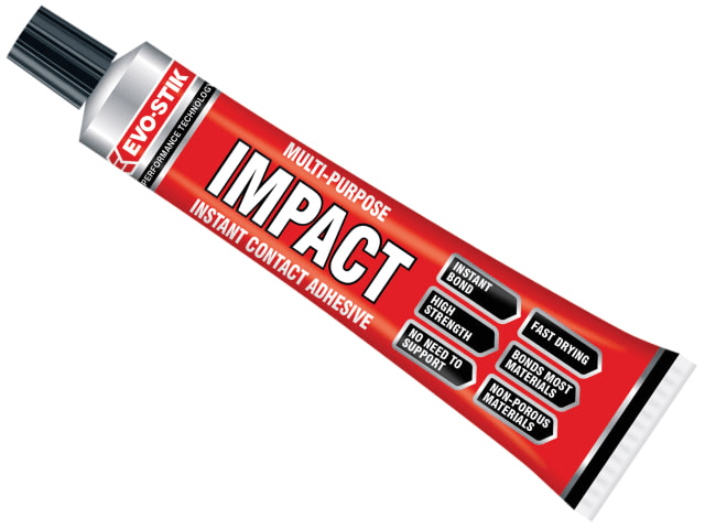

There may be a case for leaving the surfaces as they are as they should 'key' together.
I would use contact adhesive to rebond the surfaces - a thin layer on each surface - allow time to become tacky - then press tightly together.

Ah, that makes sense. I am in the USA, please advise if there is any particular brand of product that is best recommended for this application. Otherwise will make a trip out to hardware store and see what they might have in the way of silicone rubber cement or contact adhesive.
