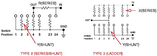

Calculating the values for stepped attenuators
hi
i would highly recommend a DIY stepped attenuator (for example using a 20-position 2 or 4 pole switch). i have attached below simple qbasic code to calculate the resistance values for the three canonical types of attenuators:
TYPE 1: POTENTIOMETER REPLACEMENT
(worst of the 3 types, because there are the most number of solder joints and resistors in the signal path)
A=0

TYPE 2: SERIES-SHUNT type, a good approximation to type 3, since it only has 2 resistors in the signal path. However, the input resistance is not constant, so the source must be current-capable.

TYPE 3: TRUE LADDER. BEST of the 3, each position involves two separate resistors. requires a 6 pole switch for stereo, and a lot of well matched resistors and soldering!

i recently built a stereo attenuator of type 2 using an excellent JBT 19 position 2 pole switch from leeds electronics (www.leedselect.com, surplus switch for $5), with very satisfactory results. I really would not recommend type 1, since you still end up needing a 2 pole switch, and the number of resistors/solder joints in the signal path adds up fast!
hope this helps!
-p
(ps: note on the "Load resistance" above: it is important to use the actual input resistance of your following stage here: for SS gear, this would be the input impedance of the amplifier, for tube gear, i use the grid leak resistor attached to the input(driver) tube. Many potentiometer-type attenuators rely on the shunt-to-ground resistance of the potentiometer itself, which doesn't make sense to me!)

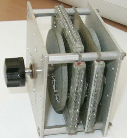

That's true, 4-gang switches are not in his catalog. I know Sonic Frontiers used 4-gang switches from Electroswitch. They were wired as series attenuators. I got 3 of them, 50K ohm ea. If anyone is interested I might sell them. The Elma is the one in front, it's 2 deck. I used it recently in my Dac and it's not too bad. All of them are 24 positions.

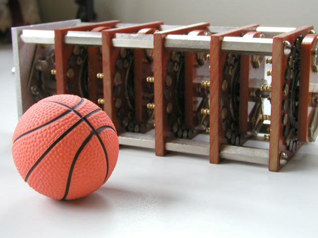

Currently I am using the 47 position Shallco for volume attenuation as a shunt regulator. I have a extremely bad experience with Elma switches I used for balance, inputselector and volume. The contacts were heavily scratched in. Do you believe a contact resistance of 40 Ohm? The contacts were so bad I got a DISTORTED square wave on my scope from the preamp. The Elma was also making annoying clicking sounds when adjusting the volume.
For selector and balance, a la Mark Levinson JC-2, I am currently using Electroswitch without any problem.
For the volume I am using a 10k Vishay bulk foil resistor as the series element and I calculated 1.5 dB steps with aid of a calculator. Except for the loudest settings I never use; this would be 130dB+ sound pressure level on my Klipschorns!; the input resistance is fairly constant 10k as the shunt resistors are small values of a few Ohm (lowest settng) to 100 Ohm (higher setting). This makes life a lot more easy as I did not like the idea of a four layer switch.
The Shallco was a bit difficult to turn when new but I lubruficated the mechanisme with Molykote and it is much better now. But you need a large knob for the higher torgue needed by this switch.🙂
I have been using the Electoswitch and the Shallco now for over a year and have not encountered any problem (yet).🙂 🙂
I got the Electroswitches from www.alliedelec.com US$44 shipping cost and the Shallco from Michael Percy US$ 10 shipping cost.😉
ELso:
There are at least two types of Elma switches. The standard grade exhibits slight contact bounce and the BV switch which was specifically design for attenuator applications and has no contact bounce: it utilizes PC boards with special trace material for the contacts. So far I didn't experience problem with it and I really like the compact size. I'm using my attenuator at the output with 50 ohm series Holco resistor and shunt resistors in the range from 0.5 - 500 ohm. It's only 24 positions but I absolutely don't need more. Also that setup produces pretty low output impedance.
