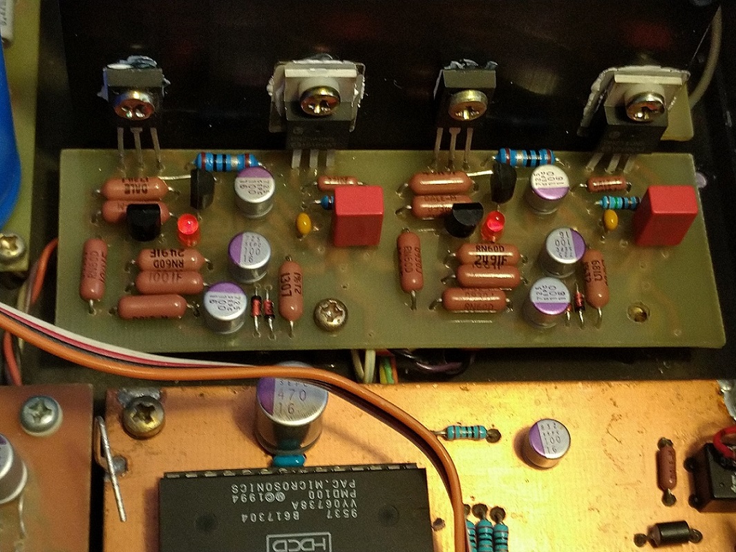

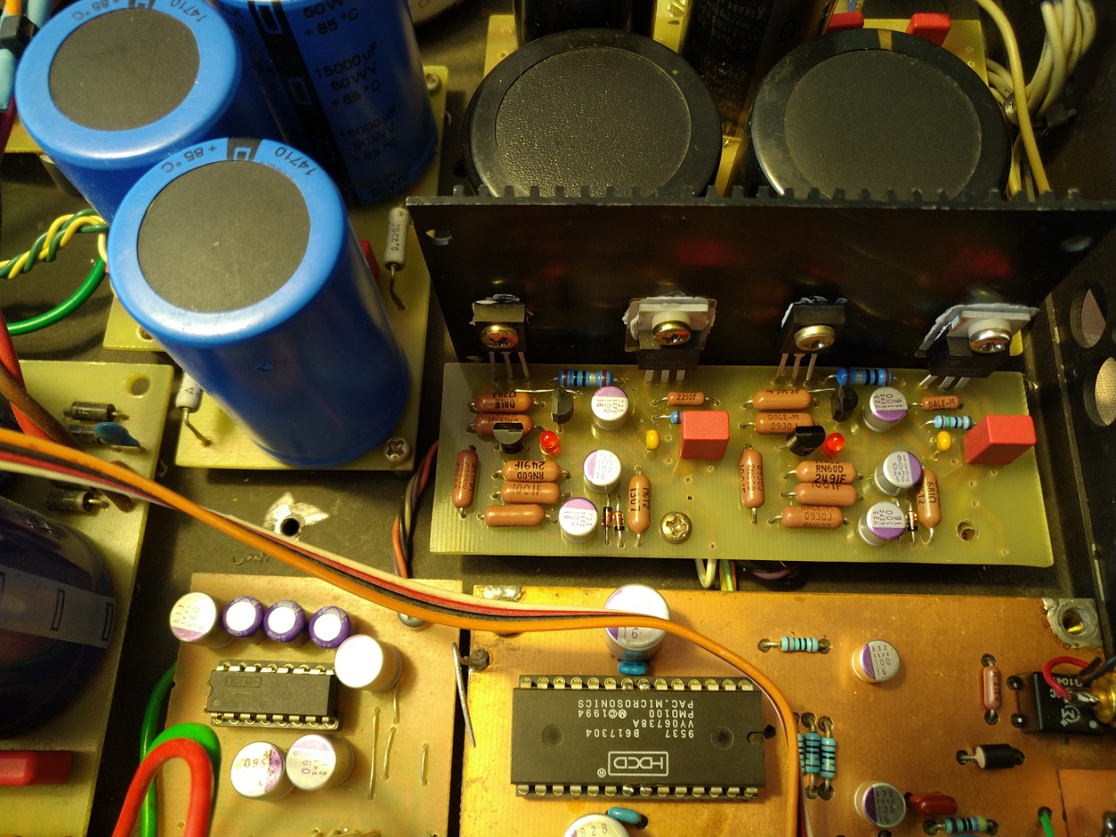

Shunt-type regulator from Mr. Walt Jung

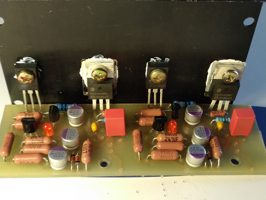

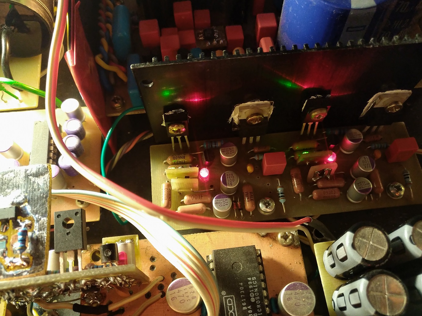

These days I made a Mr.Walt Jung shunt reg, which I installed in my DAC for power supply for PCM1702. The circuit is from the WaltJung.org web site.Directory listing
For floating power supply from article I need to modify the existing power supply in the DAC so I modified the negative regulator as Improved PN Regs, inserted the NPN and turned the polarity of the diodes and references. For 5V as a reference I used the LM4040. The transistors are TTC004B / KSC1845 for N reg., TTA004B / KSA992 for P reg. and op.amp is AD825 for both. As I have excellent experiences with Walt's regulators for analog circuits, I was interested in how this regulator will behave for digital circuits.
The oscilloscope shows the difference between the old reg and this in noise reduction. There has also been a change of sound, the sound image is much more open with plenty of details and dynamics.
A really good regulator.

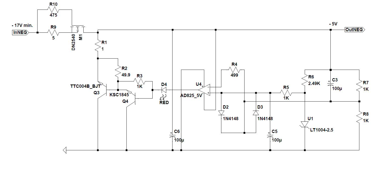

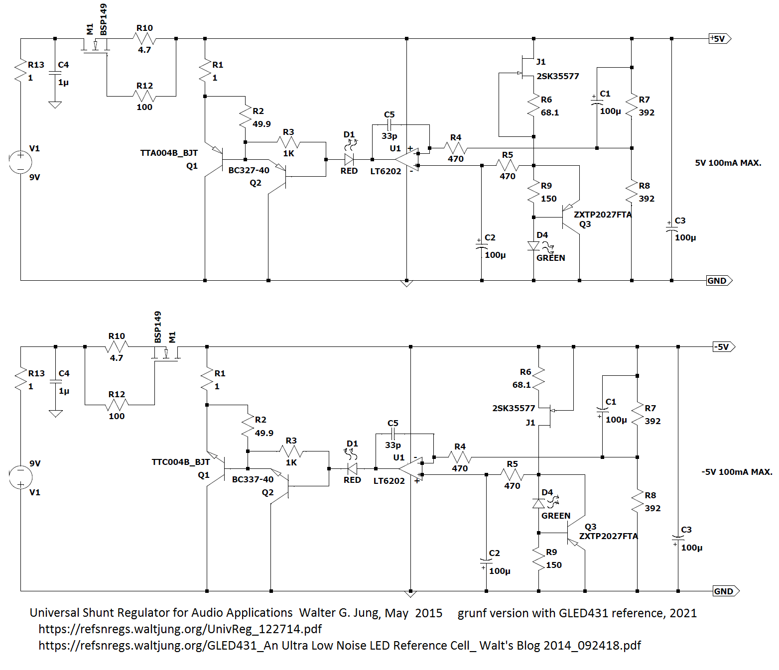

It kinda worries me that a very large output disturbance (on the OutNEG node) can change the VREF.
Suppose OutNEG steps-down by more than the forward voltage of diode D2. Then D2 becomes forward biased, and D2 pulls down VREF, discharging C5. Now the regulator is regulating to the wrong voltage! Oh No!
I guess the answer is, don't ask this regulator to regulate against large output disturbances. Another approach might be to modify the connections to R4.
Mark, I don't think it is a problem as such, assuming that the large Vout disturbance only happens at overload where the reg drops out of regulation. In that case, it actually can be viewed as a sort of safety feature.

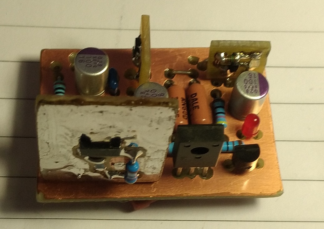

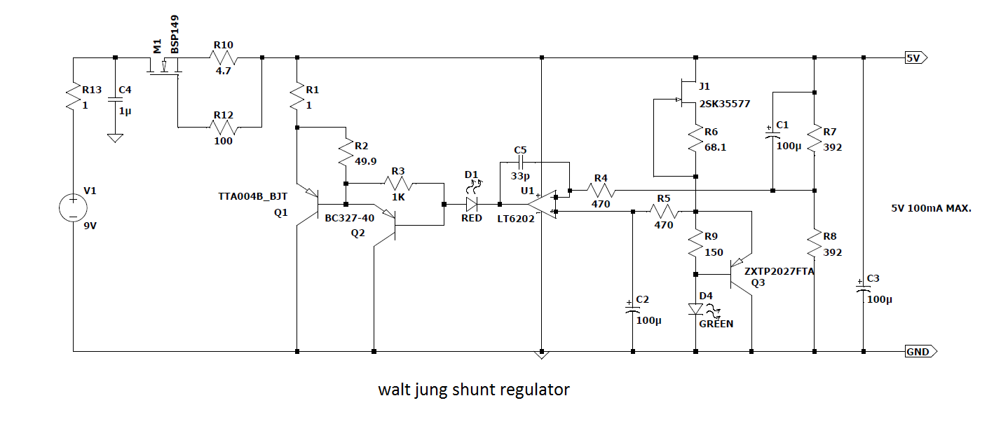

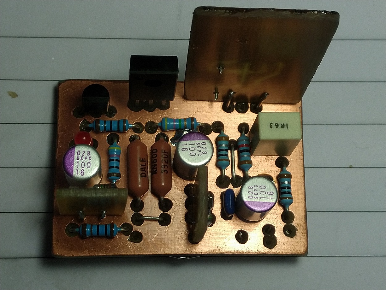

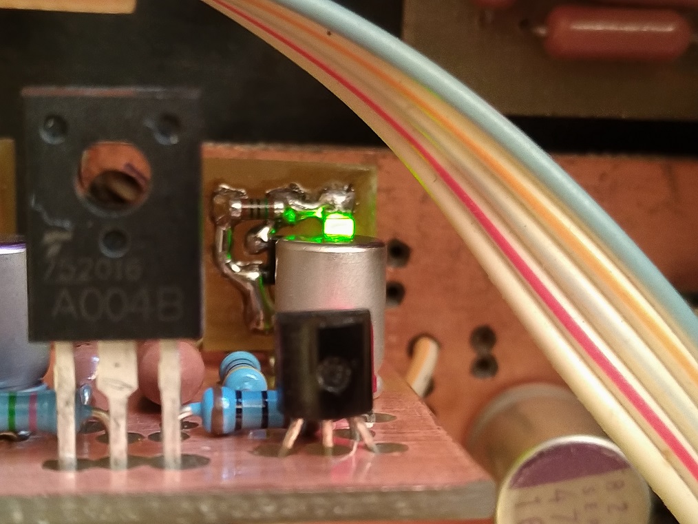

A couple of days ago I successfully tested the LT6202 instead of the cheap AD8091 which was also tested as a cheap op.amp option.
I also inserted an SMD version of the GLED431 reference with ZXTP2027F instead of ZTX951, the reference is powered by CCS with 2SK3557 with 6mA current.
I also replaced the DN2540 with a BSP149 so there can now be a smaller voltage drop across the regulator, for 5V at the output 8V at the input is enough. The current across the BSP149 is around 130mA.

I can say that this is the best regulator I have made so far, and I made almost all of them posted on this forum, it was tested only in the digital power supply in my DAC and it turned out much better than the excellent ADM7150, it will soon have a chance to show and how it works in the analog power supply in I / V conversion for the my new DAC with SAA3570+TDA1547.

Here are both versions, positive and negative for +/- 5V.
The idea with a better op.amp with less noise and better reference is from Mr. Walt Jung GLED431 article, I only added CCS for GLED and BSP149 instead of DN2540.
