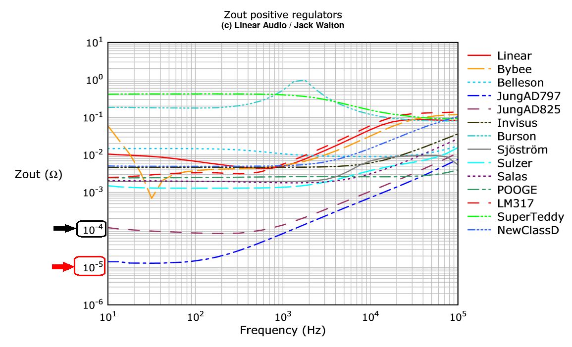

An ambitious design no doubt. But I would lik to see straight lines up to 100khz or at least to 50k. Impedance, phase, noise... the works.
Why?

Why not? Why have a variation within the audible range? Just that. Full in.

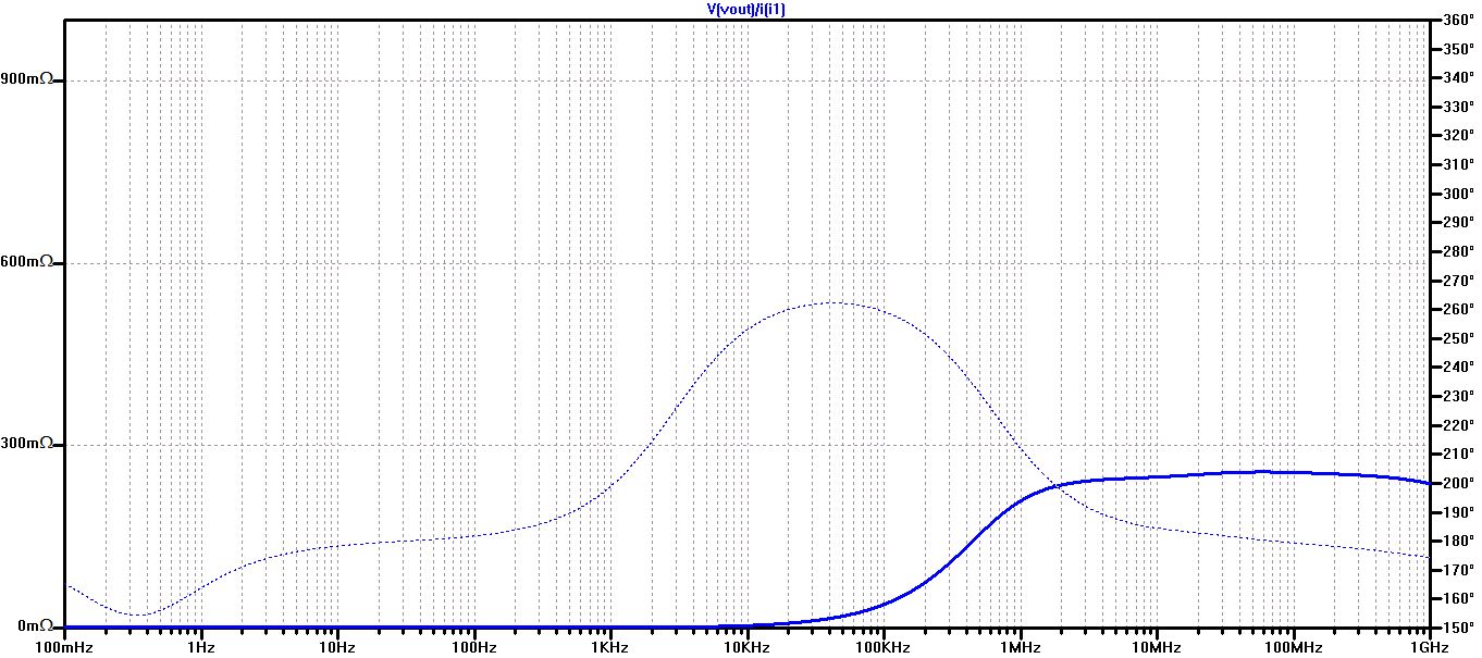

Is this better?
