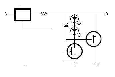

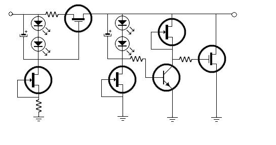

Combining the improvements in both the series and shunt elements, we have an opportunity to create as simple or as complicated a circuit as we need.
Here is a very simple low feedback design. This is just one example of what is possible.
It’s virtually mix and match with any of the circuits presented.
Here is the Salas Version 1.1; I consider this to be very good engineering.
The circuit is stable, not sensitive to parts or layout, and not insanely complex.
The original is in the DIYaudio thread simplistic-salas-low-voltage-shunt-regulator, post 501.
http://www.diyaudio.com/forums/powe...w-voltage-shunt-regulator-51.html#post1855189
As you can see, you can make this as simple or complicated as you need.

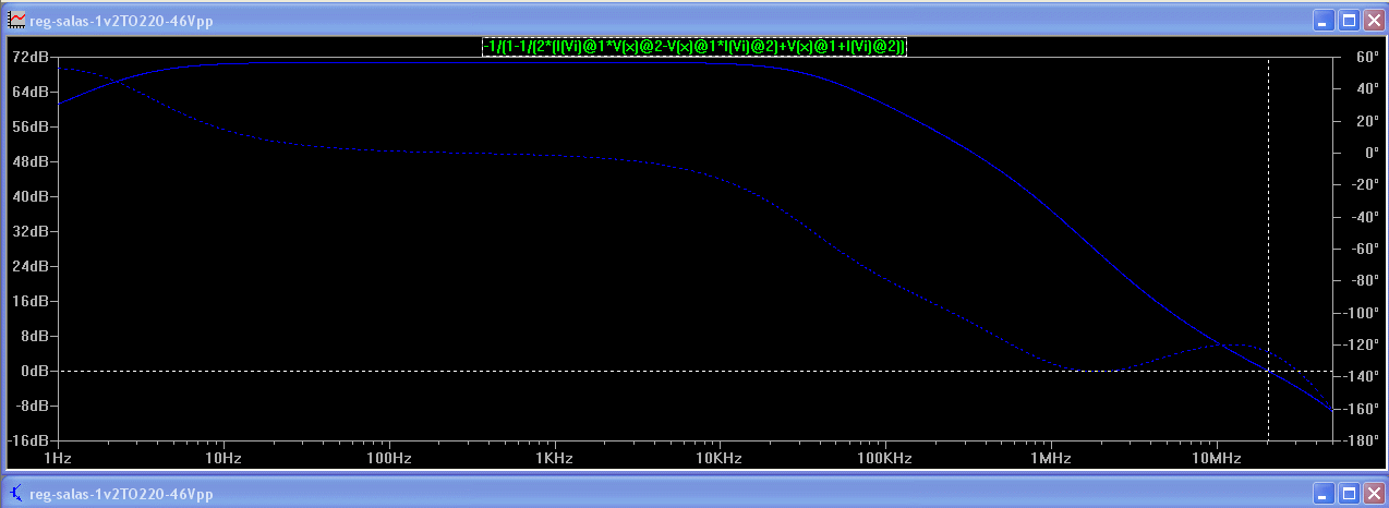

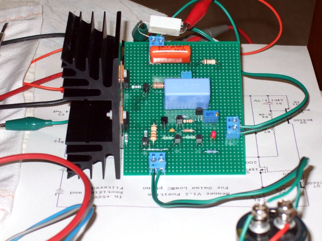

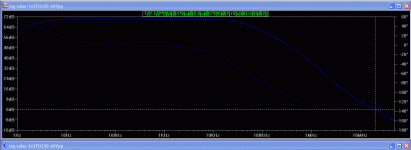

Higher current through v1.2 will easily lead to instability because of the higher gain at higher frequency (you can blame the buffer which extends the bandwidth). v1 does not suffer of this problem. That's what I think, although I haven't built v1.2 yet.
However, I haven't thought of the compensation which I'm told brings the regulator to stability. So I retract my previous comment.

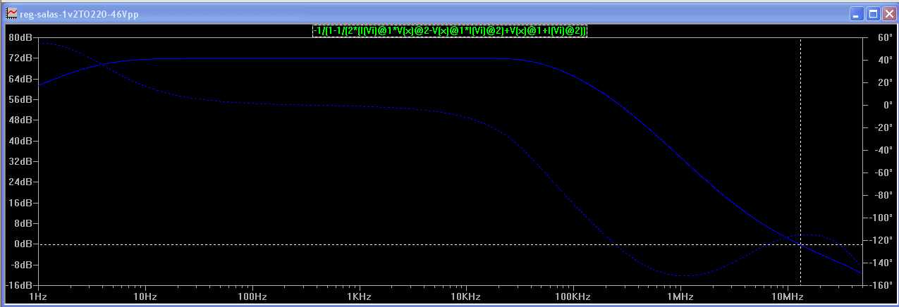

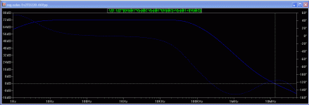

Here are two simulation indications. Run on V1.2 TO-220 IRF9610 & 9540 46Vo with 10uF film cap for the Norton Vref decoupling and 4u7 film cap with 1R locally across reg's output. There is a lead-lag step network compensating the error amplifier. To the left at 200mA. To the right at 1A. 10 degrees of PM loss. Its not meant to run on amps due to the heat inefficiency, thus the lighter/faster CCS Mosfet, but I checked it out on the sim just for the sake of argument. If a heavy duty application comes to mind, the gate stoppers and the comp can always be centered around large current and TO-247 Mosfets. I would not think that the signal levels on a power amp will justify more than a V1.0 if a shunt is wished to power it though.
