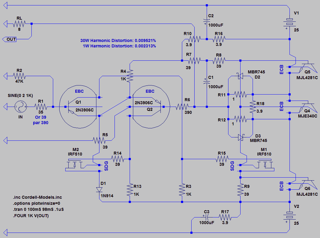

You are probably looking at PSRR sim with 10KHz and 15KHz injected to the rails.
Was done to see how much reached the output. Set power supplies back to 25VDC.
I've found the main weakness in my circuit to be the current
steering transistor. My earlier choice 2n3019 was just terrible
in this application. Especially when top thieving was applied.
Something about JLH's excess of bias through the middle had
a synergy with the non-linearity of this component that I did
not previously appreciate. I saw it only as a waste of 50W...
Replacement with MOSFET current steering transistor here
shows a preference for top thieving the original BJT did not!
The distortion now seems to be absurdly low. More so than
the increase in open loop gain would lead me to expect...
What the heck is going here that appears to work so well
with these same crummy old output and thieving devices?
Have I stumbled upon another synergy of non-linearities?
The second MOSFET is tackling a phase shift problem that
Elvee observed with VBE cap in my earlier offset correction.
Q2 behaves truer to intended purpose, a unity gain follower
with emitter current and collector voltage held constant as
close as possible to Q1's quiescent state. Or so I hope...

Hi Kenpeter,
I am impressed.
What current flows through R7, 8?
Is it not too high? or is it necessary to the circuit to work so well?
I like that one very much.
I would go so far as to say this is the most significant and valuable evolution of the JLH since the original version: both improvements make a huge difference, yet they are simple and neat.
Excellent!
One thing puzzles me: is the modulation of the R10 R4 node by the output through R7 intentional?

About 275mA. Just enough to cover the peak drive needed for 8 ohm load.
But could also be considered as a 43ohm RC Zobel. An open output would
always see at least this much load. And maybe that's part of the magic?
275mA is nowhere near enough drive for 4 ohm loaded 2n3055 outputs.
For 4 ohms, you could increase bootstrap currents further, but quickly
becomes absurd. As much as 30% of the output power wasted thusly.
Power supply and heatsink upcost in such a wasteful circuit have to
be considered. Better to spend the dollar on modern output transistor
with less beta droop.

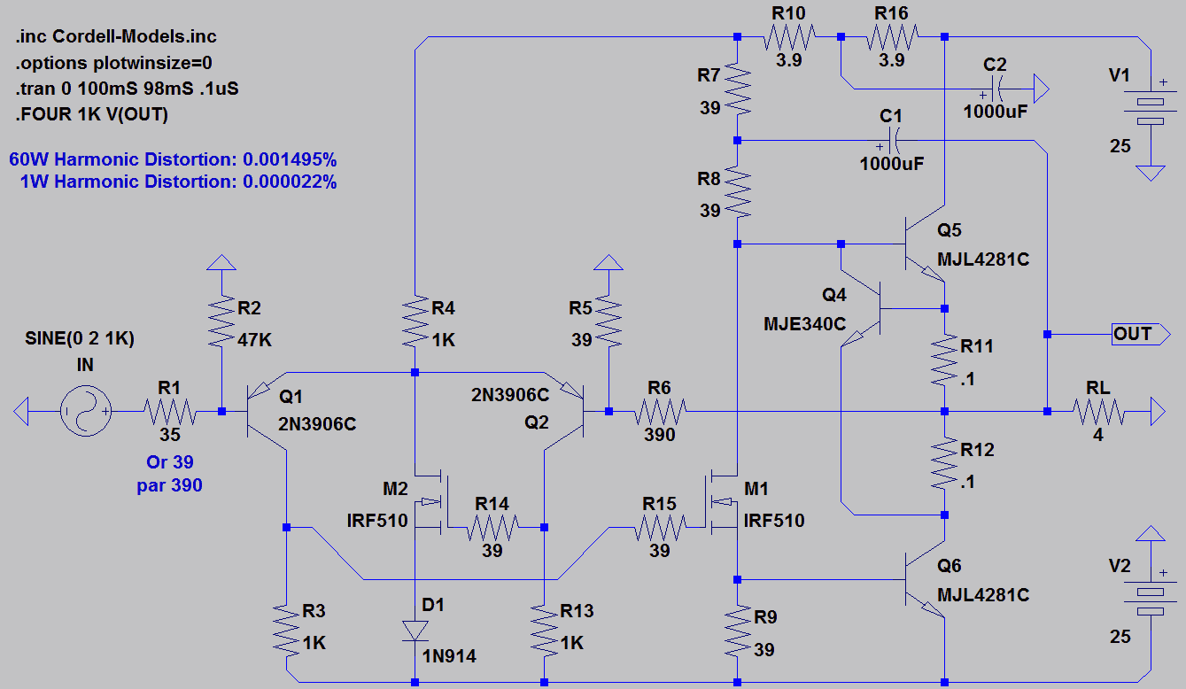

Looks like 4 ohms wants only bigger supplies and better transistors.
The bootstrap network needs no upgrade. No significant adjustments
except current sensing resistor values for higher output quiescent.
MJE340 is a slight performance downgrade from 2n2222, but has
a hole for mounting to output heatsink. I prefer thieving threshold
feel the heat, and reduce quiescent as output temperature rises.
I may revisit this choice later, it certainly doesn't require a high
voltage transistor. I was only after the hole, and the model was
there in Bob's library. Lazy selection happened...
There's no Cordell Model for IRF510, default .model might be suspect.
I can't help but distrust this distortion seems too low to be realistic.

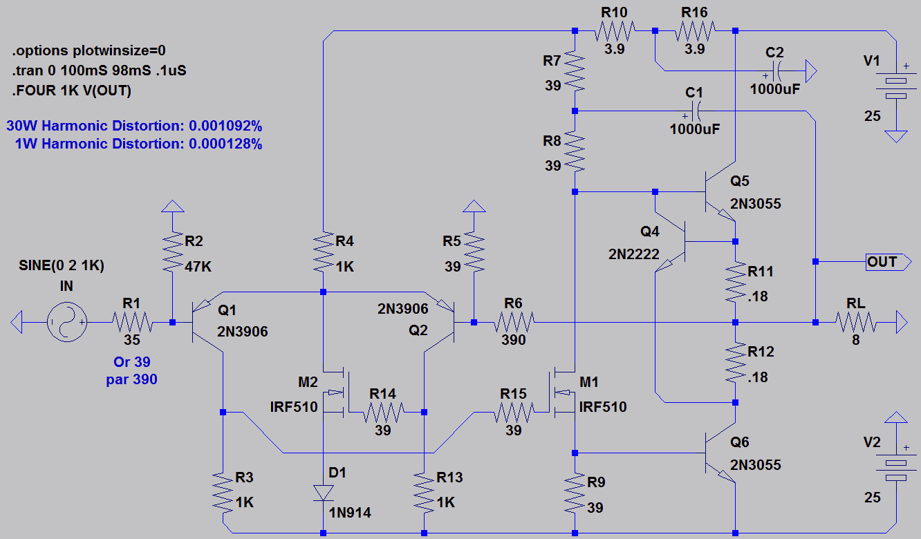

Back to 8 ohm quiescent for a second....
I wanted to observe how thieving can force a match between
seriously different transistors. Attempting 2n3055 with MJL4281A
Junk Transistor on top: 30W Harmonic Distortion: 0.003684%
Junk Transistor on bottom: 30W Harmonic Distortion: 0.002456%
If I had a mismatched pair, I'd still put the better transistor on the
bottom, it has to carry bit more current due emitter facing the rail.
I can't quite get Mosfet on the top to work anymore, but used to.
Wanted to show that for laughs, but not going to happen today.
Not sure what I changed that made that combo quit working?
There's enough bootstrap voltage, it should have worked...
Mosfet on the bottom always has issue when the output would
swing below the gate threshold. Would not expect that to work.
Only on the topside, together with thieving makes an Aleph Pair....

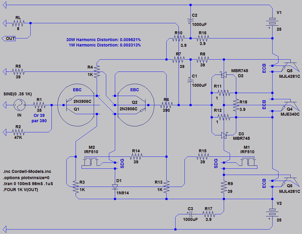

If this were a layout for single sided PCB, how awful would it be?
I'm not sure I have the best plan in mind for the grounding...
If I were to point to point Manhattan style over a ground plane,
might not matter. But I'd want a PCB sooner or later... Would
grounding the flipside of a double-sided PCB be enough?
Where about should signal and other grounds come together?
Pay no mind the Schottky diodes, just an option for class AB.
Linear Class A does not require anyone to install those parts.

at spec sheet with pinout view from underneath. I could just
flip EBC with layout as-is. But the idea I had in mind was to
clip them face to face in a TO5 heatsink. Won't work as drawn...
Aw crud... I drew pinouts backwards for 2n3906! was looking

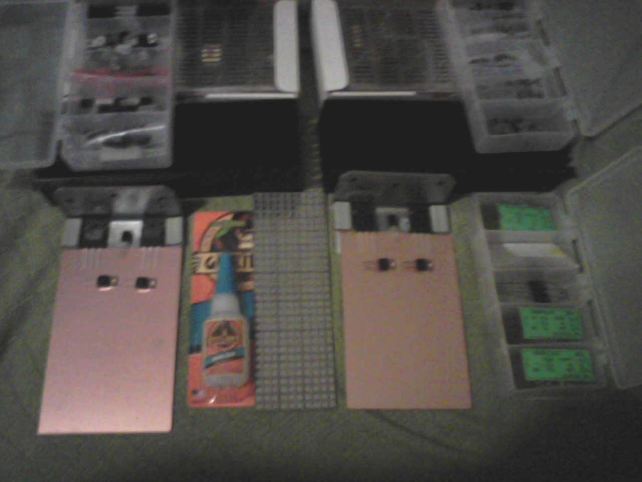

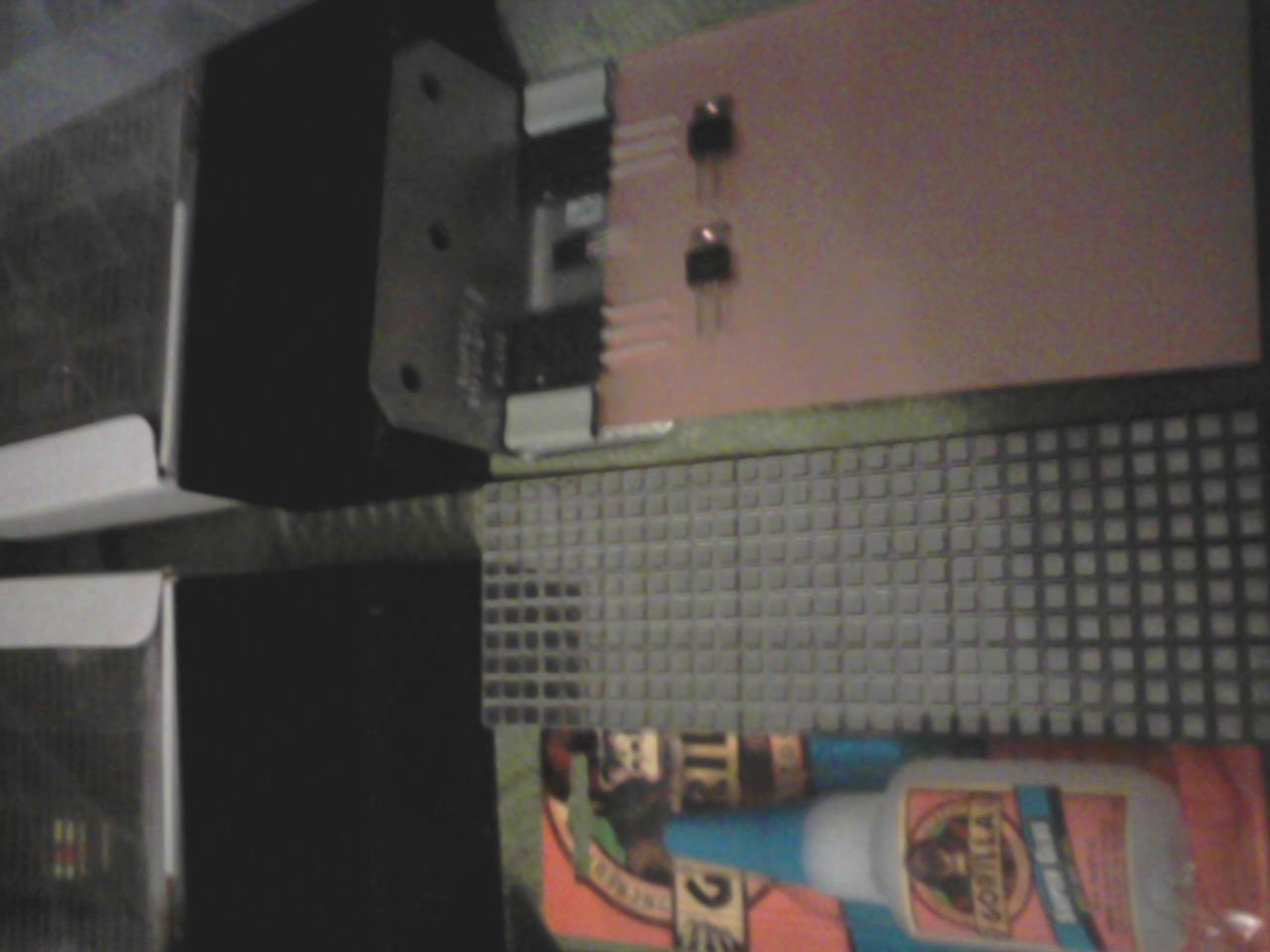

Seriously need to charge up my good camera.
This here blur of what might become an amp...
See the sheet of Manhattan islands ready to
break away and glue over the ground plane?
Wish I knew where to get more. Something I
bought at a HAM convention, but forgot who
it was that sold them...
Not sure I care to use those Simpson ties.
Cheaper and stronger than aluminum, but
will they move the heat? Can't be worse
than the grey pad that goes between....
Could bolt straight to this heatsink, but
then gotta make fixtures for transistor
legs to screw into the PCB somehow.
I got a flat bar of aluminum round here
somewhere. Not sure if its a shape that
would be any help.... I want like an L....
Power supplies in the background only
rated for 4.2Amps . Linear Class A not
an option, thus the Schottky pairs for
Square law vs Square law Class A.
I can power for Linear Class A at work
on big Agilent supplies, but not at home.
Make it so the board can shunt regulate
for either curve on demand...

If I sandwich the output transistors between the
L and the copper backside of my board (maximum
heat dissipation), I might want to flip the pinout on
my layout. Else I have to build the whole circuit on
the backside. I don't know how well the islands will
stick to the copper side? I was planing to superglue
the bare side of my Mahattan pads to the bare side
of the board. I've seen it done on the copper side,
but I don't know if attachment is sturdy like that..
No, I just need to drill holes to let the output legs
feed through the board to the bare side, without
touching the groundplane as they pass through...
BD139 fullpack isn't same thickness as 2SC5200.
How do I shim the sandwich to insure it touches
the L bracket of the heatsink? Or is just sticking
it between groundplane and L bracket adequate?
Only needs to sense output heat, not dissipate
much of its own...
