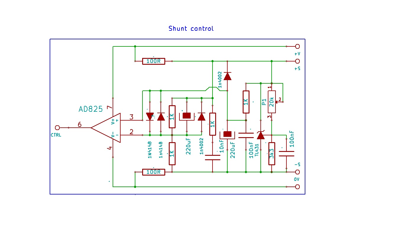

No one has pointed it out yet, the TL431 is missing a 1K resistor from the top of the pre-set to +S 😱

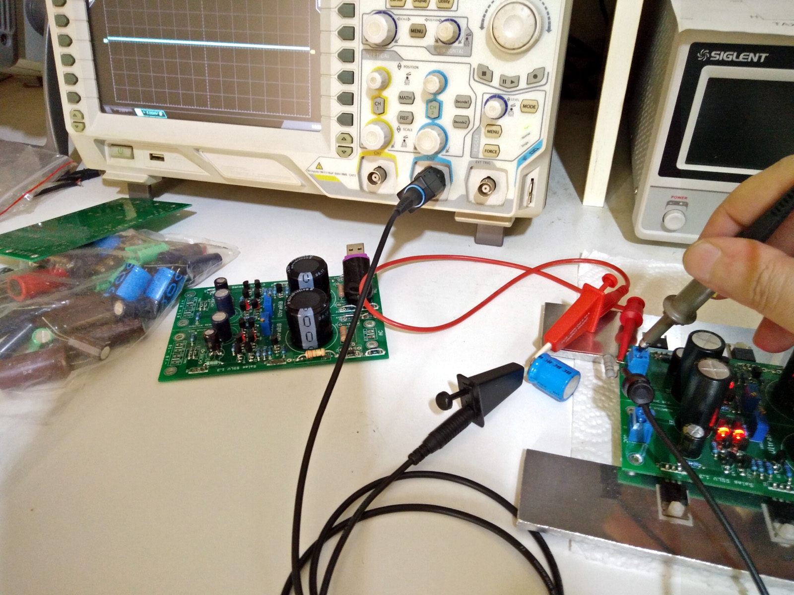

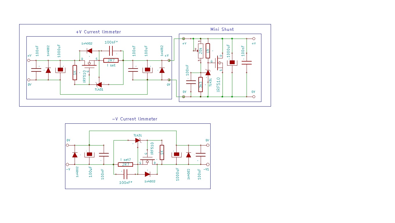

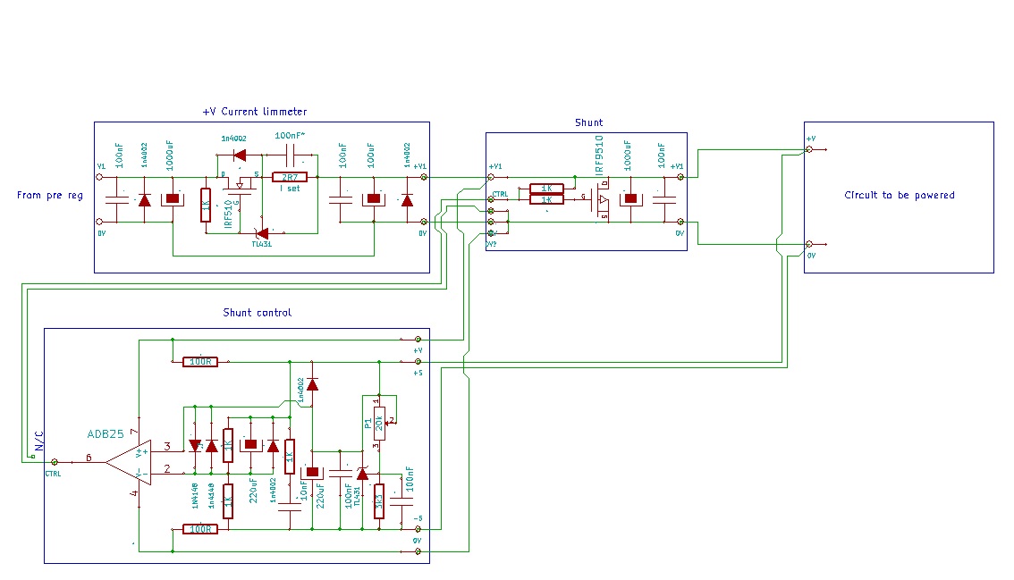

Time for an update, parts arrived, kludged something together, no exotic parts used; apart from the RS brand on the main reservoir cap, the 220uF & 0.1uF are the cheap and unbranded kind.
Pictures are better than words.
Forgot to fully edit the schematic, diodes are now a 35A bridge, input cap is 33,000uF.
To be honest, it looks too good to be true, the 2i2 is set to a gain of 5(ish); maybe I should make another interface cable, it's 100K 1uF 10K // 2x anti // 1N4002; that's no attenuation (-3dB @ 16Hz) and about 10K in // with the 2i2 input.
I assume the 2i2 is AC coupled (Phantom power button) but I didn't fancy feeding 20V DC into it without knowing for definite, can anyone confirm either way?
