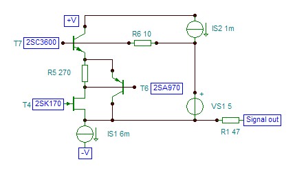

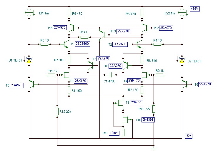

maxpou, this is my guess:
> You should change it, so it will be like one of Lumba Ogir JFET amplifiers
... the only drawback, is that it will no longer be your design
Lumba Ogir JFET amp circuits & projects topics,
which we have seen plenty many of (do I need to provide links?)
are those that can work very well and so not get critical comment from Lumba.
In fact, they are above John Curl class, if I have understood Lumba's posts correctly.
Personally, I like your amplifier very much.
You have done most everything possible to improve JFET Stages.
Using cascodes.
Maybe you have mentioned what Supply voltage you use?
It is not in schematic
http://www.diyaudio.com/forums/attachment.php?s=&postid=1541169&stamp=1213720316
My guess is like +- 18-20 Volt, regulated.
maxpou,
I`d go for a simple stage in keeping with this one.
