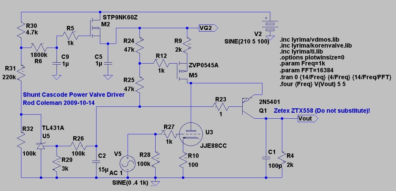

Shunt Cascode Power Valve Driver
PSRR in a Shunt Cascode (the version in my drawings, at least!) has very high PSRR, but it does depend on the current-source.
Further, having the input AND the output referred to ground gives excellent immunity from conducted and radiated noise emissions.
Happily, using the standard depletion-FET circuit (pair of DN2540, cascoded) is all you need to get superb performance.

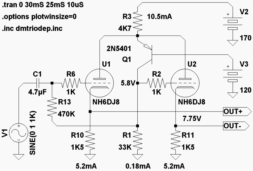

I have still not made it, do have chokes that say 235H/1100 ohms.
The simulation is just a jot together, to see what happens. Just on one tone, the parallel load resistor is not needed; in a sweep it is. In practice I do not think it is needed.
I started thinking about feedback after seeing the Elekit; here it is mucho better (DC balaced!). As well I have tried a feedback between the two cathodes, also good, but more delicxate to get richt. Why FB: I think the 300B I have at least, the carbon type, is not better than my old 10Y. Using the2K-LL2752 I get dynamics but not to great stage. I used all kinds of driver stages, good was 5751/CCS load, currently a two stage 2SN7 - indeed not comfortable.
What I will do is use another tube; in the past I have triode-strapped EF91, EF804, (strapped also low mu if I remember, not much better than the 18-20 dB of the ECC82) and they will give the output swing with ease, but do not have the zappas to provide some grid current. With a choke load that might be different. I expect the low resistance choke in itselfstops any grid blocking.

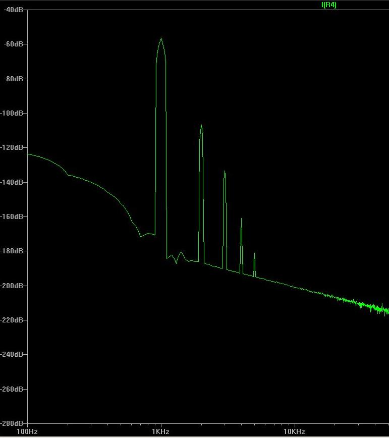

The output spectrum shows the reality of the distortion. That's at 150V p-p, and it declines predictably at lower output.

I have simulated a bit more. [But I will probably go for the ready boards in due time . . .] But I am very tempted to do the choke load because of the DC coupling that is then possible and the felexibility to the Rload.
Becaues of the DC nature of the 'output' of the driver with a Choke the output depends on the value of the choke. It has a rather high -3dB in the low frequencies -for instance 22-25 Hz.
With a parallel load resistor, say 25 K then it extends to below 10Hz.
The load resistor in practice can be chosen ad lib between practically 25K and 215K - there is almost no influence on the DC point of the driven grid. That means the amplification (mu x Rload) can be varied. So that is a big advantage over the 'traditional shunt-cascode' driver with its fixed resistor load (and a coupling cap).​
I tested the circuit with a nuvistor (just for fun, Spice alows me to do it, same results for ECC88) and a rather big and unbypassed 5K Rk I got almost the same results as with a 6SN7 unbypassed 2k2, though I can't say for sure the harmonics are better: just 1 dB improvement of the second harmonics [@1 V in, 3V pp out, no feedback).
- At the edge of overload both drivers I have on paper (Choke vs CCS) also are showing the same high but neat degradation of harmonics.
- > Having a CCS at the output of the driver to get it to about zero DC requires a servo, to overcome real-life drift that the LTSpice does not show So let's say the CCS is impractical.
Feedback from driver-out to grid-in of the driver can be used at will. 😱 With 220k to 12K the FB is about 6 dB.
The harmonics drop from 2=63, 3=75 (2Vpp, no Fb/220G) to 2=48, 3=81 (1Vpp 6dFb with 220k).
