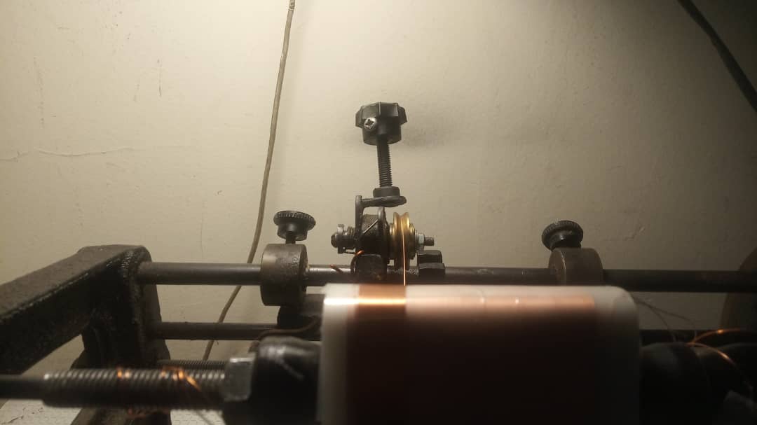

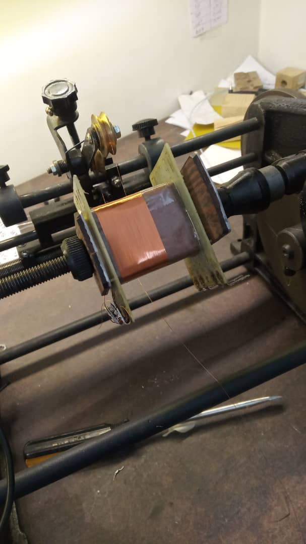

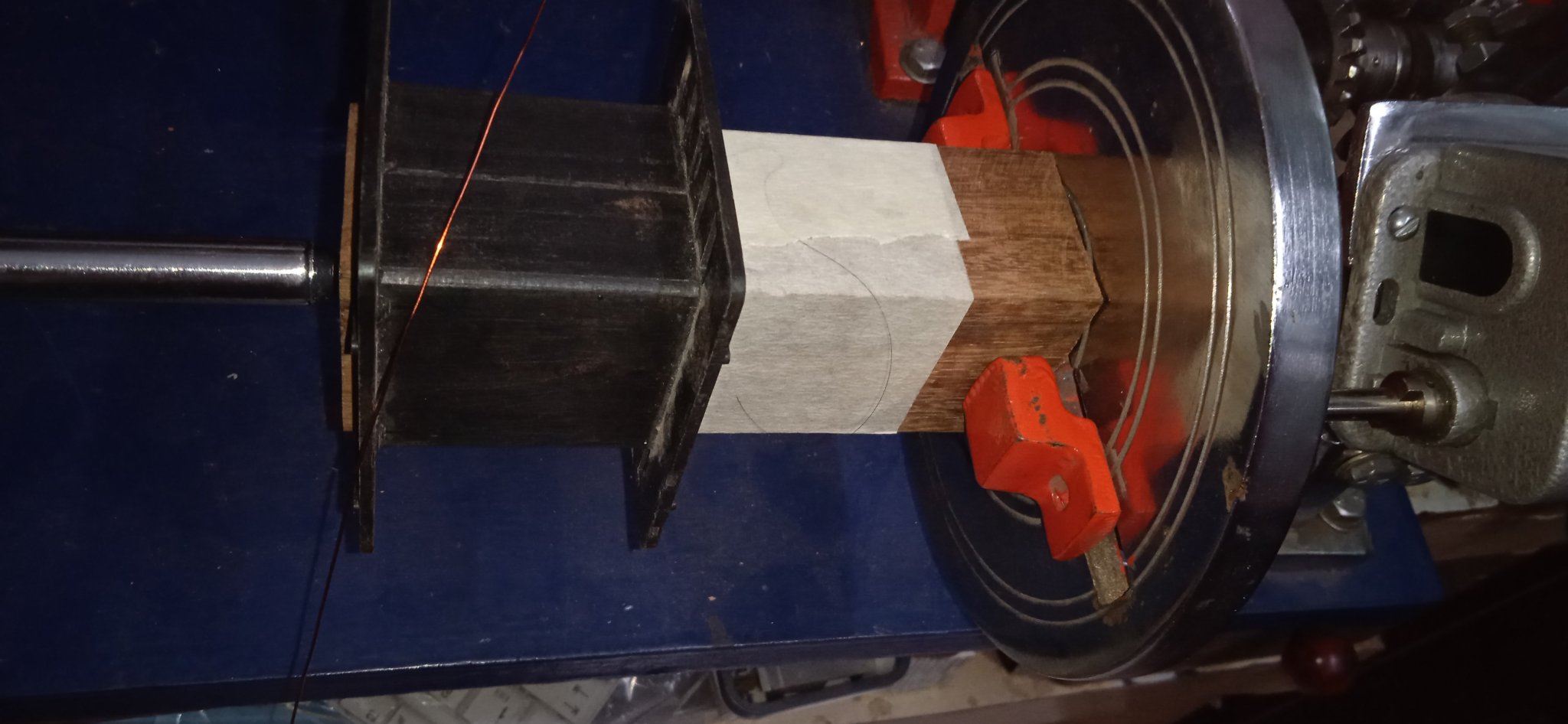

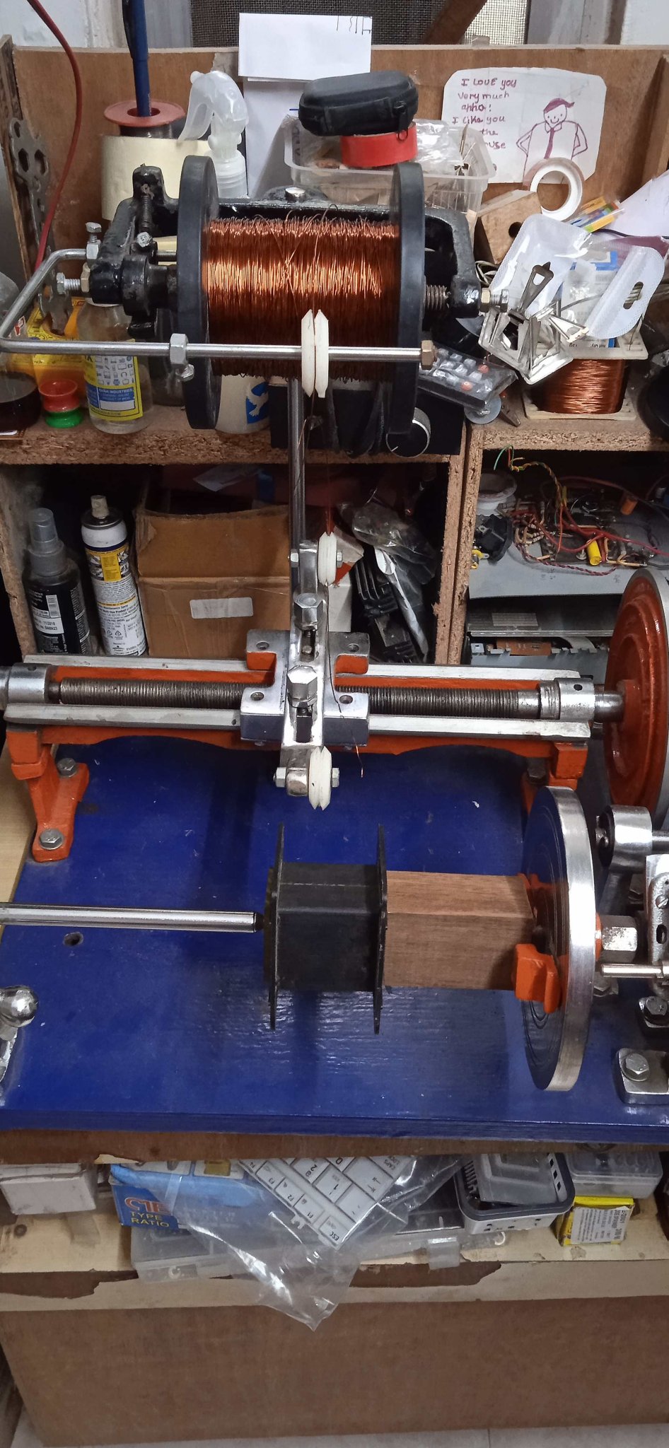

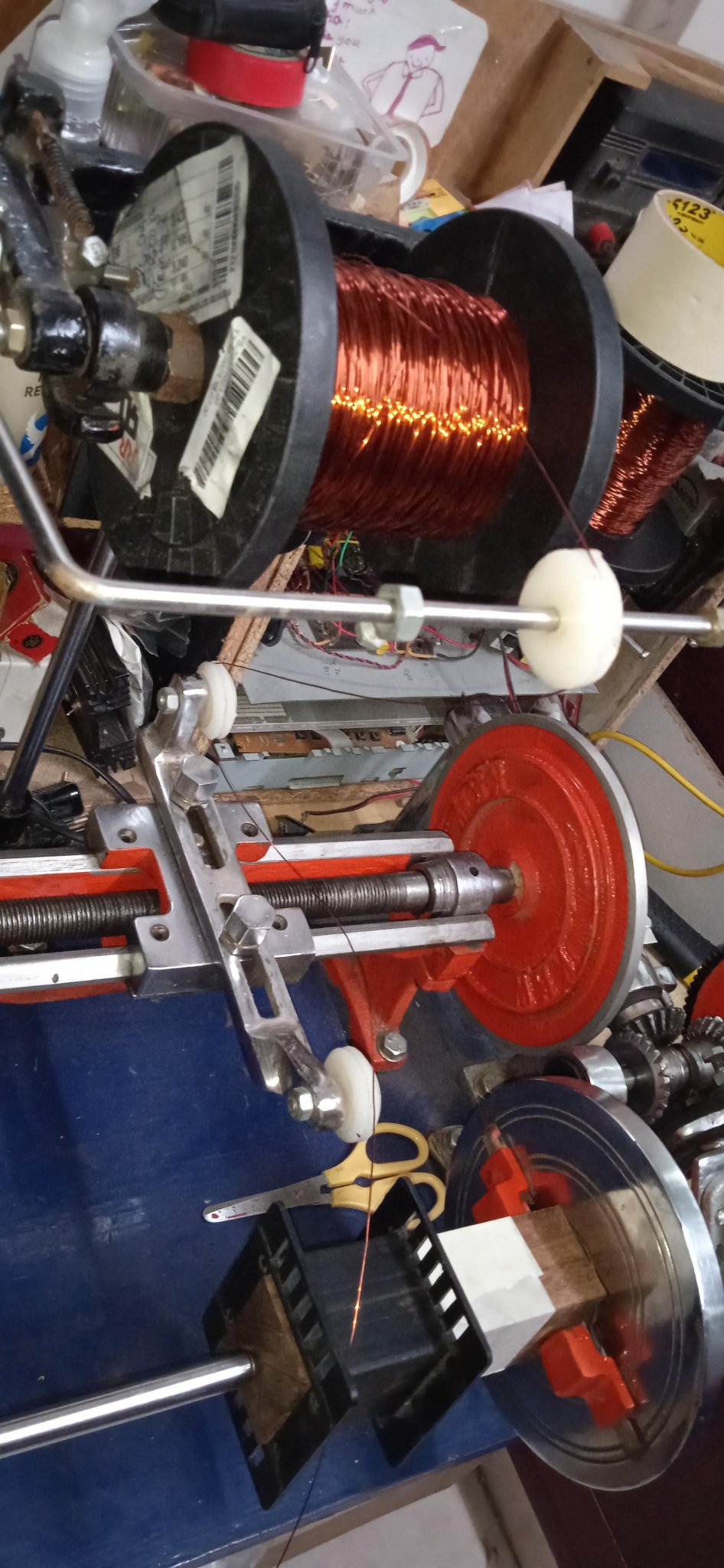

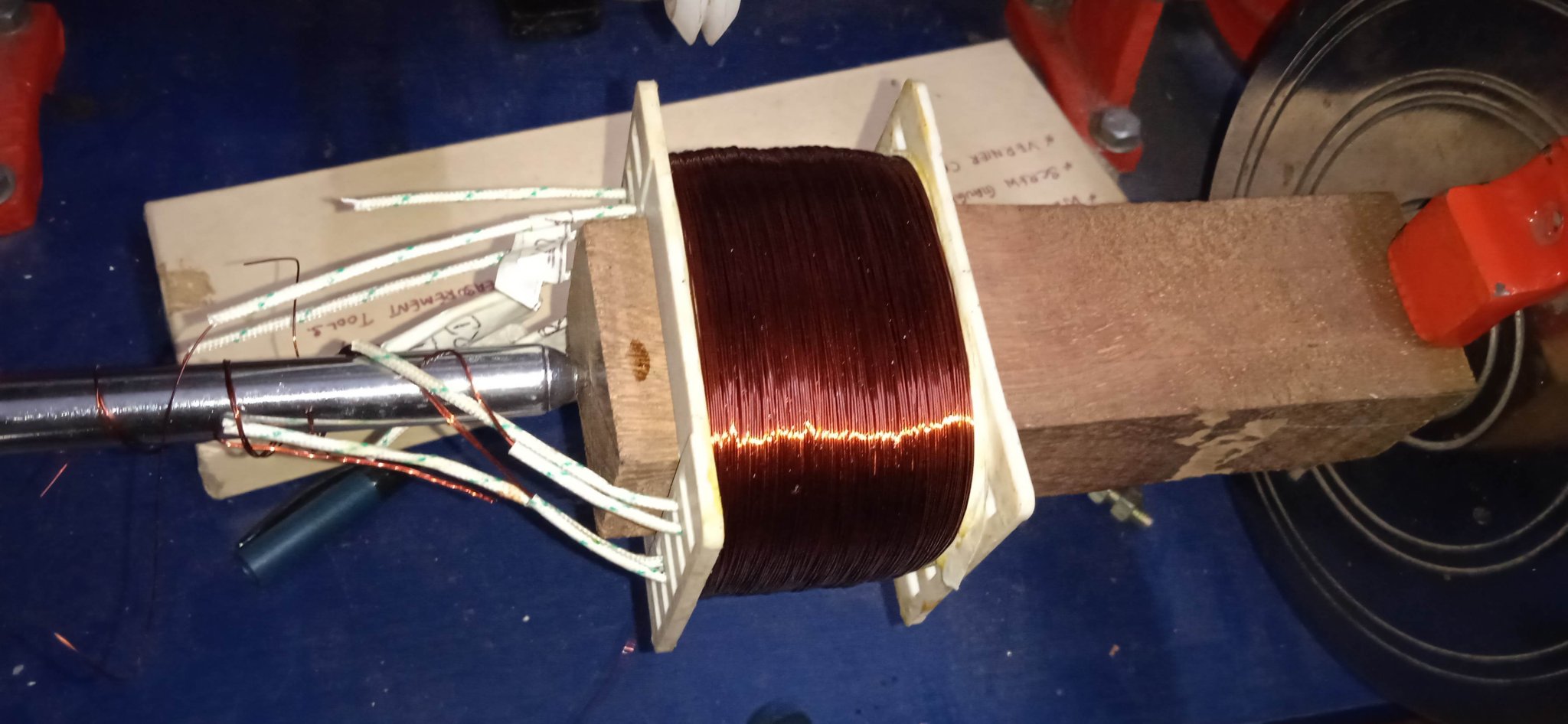

Some random pictures of my winding setup. A manual rotation and semi feeding mechanicsm.. The feeder works pretty good, Not as accurate as servo motor microprocessor controlled,but very durable and with patient winding,does the job nice

Well done! Clean design!

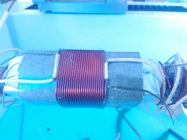

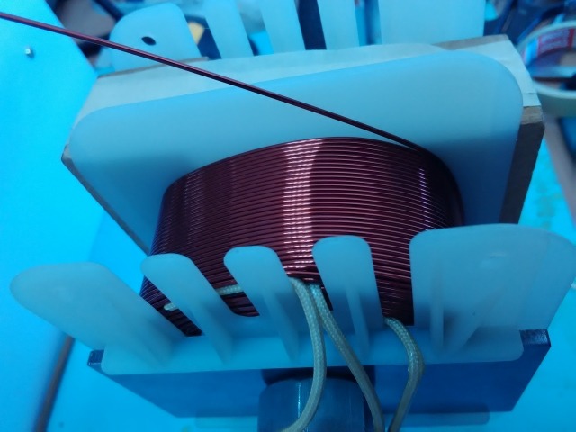

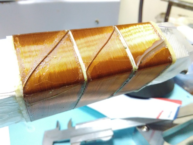

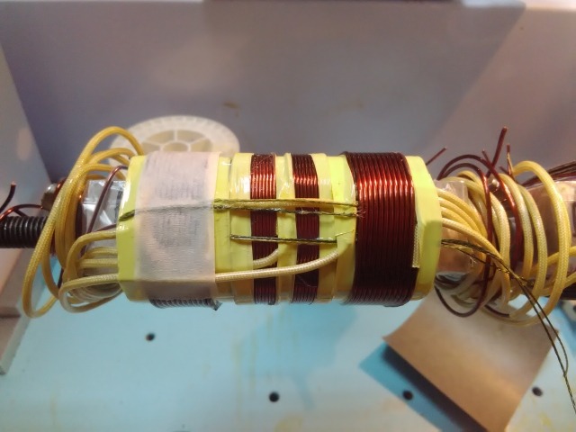

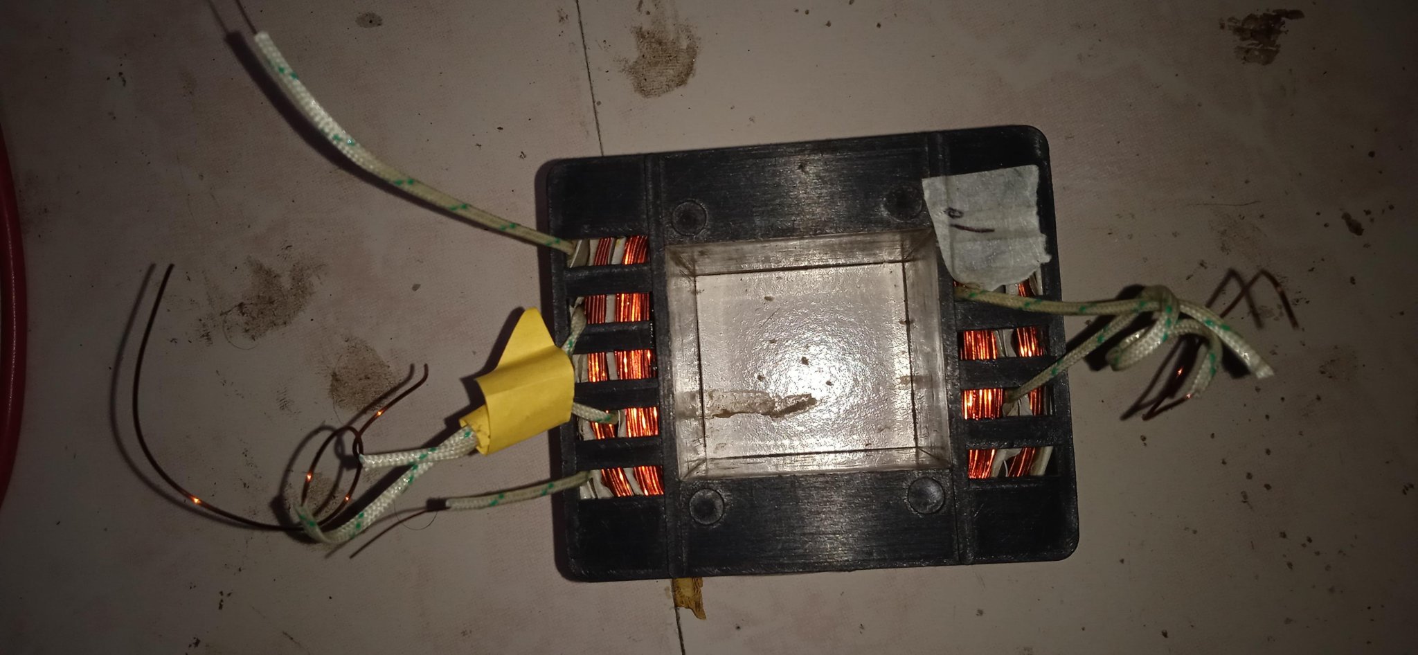

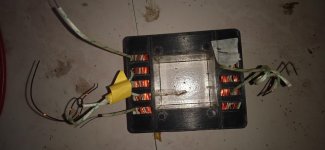

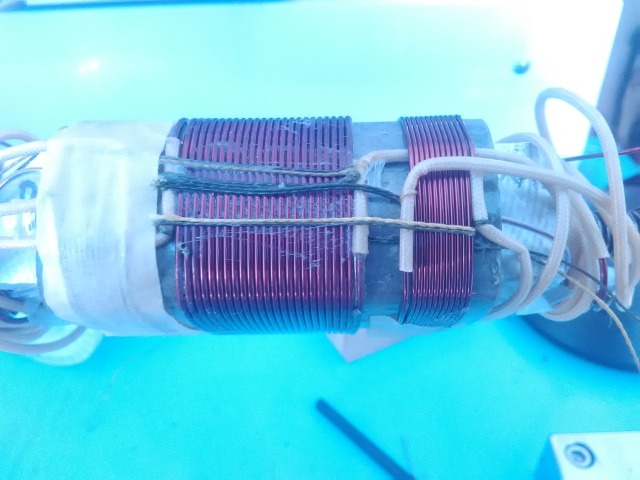

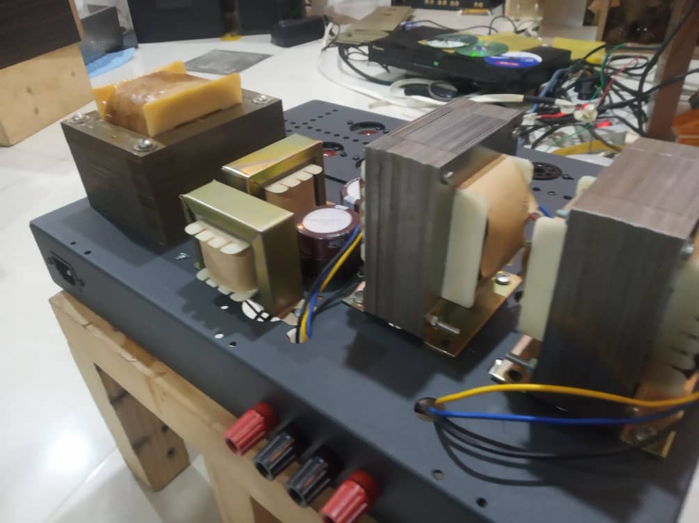

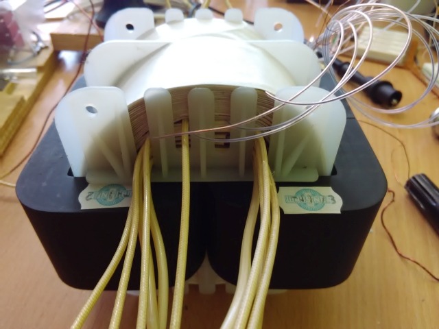

Sharing some kinky stuff from 2017, where I started learning and experimenting with too many things at once. Photo 4 is a vertically sectioned interstage transformer. Photos 1,2 and 3 represent heater transformer windings with many voltages. Photos 5 and 6 are depicting a power supply transformer for tube amplifier, with HT and heater voltages.

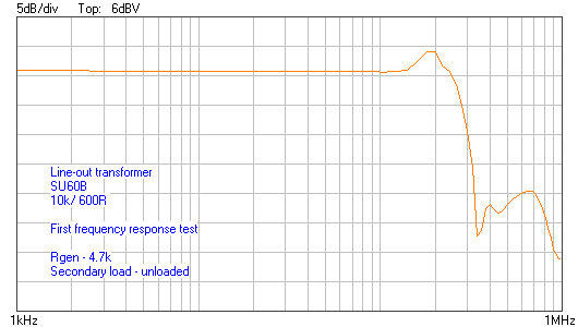

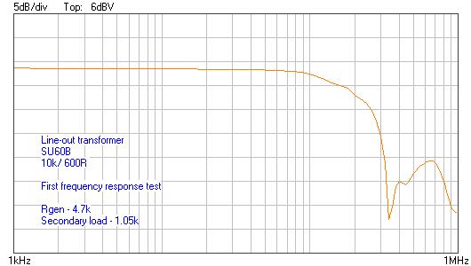

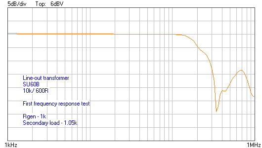

Testing some new 10k/600R Line-out transformer prototypes, desired to be gapped at 60H @ 25mA Idc

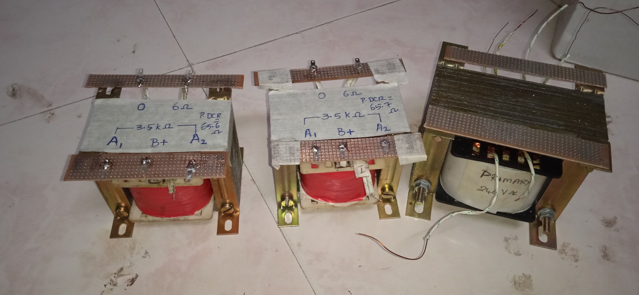

tnvijay, pl post more details of the output transformers you wound...assume those were for the baby Huey el84 amp.
core size, winding details...

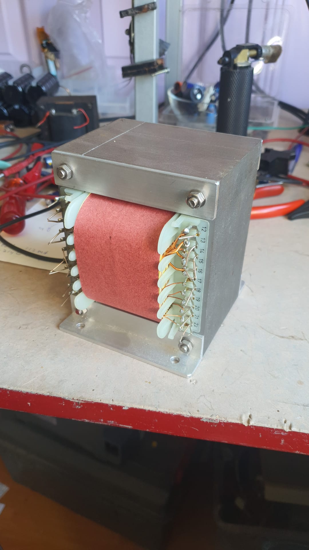

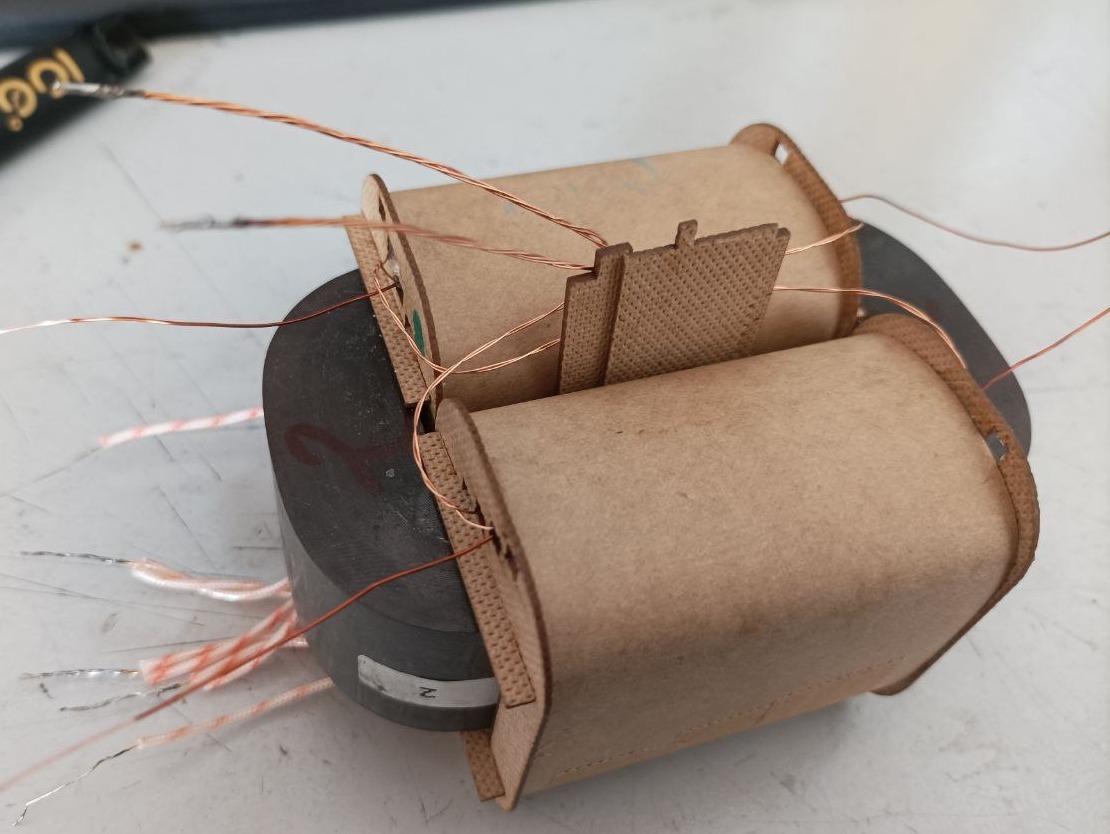

Here is finished transformer, 60W PP, 33%UL, 12%CFB, 1165H primary inductance @200V/50Hz, 3.28mH leakage inductance, 67KHz -3dB top frequency, primary R=67.5 Ohm, CFB R=7.7 Ohm, Secondary R<=0.2 Ohm. I tested it in Williamson and HK Citation II circuits, both are known to be quite demanding to the quality of output iron. Frequency response of the last is flat up to 50KHz, as with original output iron.
Bobbin laser cut from 2mm composite epoxy laminate, sheet material is cemented before cutting. Design of the bobbin is universal, it can be manufactured with laser, CNC mill (with corner clearance for 3.175mm mill), or 3D printed.
