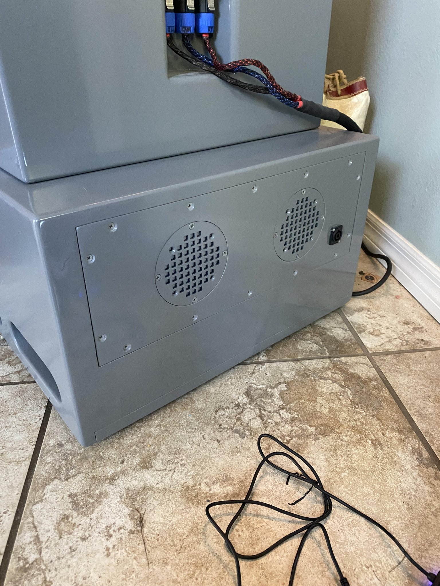

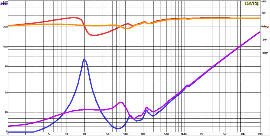

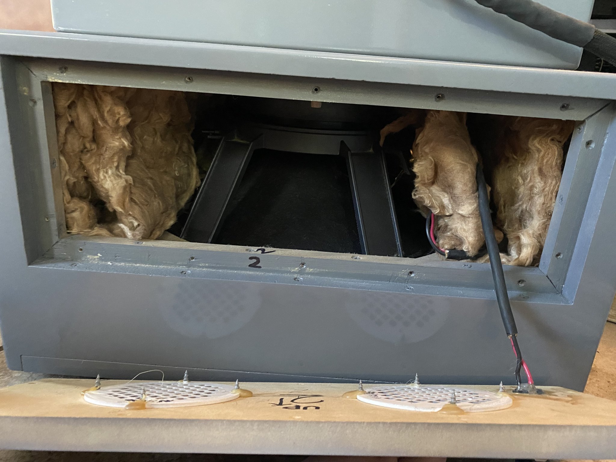

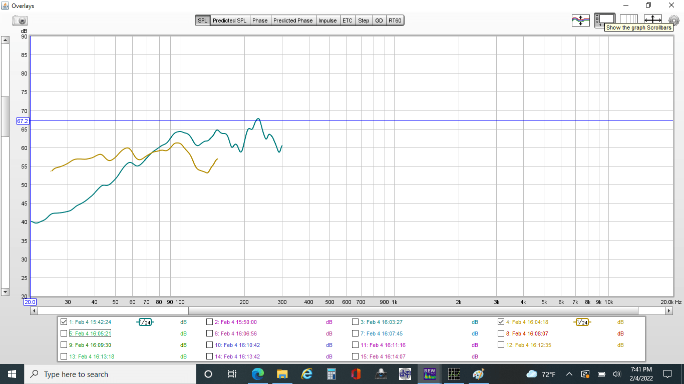

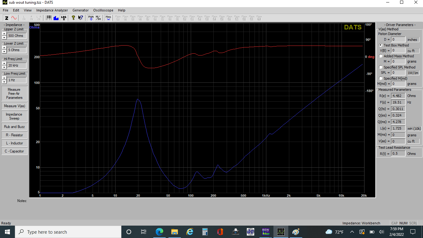

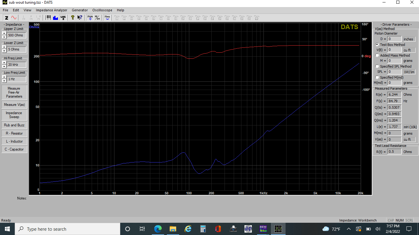

I see this topic kinda stalled...I really got into these aperiodics and decided to try my hand at a sub using one of the B-52 SP1804 18"subs. I read all kinda stuff about designing the enclosure and the majority said modeling a .1 qts sealed enclosure would get you the "right" volume to start with, so I went with that. I got four 4" pvc Oatey drain covers and cut them to just under 3/8" deep(let's call them vents now) so putting them back to back gave me 3/4" for the MDF back panel thickness. I made the rear panel of the sub removable and mounted 2 of the vents inside so I couldn't push them thru. I bolted the back panel in, stuffed the vent with dacron batting cut into discs that fit inside the vents perfectly, mounted the outer vents in place and measured the impedance using DATS2. I was able to drastically reduce the impedance peak and get it sounding pretty nice. To me it is on the "dry" side but I like that. Using miniDSP and REW EQ I got it exactly where I want it; tight response with quick transients. I plan to mess around with another enclosure soon just to try and maximize the sound; maybe you guys can help me through it with experience or guidance I missed! I'll throw up some pics/charts later. Really looking forward to this.
Brad, any pictures of the before/after impedance?

I do have some at home on my computer...just gotta get outta the job first! 😀 Thanks for that link!Brad, any pictures of the before/after impedance?

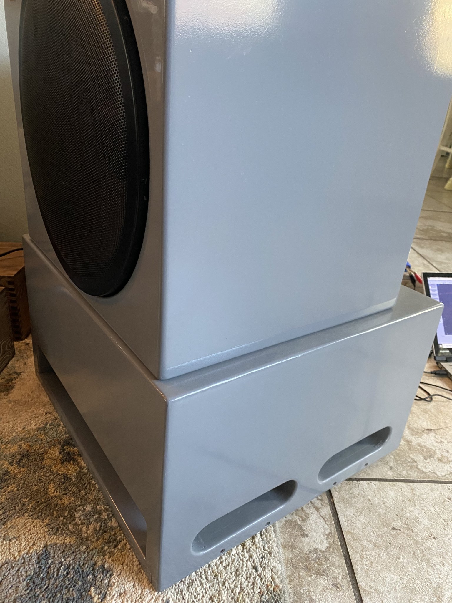

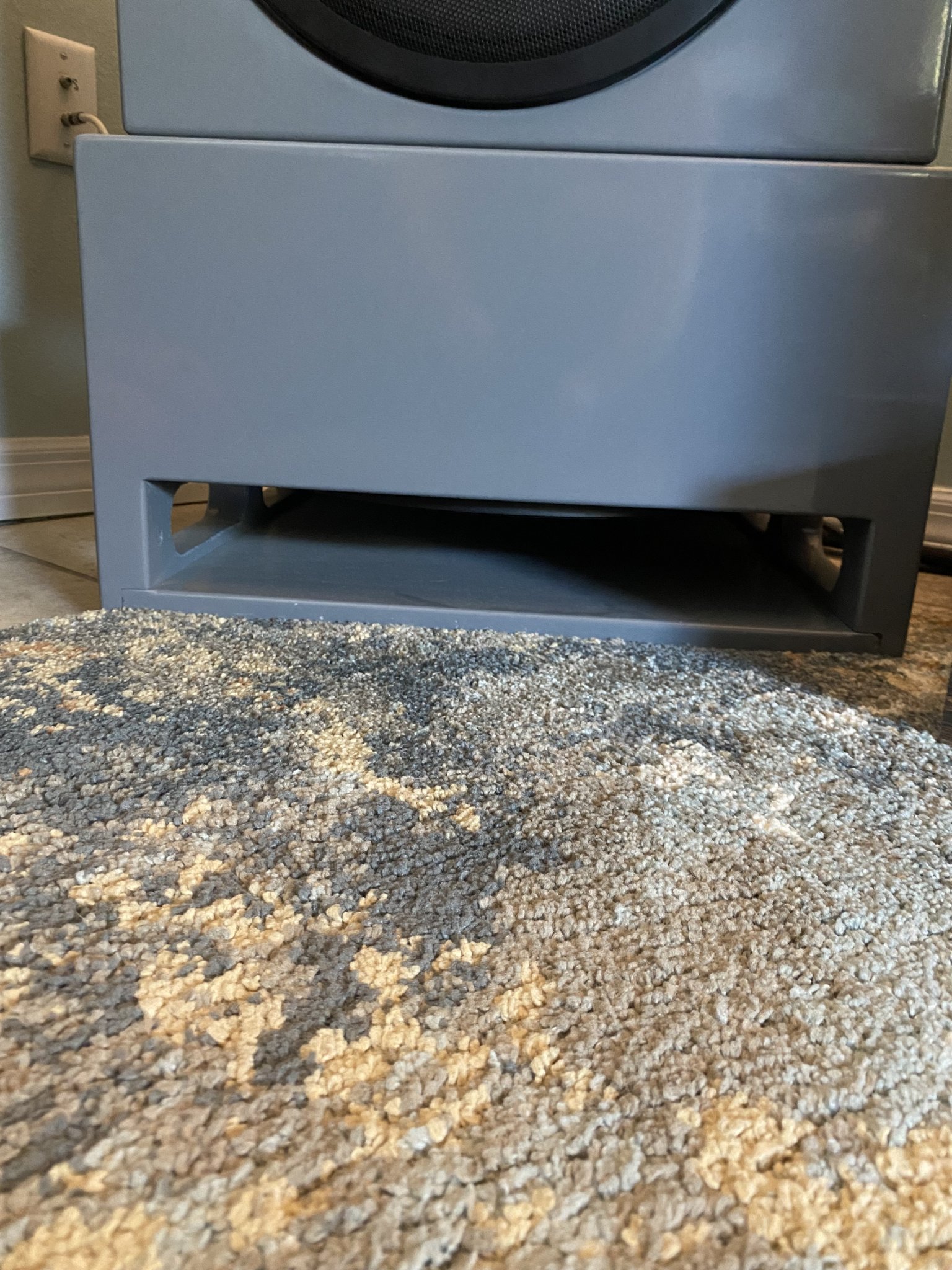

So here are some pics of the enclosure, vents, impedance and response before and after miniDSP. The "vents" are a bit too small according to the above formula and really pushing them hard with just a 25hz wave I could hear their effects...just gotta get around to making a larger panel. I plan to start renovating them this spring so any ideas are welcome.
BTW, the subs are the bottom cabinet; downfiring...just for clarification. The 2226G's above are midbass/midrange with JBL AM-6200 horns above in a custom mount.So here are some pics of the enclosure, vents, impedance and response before and after miniDSP. The "vents" are a bit too small according to the above formula and really pushing them hard with just a 25hz wave I could hear their effects...just gotta get around to making a larger panel. I plan to start renovating them this spring so any ideas are welcome.
I use these for subs/bass only. I cross them in the mini dsp at 110Hz, 4th order LR so that’s never even in consideration. I know some will say it’s a waste of an 18 sub, but with the miniDSP, not so much.

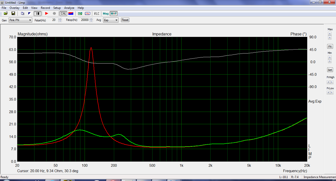

Here the impedance from an early one:

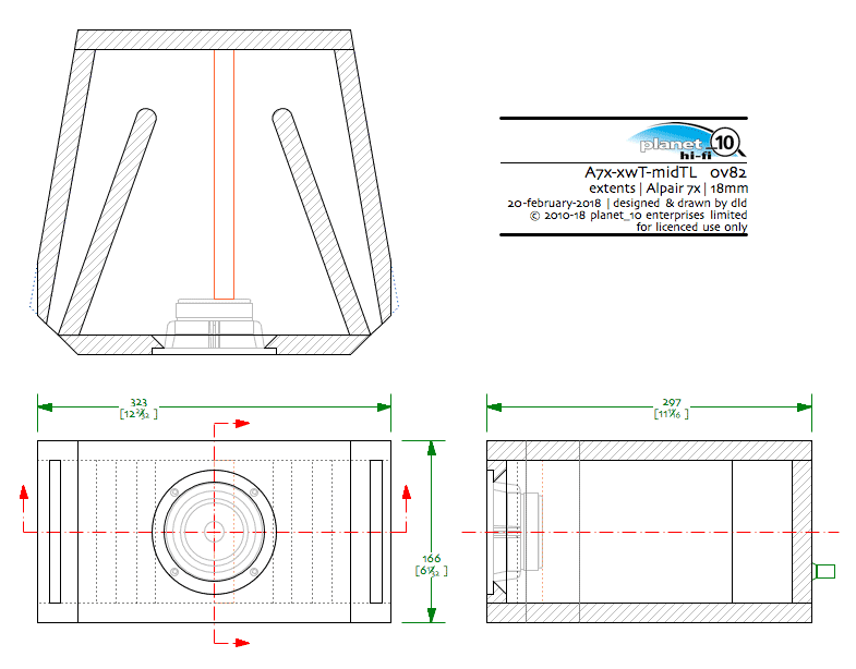

The trapezoidal midTL you have extacted and atteched goes with the A12pw Mr-Ken. A simple height change allows for use of any midTweeter that fits. This design has no passive XO.

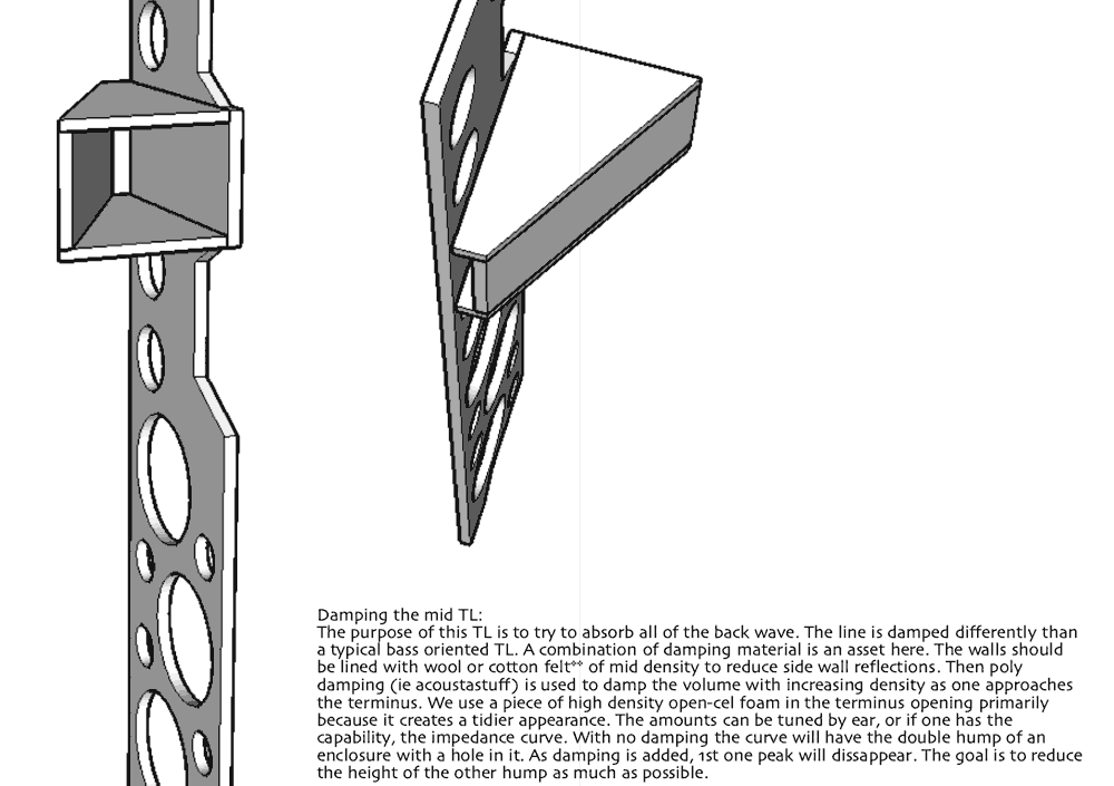

A midTL is pretty easy to design. There is little that is critical. Basically you want to make as “long” a line as there is space availble. A heavy taper makes the line appera longer. One does not want the sides too close at the driver which usually means box size is larger than the minimum with no effort.
