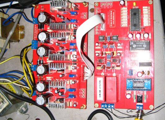

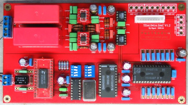

H hgwd Member Joined 2007 2009-05-04 4:06 pm #1 2009-05-04 4:06 pm #1 The DAC only spand 50 $. sounds very well. CS8412+SAA7220P/b+tda1541A + AD797 and OPA2604 Attachments 1.jpg 76.9 KB · Views: 405 H hgwd Member Joined 2007 2009-05-05 9:38 am #2 2009-05-05 9:38 am #2 it's MY first DAC¡£ Attachments 0.jpg 67.7 KB · Views: 307 H hgwd Member Joined 2007 2009-05-05 9:47 am #3 2009-05-05 9:47 am #3 it can work OS and NOS Mode by the switch¡£ I used the classical OP-AMP approach two OPA2604 AND two OPA604. Tolu Member Joined 2007 2009-05-05 10:14 am #4 2009-05-05 10:14 am #4 Nice PCB! OPA2604/604: go for better model will increase SQ! e.g. LME49710/20 Status Not open for further replies. Share: Facebook X (Twitter) LinkedIn Reddit Pinterest Tumblr WhatsApp Email Link
