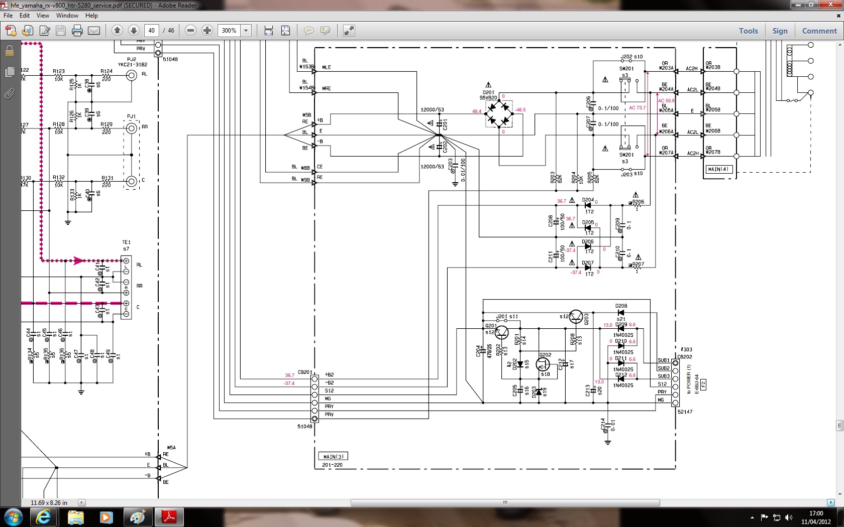

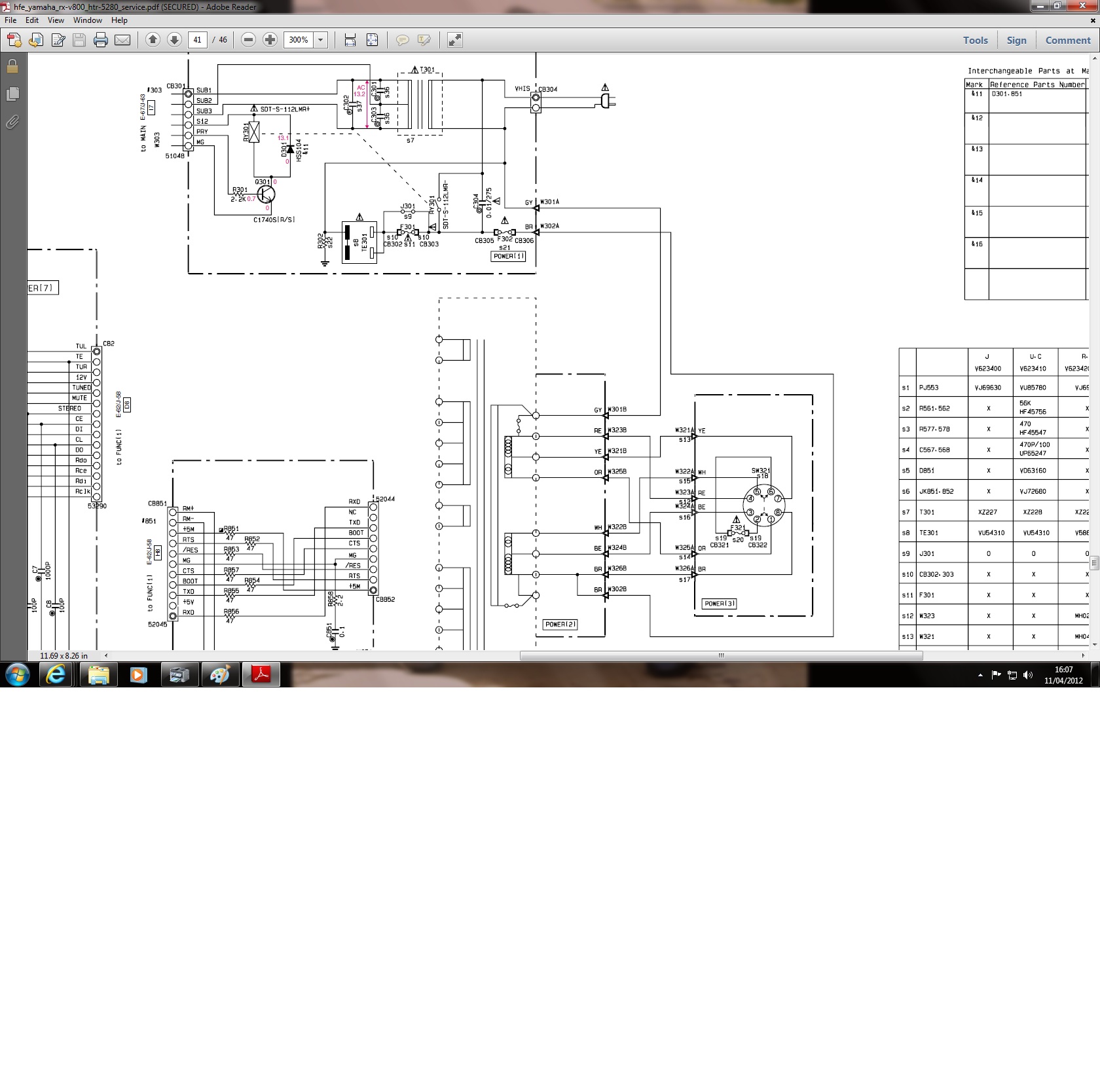

Is it possible to isolate the HT outputs from the main board so that it would be safer to power up the PSUs ?
DO BEAR IN MIND THAT THIS IS THE RX-V800 SO THERE MAY BE DIFFERENCES.
