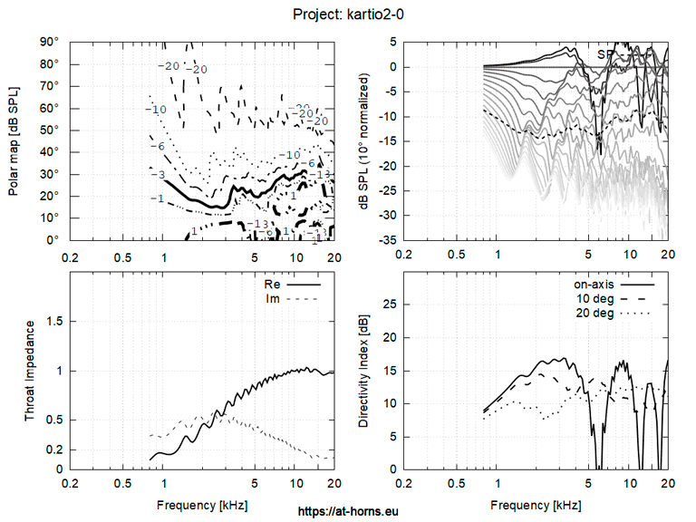

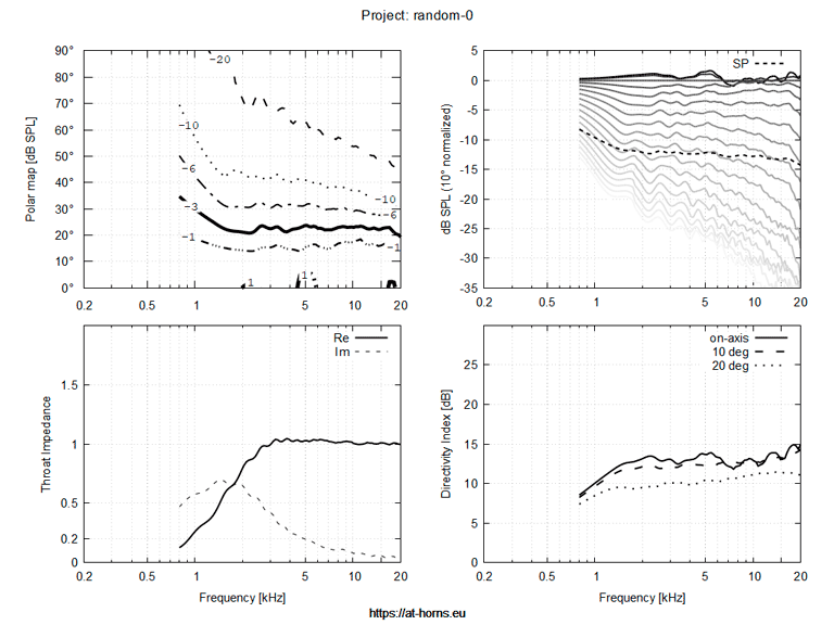

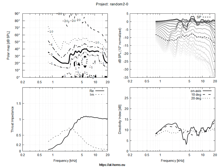

Here's a start
This is a basic 50x50 conical Horn 200mm Deep, driven by a flat diaphragm of 25.4mm cut into a 25.4mm square. As close as I can get to Rob's initial horn without knowing the depth.
This is in an infinite baffle so there is no real termination issue from the baffle itself. There are no taps just the straight CD to keep it simple.
The Spectrum results are attached below.
You can see the Difference in Radiation Impedance to an OS Horn, the polar is not normalized and in general it looks messy in comparison to the best that can be achieved, but I have seen much worse.

In basic terms the distances at the throat are small and changes there will affect higher frequencies more where diffraction is a bigger concern. As you move down the guide to the mouth the dimensions get larger which tends to move the effects seen lower in frequency.I have accepted that the simulations show that the abrupt change of curvature at the throat matters. But, I have not seen any simulation or explanation why it should matter more than elsewhere. Could you provide a reference, please?

My comments on the secondary flare relate specifically to the use of of a conical horn like seen in the simulation above. Given the ripple and general mess when terminated by an infinite baffle an angled or curved secondary isn't going to undo that but it can have a beneficial effect on the polar response as shown by Don Keele a long time ago.

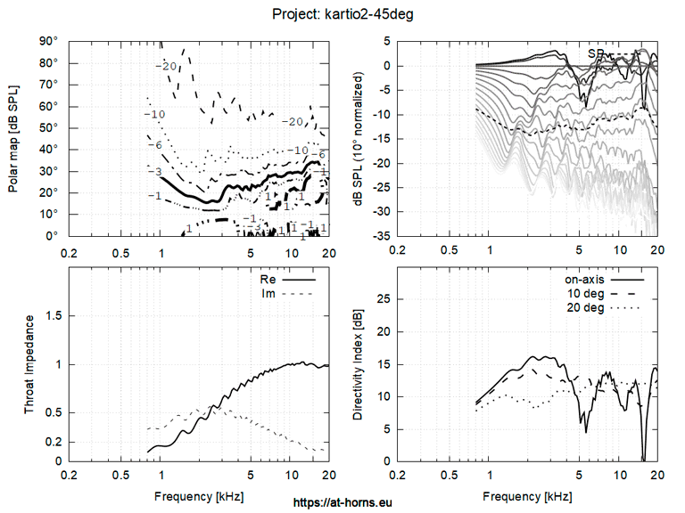

Here is what happens when you add a secondary flare at 30 deg to the main horn. Everything gets better 🙂
I hope this is some use to someone because the sim time went from 35 mins to 10 hours 😱
This is still with an infinite baffle at the edge of the second flare but it shows that it already does a pretty good job of cleaning up the majority of polar issues but does nothing for the very close on axis results. Normalized to 20 degrees looks better
This is why I said before that adding a 36 to 50mm roundover on the edge would be a reasonable way to terminate the baffle in real life and get closer to the ideal infinite baffle case for diffraction control.

Here is a side by side comparison when both are normalised to 20 degrees
The diffraction is better but the secondary flare is mainly affecting polar control. The bulk of the diffraction has already happened in the horn without secondary. Both of these are terminated in an infinite baffle so the difference is in how the shallower angle of the secondary gives a better termination.What is happening with the diffraction in this case, you are just saying is that it is better?
Given the short distance and the existing diffraction in the conical horn I don't think a smoother curve from horn to baffle will be much more effective than a straight secondary with a roundover added afterwards given that constructing it is considerably more difficult.You said before that the secondary flare might be no different to the tractrix.
