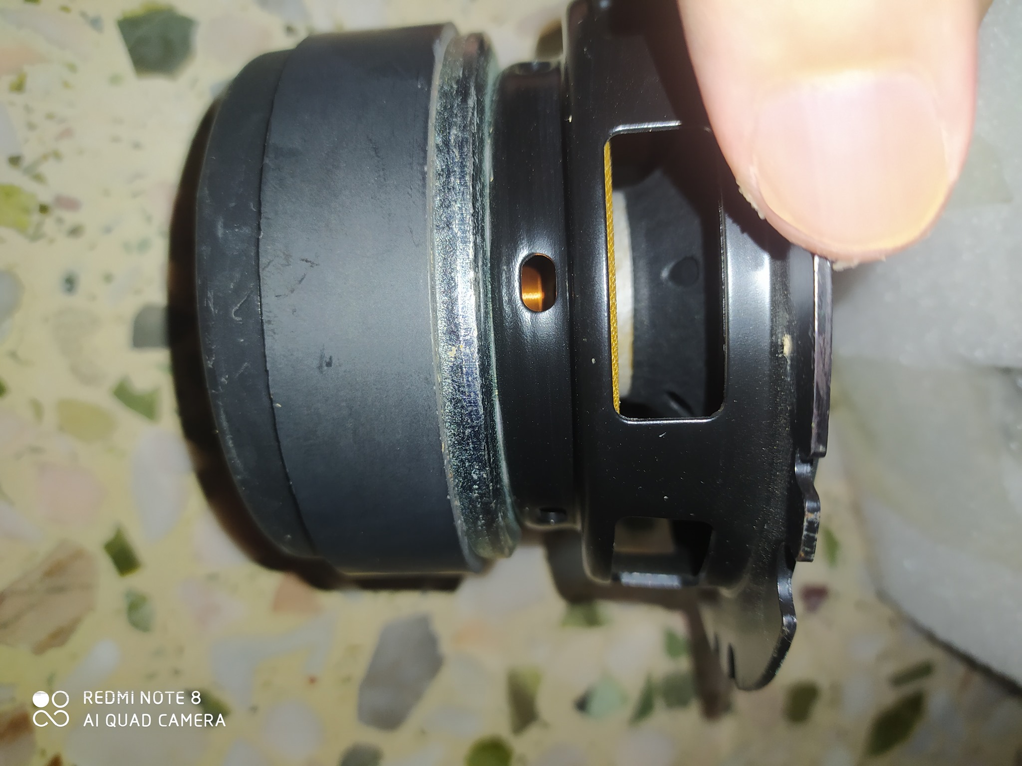

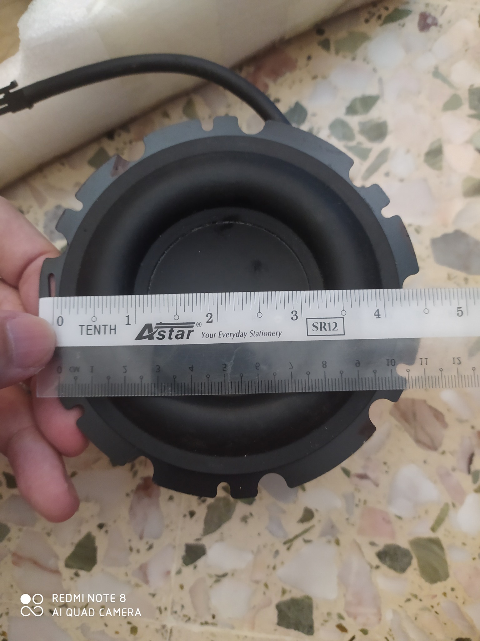

i had the same thinking and the idea as what you are trying to do past few months ... Had a pair of apple homepod 4inch woofers with lots of excursion to play around firstly attempt to use it in ported enclosure for subwoofer duty but it bottoms out too easily then later shift to 4th order bandpass the excursion relieved a little but still bottom out occasionally ... and the unit used for trial and error subwoofer duty now had a bad smell on the voice coil compared to the one keeping for spare and not used ... finally i decided to assign them as full range duty ... lesson learned ... small driver with massive excursion dont do well for bass
