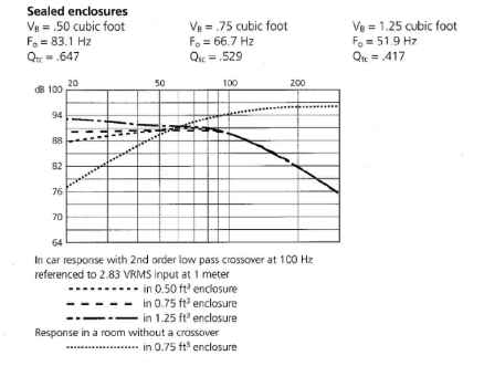

Yes, you can see the 2.83 v (a bit more than one watt into 6 ohms)sensitivity drops from ~94dB at 100Hz to ~77dB at 20Hz, a 17 dB drop in sensitivity.Also, I’ve heard that “normally” subwoofer drivers would have lower sensitivity/ SPL than the actual woofers resulting in requiring more power from amplifier or alternatively attenuating sensitivities of midrange and tweeter instead. Is this true?
Around 15 times the power would be required just to equal the sensitivity difference between those frequencies.

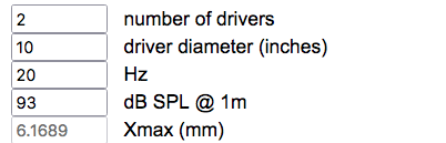

A pair of the RS10 at Xmax (maximum linear excursion, 10% distortion) could do about 93 dB at 20 Hz.
That's not as loud as one RS10 driven with one watt at 100 Hz.
About the equivalent loudness of 30dB SPL at 1kHz, a whisper level.
