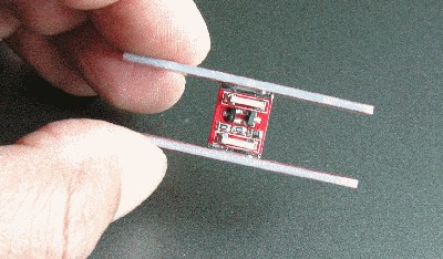

Um, i'll be using Piratelogic's stuff and of the available accelerometers, the one that suits me most, i guess, is the StarBass 54, which looks like this:
attachment.php
So it will go inside the coil, glued to the walls of the coil.
