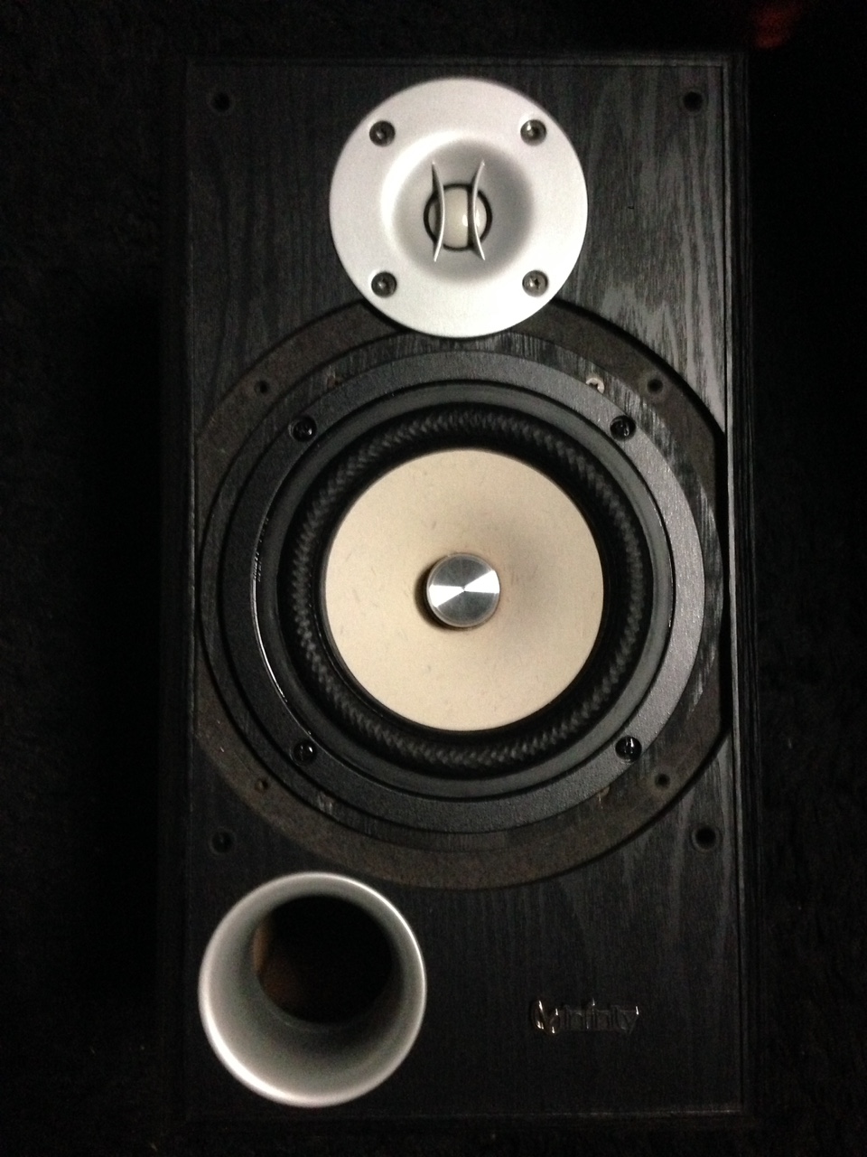

I stuck a 68ohm 5W Kiwame across the tweeter terminal, it did tame down the "ssssss" noticeably! I think I will leave it there at least for now.
You could go lower in resistance - this will lower tweeter output, raise lower roll-in point and increase damping.
The other thing to do is to add a Zobel network across the tweeter - 3.3uF//0.1uF + 8R...this will further 'tame' the tweeter.
Adding a resistor and a Zobel across the woofer will clean up the woofer also.
Like I said, experiment with resistor types....your ceramic 5W is totally failure proof but adds its own sound.
I am running externally mounted crossover, and in practice I find that 1W resistors are perfectly adequate and surprisingly do not get warm to the touch even when running 100W amp at decently loud levels.

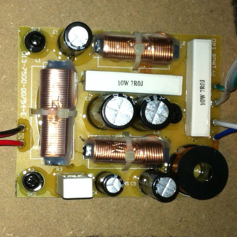

Can you post a schematic of the crossover ?.
Dan.
I don't know the circuit of the crossover, it cannot be easily removed.
The spec says 3kHz 24db/octave. The capacitor values are:
C1 100V 13uF
C2 100V 100uF
C3 100V 33uF
C4 100V 4.7uF
C5 100V 24uF
