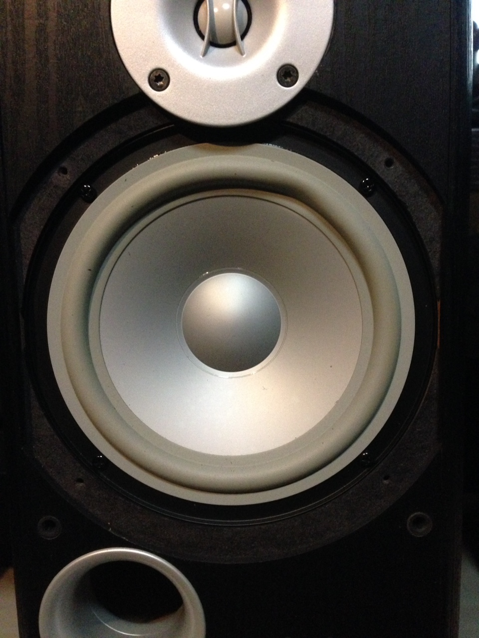

I have a pair of Infinity Primus P163. They are great for TV, but for music I find the lower treble spike is fatiguing. You can find more info about the speaker here:

I just went out and auditioned a bunch of speakers with the intention of buying one. I sort of planned to settle with a B&W 685 S2. However I feel it is a tad overpriced, it isn't as smooth as others in its price range (Wharfedale and Dali).
So I'm thinking if I should modify my existing speaker instead. It seems to have a decent box. I must stress I know next to nothing about speaker design. I thought about replacing some parts in the crossover or even the tweeter. Then I thought it may be easier to to remove the drivers and crossover and just plop in a suitably sized full range driver, like this:

The reviewer of the Infinity Primus P163 criticises the quality of the drivers and crossover but says that the box is 'built like a tank'.
On the face of it, removing the current drivers and crossover would seem a good idea.
However, at over 200 dollars a pop, the Fostex drivers may be considered to be overkill and that's before we consider if they would suit the enclosure in the first place.
I shouldn't think they would, as the Fostex drivers are designed to be horn loaded.

By looking at the tweeter, it's a really cheap one attached to a waveguide.
Your idea of changing it it's not that bad.
Challenge is : what to chose from about 100+ tweeters 😕😕
Moreover, will the crossover "fit" the new one ?
( as long as the new one has the same impedance, 8 Ω, it should...but...you'd better first separate the two paths and analyze better )

WHy ? The lowpass part is functional, the new tweeter might need just few corrections like an L-pad for reducing the output. On the opposite, a complete re-design.
An active solution implies the use of an active crossover plus two amplifiers...I would chose the simplest solution.

While your idea of just replacing the drivers with a FR is akin to stuff i have done, but the FE168e∑ is not really a suitable driver… it really wants a horn.
1st question… what is the internal volume of the box? That would go a long way to helping choose a suitable FR driver.
Also, looking at the XO in this they haven’t even uses a poly cap on the tweeter. A cheap 1st pass experinent would be to see if replacing at least the tweeter caps with even modest poly caps. That would be valuable even if you flipped the speakers and started from scratch (which would give a lot more choice of drivers).

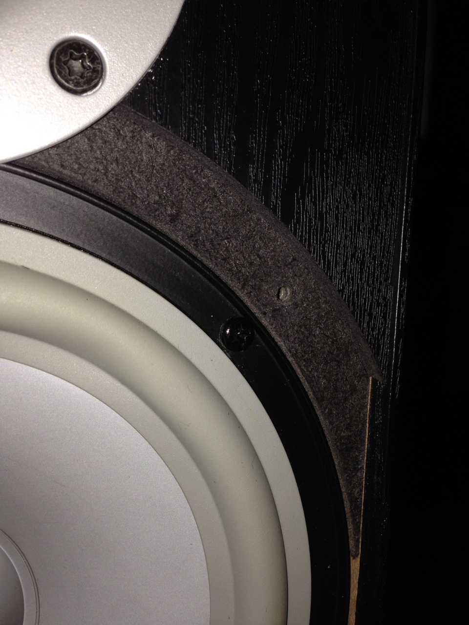

The stock driver is round, the whole of the outer rim is inside a 170mm hole. FF165wk is squarish, if the screw holes line up, some filing at the corners might do the trick.
Both the ScanSpeak and the Fostex use a 146mm cutout. If the Scanspeak has a rebate (to 170 mm) then you will either need to fill that or extend the rebate to support the Fostex basket.

The outer frame of the Scanspeak is round with 170mm outer diameter, this will fit exactly. The Fostex is squarish, with "ear to ear" length of 174mm, so the frame won't fit into the recessed hole without a little filing. Not a big deal.

Bad news, I looked at the numbers wrong . I thought 174mm is the outer rim diameter, it turns out it is the screw to screw distance. The diagram is kinda tiny.
My current screw hole distance is 162. If I were to drill the ff165wk, this would be on the rubber insert. And I would have to cut off the ears almost entirely.
If I were to match the screw holes to the ff165wk, it is even more problematic. The screw would be touching the step, so the grip will be weak. There would be holes on the 4 sides of the driver. And I won't be able to install the tweeter, so more hole.
