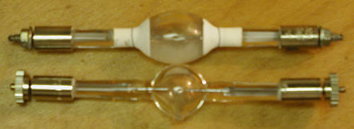

The reason they kept bulb inside is because the bulb is very hard to remove 😀 I just replaced mine. It took me a good half hour. Most of time I was trying to fit my wrench into the tiny space around the lamp housing, and trying to hold the bulb without breaking it. The new bulb has thumb screws, so next time it will be easier.
Anyway, I got the same bright dot in the center of the screen along with a bright ring about 3/4 size of the screen. it is kind of annoying. The whole thing is much brighter than the 3m 9550 I have. for example, i can see the image with all the light on (not clear though), while 3m 9550 gave me almost no image at all in the same light condition.
here is a image of the new bulb i put in. Notice it has a smaller arc and thumb screws:
