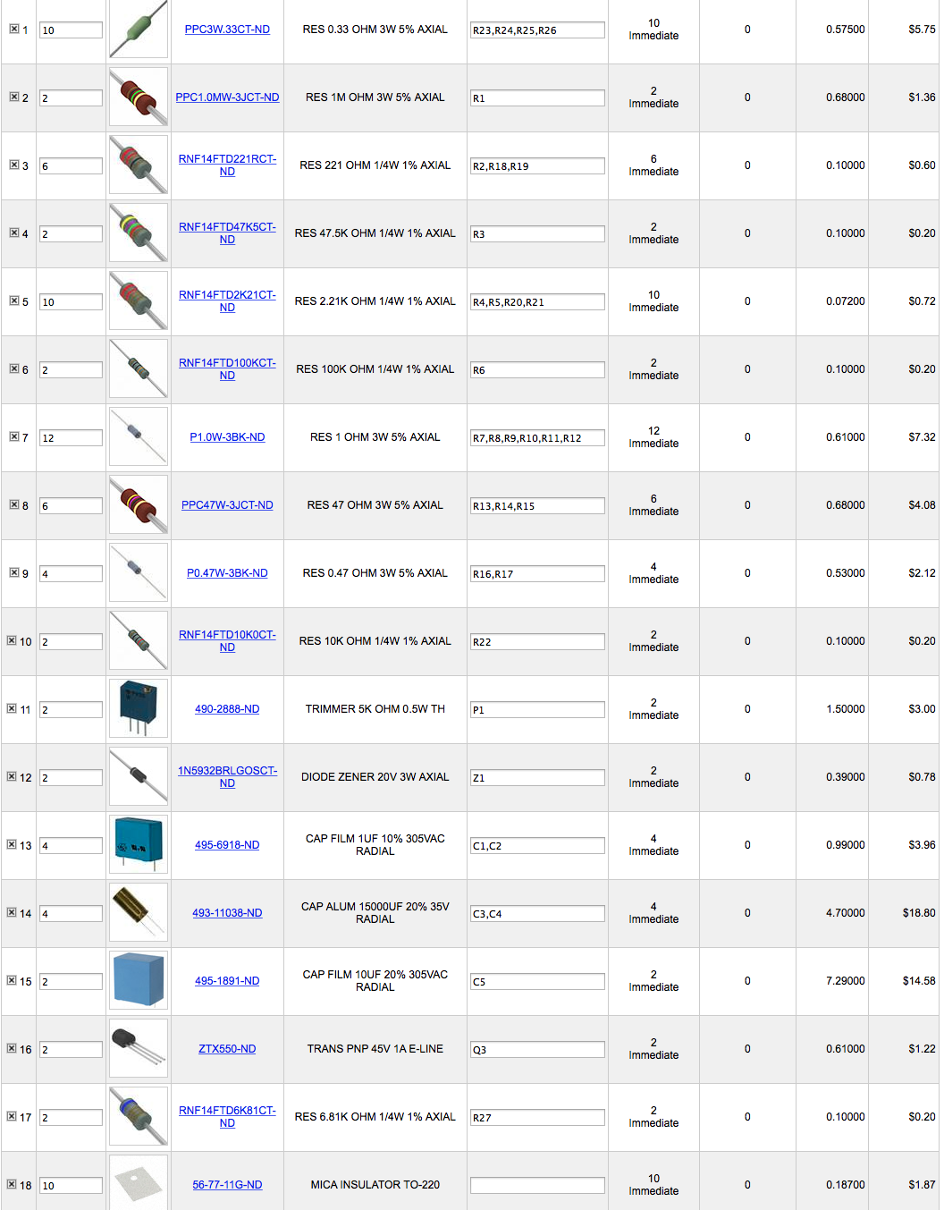

I would appreciate comments on my pending Digi-Key order. I am trying to keep my costs down, though I would consider spending a little more if it would produce noticeably better sound.

Attached is a copy of my proposed BOM to be ordered from Digi-Key. I would love to hear comments and suggestions on these choices.
You mica insulators are for TO-220 devices. You need insulators for TO-247 (bigger).
I am not familiar with the F2 but in general most people prefer Dale resistors for the 1/4w types...although it's certainly not a big deal. Same thing for the trimmer pots...Bourns is probably better. They cost a little more. Again, not a huge deal. None of the parts you specified will make or break the amp. The 1uf and 10uf caps have an impact on the sound...there are so many different caps on the market and exotic audiophile caps that choosing one is probably a whole new discussion but generally Wima is a brand that you can get from digikey or mouser that is well regarded. More exotic choices will require buying from a different supplier...Again, none of this is a deal breaker.
I'd go with dale resistors, bourns pots and maybe wima caps. Then I'd spend the rest on good PSU caps.

I had a quick look and did not see a spot for the LED. (I've built
using PD's F4 boards and he left them out there as well.)
One suggestion I would make is to measure the spacing for the
parts on the PCB and see if what you have in your BOM will fit.
PD's PCBs tend to be very compact and not all parts will fit
easily. For example, on the F4, I had to mount many of the
resistors standing up.
