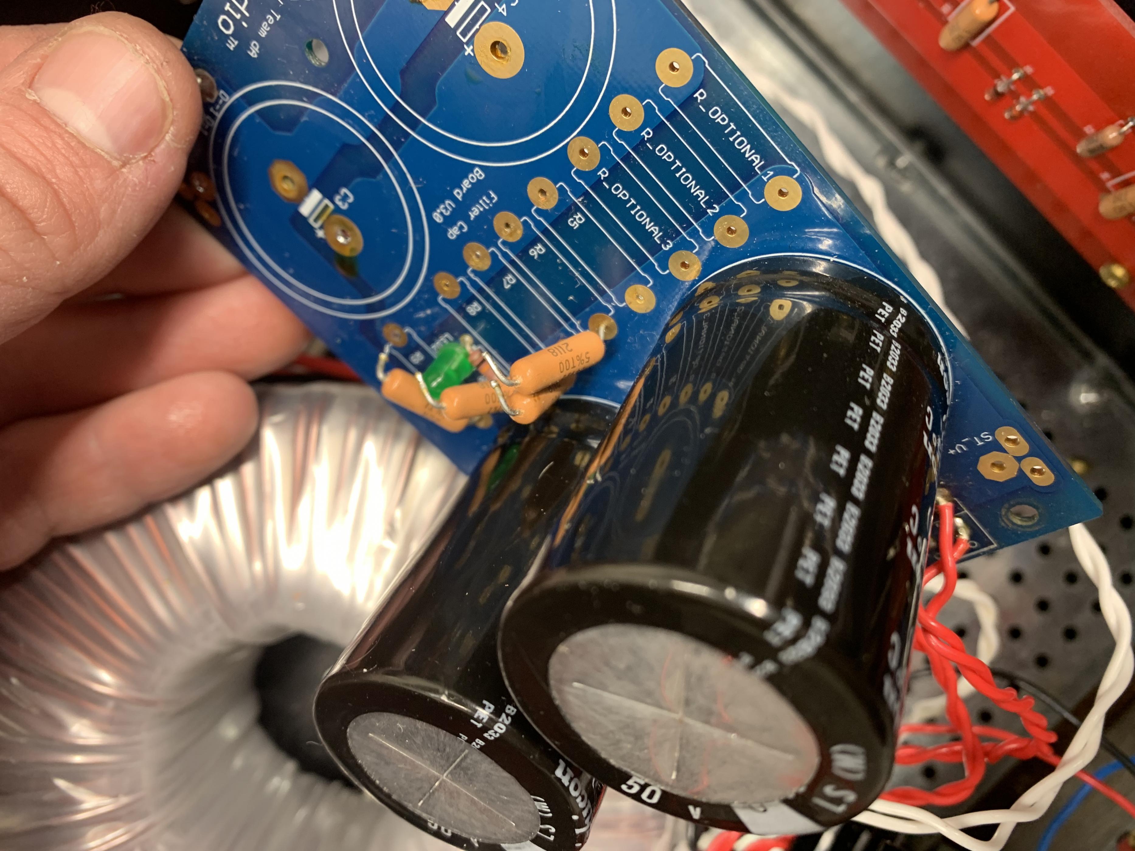

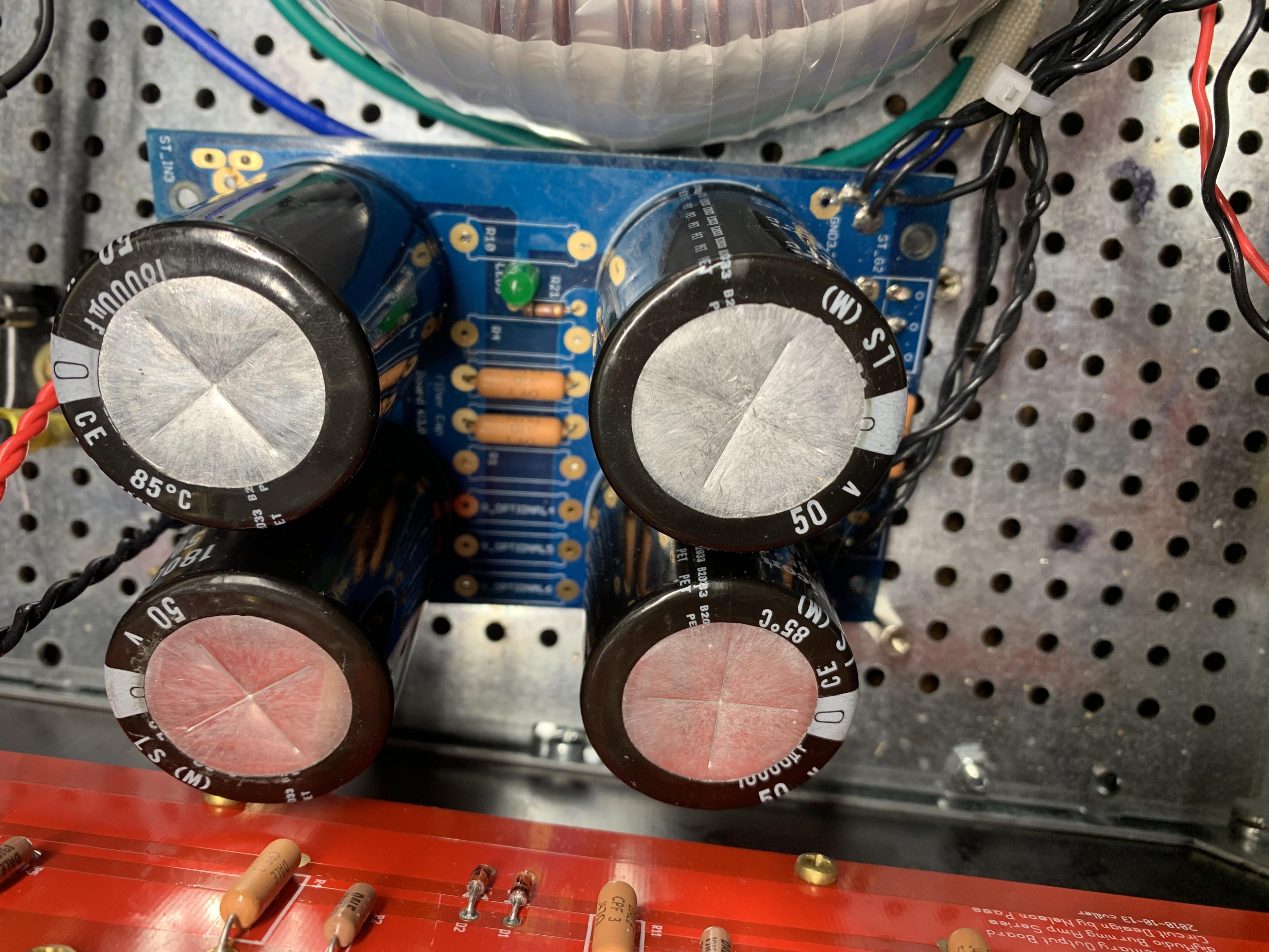

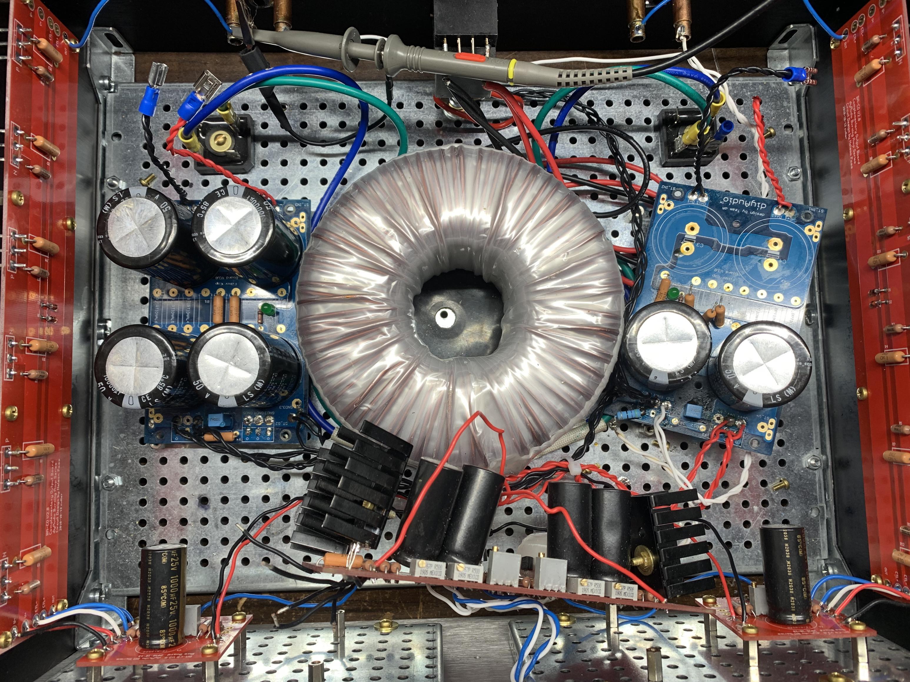

Ok, here are the crime scene photos, you sick voyeurs 😛

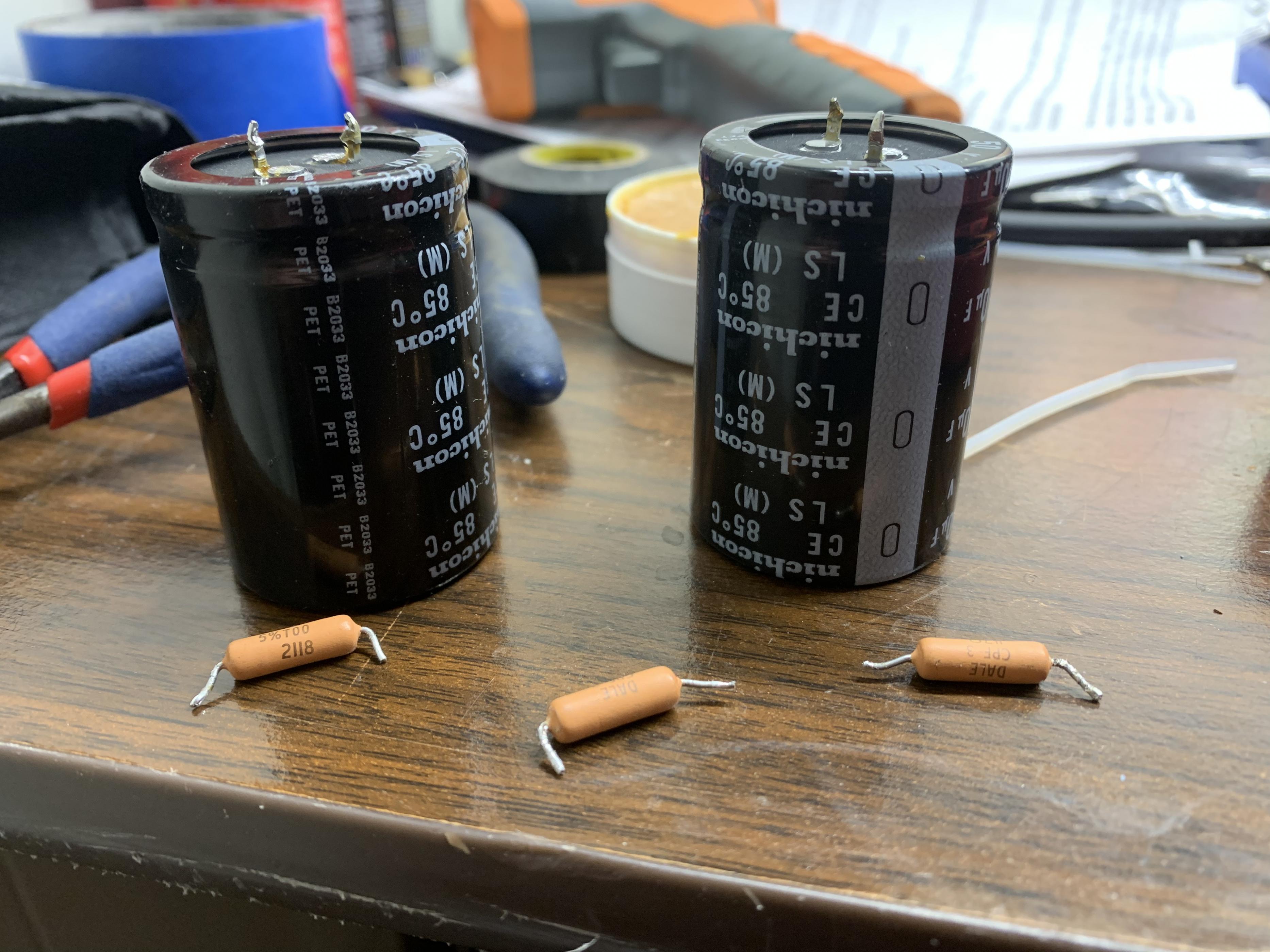

In the picture with the two caps and three resistors, the resistors all read OL.
Turns out the reason I was getting 0uF on the power supply caps is because my meter can't read over 400uF. Tested one by feeding it voltage, and it held it just fine.
The resistors between the two banks all read OL, even when completely pulled from the unit. Same result on the negative side. Could this be user error, or does it make sense that they would fail open like that?

As I said before, nothing looks burned or damaged at all.
It's entirely possible I'm imaging this situation to be worse than it is. I do know for sure that the output stopped, the light on the PSU went away, and I measured ~250mV from + to ground.

The resistor photo doesn't show the printed value (the line below the CPE3)
No colour codes on these dale 3W, just the resistance spelt out
Resistors pictured are 0.47 Ohm.
are or were ?
If it's were , replace them, check for shorts downstream and re-test
are or were ?
That is their rated value. Currently they read OL.

Clearly knackered then, they've effectively acted as fuses
Replace them and trace further downstream for possible damage ... your amp should light up again if no shorts.

Not common in plain film/composition resistors unless they explode r burn to a crisp, but normal failure in wirewound ones like those.The resistors between the two banks all read OL, even when completely pulled from the unit. Same result on the negative side. Could this be user error, or does it make sense that they would fail open like that?
Metal wire simply melts away.
Closeup pictures and/or labelling would have cleared this detail earlier on.
As you see, the "gore" pictures are actually useful. 🙂

One detail show in actual pictures but not on verbal communication:you have small TO220 or similar case supporting 6X larger heatsinks, floating unsupported.
That weight and any case movement, even putting upside down for inspection, will flex and crack those tiny legs.
Today we focus on repairing your amp, but tomorrow and not later, we correct that "mechanical" problem.
I see it´s a DIY Audio amp, perfect.

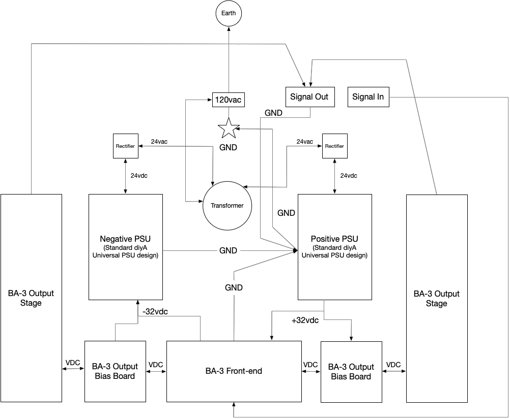

Care to post here at least the wiring/block diagram
because we´ll have to separate parts to check block by block.

In a nutshell and following the minimum damage path:
Post block diagram for better communication.

I hope this diagram is useful.

Those resistors are metal film, 3W. Are the following part:
https://www.mouser.com/ProductDetail/Vishay-Dale/CPF3R47000JNB14
Yes. Did have that problem. Reenforced legs on three with solder. Broke and repaired legs on fourth with wire.
There was no recommended part specified in the build guide, so I wasn't sure what to order, or what would fit physically on the board. So, that's what I got. If you can suggest a part that would be superior, I would happily order it.

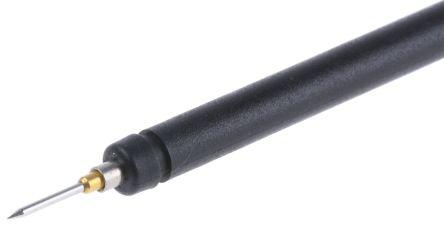

Whilst on the subject of the cause of your woes, get yourself some of Hirschmann 972318101 probes , there is a black one too..
The super super sharp ** spikes are spring loaded , so you will not slip off solder or tracks...
(They are truly **** off sharp believe me)
You will not regret getting one at least, leave the standard blunt probes you get with meters for electricians
Their only downside is the tip snaps if you stand on the probe 😀

Those probes look nice.... The issue I had was that I had a web of clips hooked up, measuring the bias across both transistors and the DC offset for the left channel front end. It was late, I was getting sloppy, and I pushed on the board making adjustments and two of the clips made contact and fused together.
