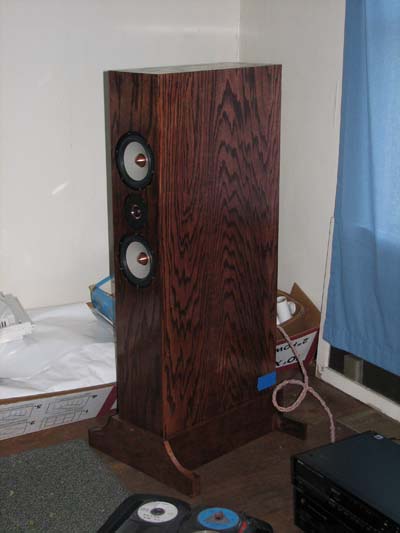

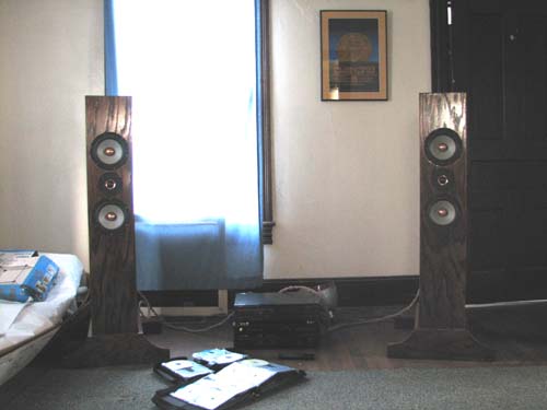

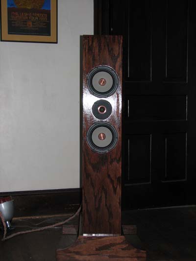

I realized that I never came back and finished this thread. My great appologies to the none of you that cared. 😉 This is (obviously) the crossover - Madisound "premium". All wires are soldred to the board, and the board is then mounted into the bottom of the box. The board is mounted to the base with strips of foam and the supplied screws. The left side is the tweeter and the right is the woofer filter. This base was left kinda unfinished as the support base will hide it.
Here is a shot of the finished speaker. They are in my dining room for now. I am working on cleaning stuff out of an upstairs room to make an actual music room. The blue tape on the speaker was used to protect the finish during transport. It will come off shortly, and really had I been thinking I would have taken it off for the picture. Duh.

They look like damn fine speakers to me. Glad they turned out and thanks for taking the time to upload your work in progress and finished results.
Since you have listened to them for some time - can you comment on strengths and weaknesses? What sort of music do they play best? What amp and source are you using?

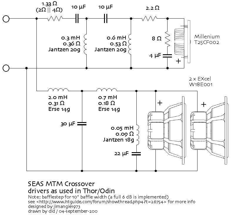

Here's an alternate crossover that I'm sure will sound a lot better than the stock crossover. http://www.htguide.com/forum/showthread.php4?t=26754&highlight=thor

Thanks Dave, looks great! I just thought I would throw in that this crossover calls for a 10" baffle and the original design as 9" (as noted in the drawing). Not a huge deal, but something to think about before anyone sees this and throws this corssover in an existing set of boxes. And I am not sure how much difference an inch makes (that's what I tell the ladies).
That being said, I would love to hear about anyone's feedback on the new design. FWIW I have no complaints about the stock crossover; but I haven't heard this, so it might be worlds better!.
