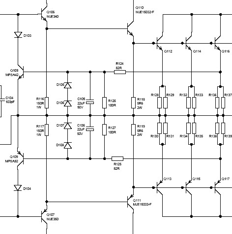

Here you got a schematic for a protection circuit as promised.
However if output impedance is no problem to you, just put in some 8 Ohms/50W resistors.... Then you are sure that your amp survives a shortend output (for a short while)
