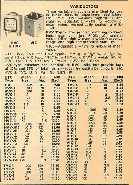

The really nice analog rack EQ's from old recording studios and broadcast equipment are done this way... I have happened upon a couple such pieces of iron accidentally, in buying whole lots of vintage iron, but the high fidelity stuff is generally really pricey. It will probably be more do-able to just order brand new, custom. That won't be cheap either, but it will be possible.
Here is a page from the old UTC catalog describing such equipment:
Of course, other manufacturers also had such things. Stancor, Thordarson, Triad, etc etc. You can search "vintage equalizer" and you'll see it can be upwards of $2k for a unit with only two coils. Not very efficient. But sometimes the coils come up orphaned, and often the seller won't know exactly what it is, and it'll be like $50. What they will see is a choke with a current rating so small that it's obviously not for a power supply... Most of the buyers will be restoring priceless RCA kit or something like that... not many diy builders going after this, and if they are I would expect that it's for a recording studio application.
The ones I have are from military com gear, used for reducing noise from mics in aircraft and other noisy locations... they are UTC, but marked with a 5-digit code that doesn't correspond to any published catalog I know of.
All of this stuff is for either line-level or low-level signal sources.
