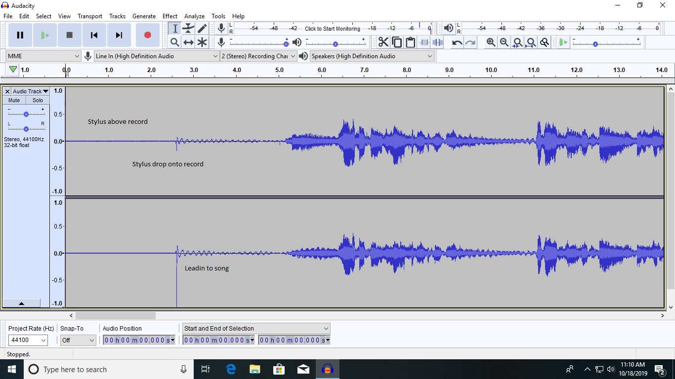

...As I understand it, tubes in general are noisier than solid state gear (please correct me if I'm wrong). The noise of the tavish is still below the surface noise of the record....
With reasonable care in system design and detail, tubes can be as quiet as they need to be.
As you say, tube hiss should be below surface noise, tube hum should be below platter rumble. No surprise, because the GE/Pickering/etal 5mV 47k phono needle convention was *designed* for tube inputs.
The earliest Germanium transistors did not beat a good tube on hiss. (With care they could be comparable, and with care the hum vanished.) Good clean devices (mostly Silicon) got hiss far below surface noise; but who listens to a system with the needle in mid-air?
Tubes and transformers go together. Both for low-Z motor loads (loudspeakers) and for low-Z sources (dynamic mikes and MC needles). Yes, you can find OTL speaker-amps and no-iron MC preamps, but the compromises are tough.
I would have to agree that, across 70+ years of hi-fi, the tranny boxes tended to be quieter, even when they became much cheaper. If price matters, a '5532 beats the pants off any tube. Even a TL072, which is only as quiet as a "good" tube in an ideal chassis, but you have to sort several tubes to find a low-hiss one, and obsess power heating and wiring to avoid excess noises.
