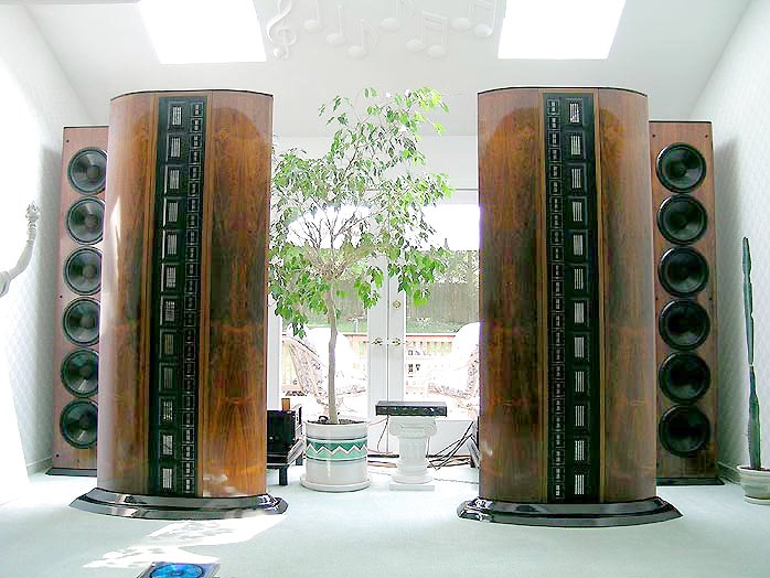

I have had a brainstorm. I'll create the love child of the IRS-V and the Quad ESL57 that the world has been waiting for. I will call it... IRS-57.
The 'panel' will comprise a 24" wide (say) curved baffle that is ~84" tall. Mounted on it will be a narrow center tweeter line (Mundorf AMT?) and on either side, butted right up to the AMT, will be a line of Neo 10s. That's right, *two* lines of Neo 10s per panel... just like the center tweeter plus flanking mids of the ESL57, the speaker beloved of all true audiophiles the world over. The panel will run down to 150Hz. Having two lines of Neo 10s on a relatively wide panel will provide more midbass dynamics than this excursion-limited unit would otherwise be capable of.
Each 'tower' will be a sealed box with six 12" AE Lambda TD12s. Simple enough.
So now we're back to a three-way, it has sealed-box bass (no fighting with dipole problems), it's a real live dipole from 150Hz on up, and it has a frightful amount of dipole radiating area between the tag-team Neo 10 lines and the Air Motion Transformers (Hair Motion Transformers? Maxell, are you listening?).
Whaddya think?? 😀

Actually it will provide *less* "dynamics" as a subjective character.. but greater dynamic/spl ability.
The more drivers you connect results in less air compression per driver - resulting in a lower sensation of "dynamics".
An abrupt change from low mass planar Dipole to high mass dynamic driver monopole around 150 Hz will be "odd" sounding.
Also, it's subjectively worth while to extend the dipole character down to most fundamentals (or about 40 Hz).. near, though not at the average.
Basically it isn't a good idea. 😱
..could I put together a dipole woofer array that would get to the mid 20s in satisfying fashion. I.e. could I get that low 3-way and leave the monopole subs out.
Yes, but again the sensation of "dynamics" will be limited. 😱

hey Scott,
Just to extend this point a little bit -- while I try to get around a 4-way system 🙂 -- what would be the primary 'bad ideas' of a three-way like I've described, but with a dipole/ripole/cardioid woofer tower rather than a monopole.
I understand your point that subjective dynamic 'punch' will be reduced with more Neo 10s, but that should also come with lower overall distortion. And the tradeoff with dipole woofers is again less punch -- but also less annoyance to my neighbors (less total power radiated for a given SPL) and potentially better pitch definition, etc.
That is, if I'm willing to trade some dynamic punch for good integration (dipole/cardioid radiation at all frequencies), lower distortion, and fewer boxes in the room, is that a trade that knowledgeable audio enthusiasts could debate, or is it an open-and-shut bad idea from a performance perspective?

Higher non-linear distortion at lower freq.s., lower degree of subjective dynamics, differing mass character transition between drivers in the mid-range - potentially exacerbated by a steep crossover.
I see it as a matter of having "it all" or having "most of it" - in either case it's going to be a series of compromises, but it's always a matter of which compromises you are willing to live with.
IMO get everything but the lower fundamental octave as "transparent" as possible in a form factor you can live with.. THEN augment it with lower freq.s.. (..your target then is between 60 and 80 Hz.)
Note that you can overcome the tactile sensation issue in a number of ways..
1. Monopole, high force low qe driver in a small cabinet..
2. Move the low freq. source much closer to you..
3. Use tactile transducers in your seat or sofa..
Both 2 & 3 can be used in conjunction with a dipole/ripole/cardiod design. You could use the nearfield sub, but instead of monopole consider a construction format more similar to Kimmo's cardiod bass rig in the KS-2125. Or, continue with a dipole "tower" array, and use tactile transducers (..and some format to limit vibration from chair/sofa leg to floor). Or.. use both methods.
