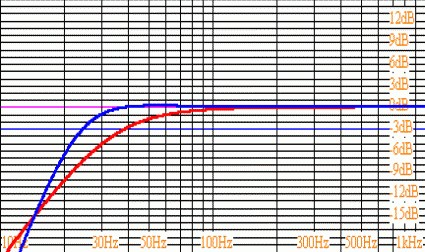

I would like some advise/help on tuning an enclosure I have built for the Shiva MKIII. The box is 6138cu inches/100.584 liters. I am using a 250w plate amp. The driver is mounted verticaly, and the port will be firing downward on to a deflection base. I will be using it mostly for movies, but want it to play music as well as possible, mostly modern jazz/classic rock/country. The room it is in is about 16' x 17' with 10' ceilings, which vault up to about 14'. There is no wall on the opposing wall of the sub. Iam not sure as to use a 3" or 4" port. I understand that if I use a 3" port, I can keep the space between the port outlet and the deflection plate a little closer? If this is true, and the 3" port will work well, then I would prefer to use the 3". My question is what freq. should i tun to (21-22hz?) and then what would be the port dimensions. Thank you for any and all help.

The red line is the speaker in a closed box of 100L.
The blue line equals the same speaker with two 3" flared ports tuned to 22 Hz in a 100 L enclosure. The ports are 19 5/8 inches long.
