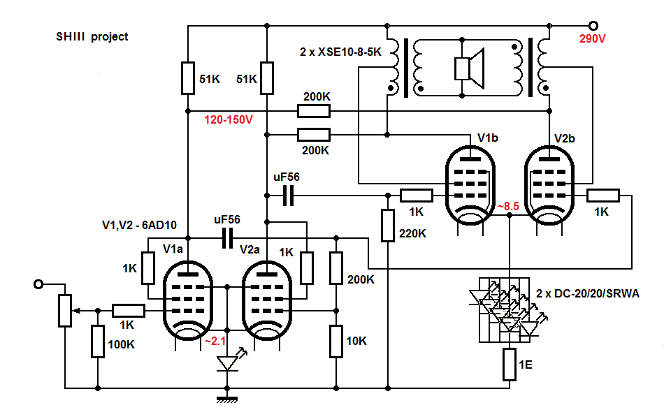

Here is the schematics, very simple:

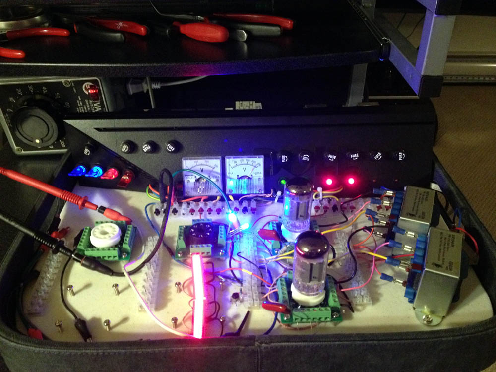

I have had it on breadboard for 3 days by now, and the first impression is not that awesome. The major advantage of DSE is the micro dynamics, m-m-m, appears (sounds) so. But the disadvantage of SE’s warming up delay kills whole impression. It takes up to 30-40 minutes for the amp to get to my-ear-acceptable sound quality.
I did not measure THD yet, could not get the Multi-Instrument software playing samples in the VM on MacBook, but with help of Spectrum Analyser the 2 nd could be eliminater to almost nil though the 3 rd remains at more or less constant level while adjustments.
I guess two things will improve its sound: the better power supply and the natural break-in. The chassis I’m gonna use does not have much space so the electronic chokes are intended.
The overall level of noise and hum is quite low even with no proper ground on the breadboard.
I’m a fan of LED bias, as you see. Some practical findings:
For the first stage the optimal bias turned out to be 2.1 V - it just sounds the best. I tried this variety of LEDs (none of superbrights): 1.65 (old red), 1.75-1.77 (modern red), 1.95 (modern red), 2.0 (old yellow), 2.07 (green), 2.1 (ancient led), 2.8 (blue), 3.45 (2 x red).
The best sounding one turned out the old crappy red one (2.1V) with glow barely seen. Same observation already noted by some forum members. Unfortunately I could not find a mate for it, so two of 2.07V greens will serve good enough.
For the output stage I opted for the LED array similar to "Redlights District" design:
The Red Light District: A 15W Push-Pull Amplifier
The recommended bias for the power section of 6AD10 is 8V. After some calculations and experimenting I found out the array of 8 lines x 5 leds fits the bill. It gives 8.71V drop with B+ of 290V and with the common cathode current of 69 mA - quite perfectly aligned. If one tube removed the current drops to 41 mA - not by half but relatively safe for one (the max current in specs is 39 mA, but these species are somewhat little stand-ups, and that won’t actually make a damage).
Here I want to mention why not a CCS. The output stage has the CCS in the original design, but I do not like a fact that the double current will run through a single bulb if one of two breaks or missing, and turns it towards garbage bin very quick if neglected.
Another my point is, well, we want it be biased at some constant, and the LED array works like a Zener here, except it has much lower dynamic impedance, hence no need of Blackgates caps )) to shunt the bias network. Do not try to waste blacks here as they would make a rather marginal difference, very opposite to resistive bias.
So for the LED array I opted for the DC-20/20/SRWA bar, hoping to get the consistency of the single LEDs and that turned out to be true. Much easier to mount as well.
The SHIII amp does not require any tuning up as long as you match the pairs, here is how. While having connected the only first stage’s networks - plug in any two and measure the plate voltages, mark them. You can get the range between 100 and 160 (Volts). It does not matter if the measurements were made with unmatching ones - the V value will remain close, you will see. Then just plug in whatever you found like 150 & 146 and 134 & 128 pairs and you are all set. Technically, I did not see any problem of having a pair of e.g. 121 & 152, they do work. The imbalance can be further fixed by adjusting the 10K resistor (I figured typically +/- 5K) by min of the 2 nd or the 3 rd HD, whichever you prefer.
The B+ value is not critical, the amp remains operational with the range of 200-300V, but 290V is the optimal.
The max output I got is 18V peak-to-peak, or 6.3V RMS (as by oscilloscope) on a 7.8 ohm dummy load.
I expected more, is it all I can get? suggestions are appreciated.

There is something wrong with this circuit 🙁
Schade feedback doesn't go together with this kind of fase inverter.
You get hum and other undesirables from the power supply in the output.
Unwanted noises from the power supply gets to the grid of the final stage.That same signal is inverted and fed to the other grid, canseling the same noise from the supply.Result is an uneaqual hum on the symetrical power amp, it isn't cancel out any more.
I sugest an other fase inverter, like this.

You mean 200K resistors from output stage plates?
I made it without them first. It was more noise, louder hum, a little more distortion. The gain was excessive to what I need, the sensitivity was 0.3V to full output.
Adding 200K resistors made, I would call, an improvement.
Oh, I didn't notice the 1K resistors from plates to grid2 of the input tubes before. So they are running in triode mode. The +6V boost on grid3 won't make any difference then.
Wiring the input tubes as pentodes is the usual practice for a Schade type plate feedback (for output tubes). Some RC de-coupling from B+ for the input tube plate resistors might help. But Schade feedback is still referenced to B+. Unavoidable hum, unless one puts some P-channel Mosfets up top to send current only down to the grids. Another approach is to put the OT secondaries in the output tube cathode circuits, CFB, then send feedbacks from the output cathodes back to the driver cathodes via resistors (crossed).
"I am more interested in better linearity."
The triode configured input tubes may be the main cause of the non-linearity. The triode Rp varies with current, yet it is part of the divider network for the Schade Fdbk resistors. Could put Mosfet followers, with a series resistor, after the 1st tube stages.
Or crank up the idle current for the triodes so Rp is more constant. Not a good choice with dual control pentodes however, since most of the cathode current gets returned to grid2. (unless you put the +6V on grid3 to fix that)

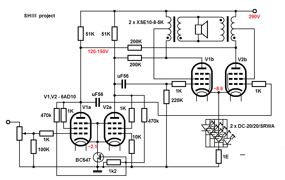

Ketje, the suggested phase invertor works well. I adjusted the 1K2 to + 200, and it sounds cleaner and aery. The voltage drop over BC547 (I used 2SC945) is 2.05V.
You left just one, but I assume both 220K resistors in power sections' grids are necessary.

The hum you can get with the original circuit doen't come from the supply of the first stage.It comes in via the Schade feedback resistors.
With the transistor the circuit is symetric and hum on the supply is allmost canceled out.
The 1k at the transistor was to get ~130V on the anodes, now you have 10...15V less I suppose.If that sounds ok, why not.

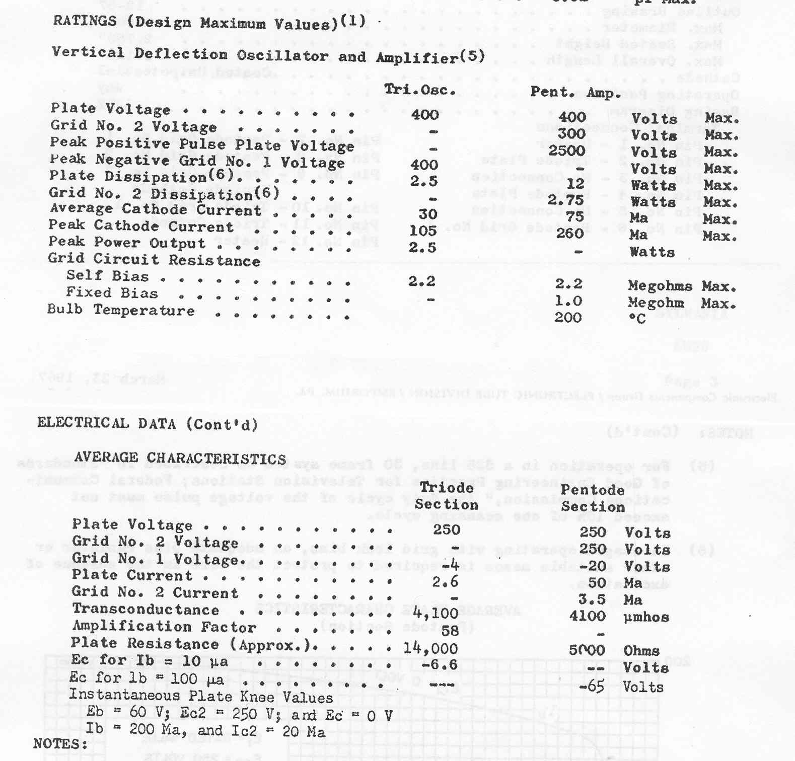

0V on g3 repels a significant portion of the cathode/plate current back to grid2 (6AD10 input, tube section 2), causing the rounded plate curves on the datasheet. Putting +6V on g3 lets most of it get through to the plate.
For triode mode, you could just connect the g3 to the g2 of each input tube as currently done.

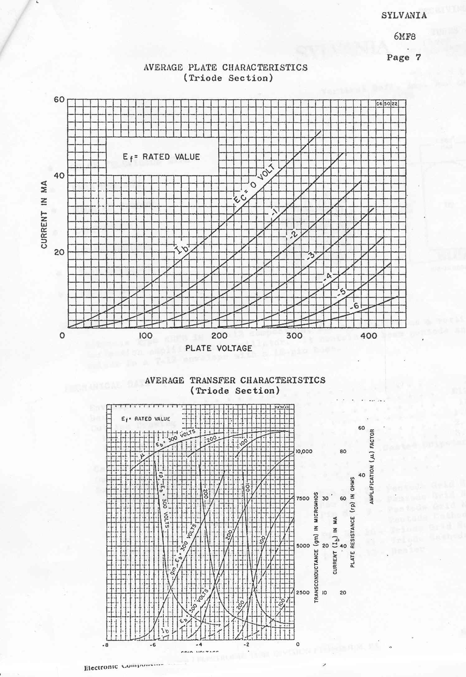

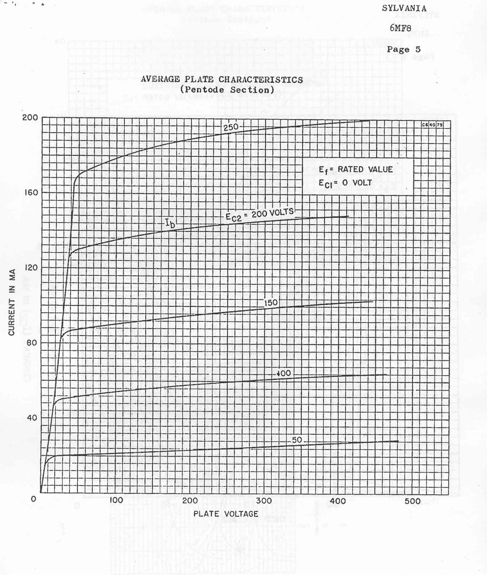

I just noticed that 6MF8 is on the $1 list now. Another tube you could try out, that has a normal driver triode. Although a rather different pin-out. Not that it is any better than 6AD10A. (same as 6LU8 pinout) Data: (6MF8 output stage has 2/3 the gm, but input triode has 1.5X the gm of 6AD10A)
Summer Dollar Days - Vacuum Tube Sale - $1.00 Vacuum Tubes
https://frank.pocnet.net/sheets/084/6/6MF8.pdf

For this (same, I guess) reason the CCS tail does not work here, it forces the drop over the cathode resistor down to 0.075V (instead of 2V sweet-spot)
Schade NFB sounds a great improvement. It halves the sensitivity but makes the amp better balanced by giving it fat bass.
Ketje, that divider on the out of the leftmost V1a valve was not a mistake. Though looking wrong it sounds quite sweet, better than V2a's g1 reference to just ground. If to ground - the sound is rather towards silicone. With that divider I get 3 rd HD almost disappear on 5V RMS, plus it gives approx. 30% boost.
That divider gives V2a the signal+ hum from anode and Schade resistors to make the inverted fase.
With a CCS in the cathodes the signal commes in via the cathode of V2a, no extra hum.
The transistor of the CCS pulls the cathode down until -Vg1 is right for the anode current to give the proper anode voltage (drop on the anode resistance)
If Vg2 is to low to even get the nessesairy anode current at Vg1=0V the transistor goes in full conductivity in an effort to turn up the current.
