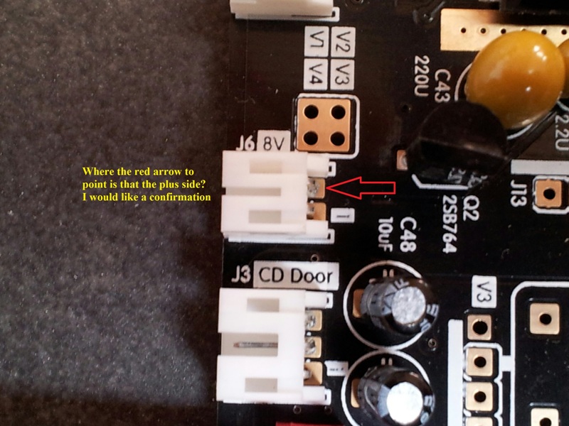

Where the red arrow to point is that the plus (+) side?
I would like a confirmation because I make my own black and red cable.

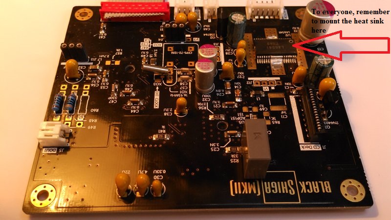

To everyone, remember to mount the heat sink ...
