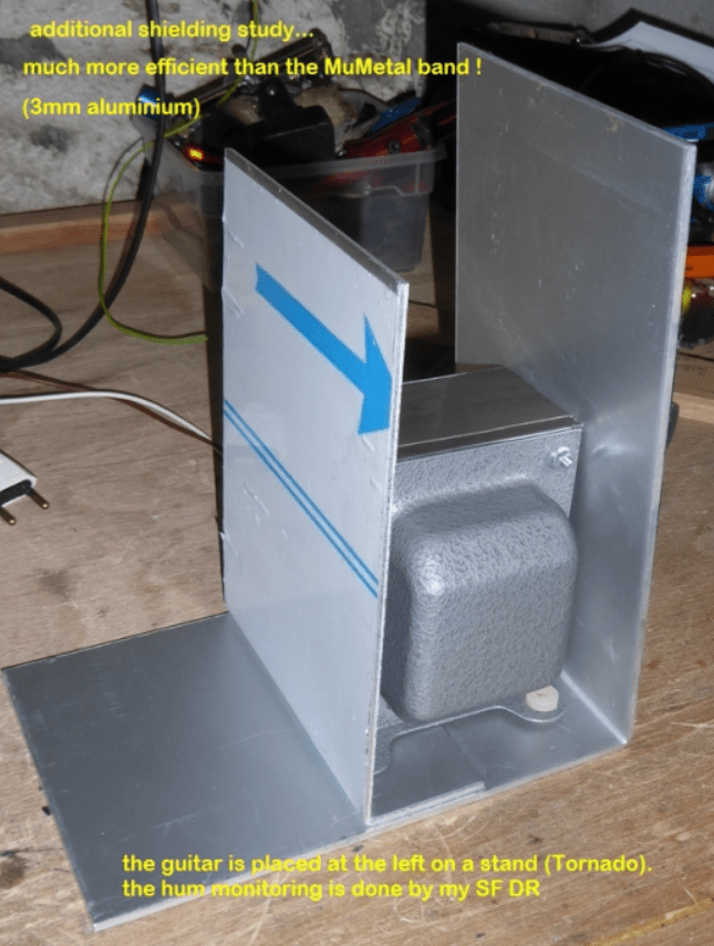

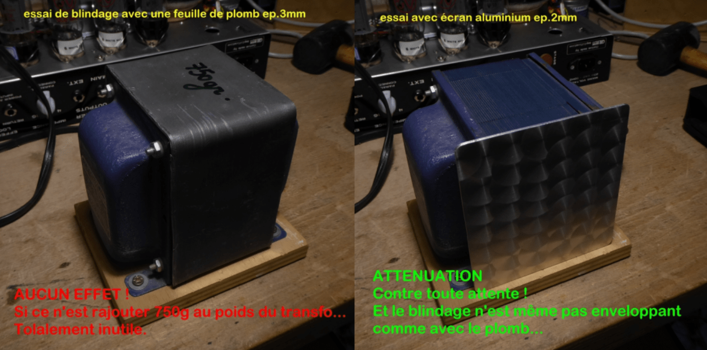

Then I shifted for a good old but brand new EI transformer, after making some magnetic and electric radiation tests :
I tested 1mm steel and 3mm lead covers, and 2mm aluminium plate, even µmetal 0.2mm foil, to discover that steel, lead and µmetal were useless, while a simple 2mm aluminium plate could cut with great efficiency the radiations... To my great surprise !
In the meantime, I called my colleagues at ALSTOM Transformers Division, and they usefully instructed me about the toroidal pro and cons, vs. EI transformers, plus the virtues of aluminium sheilding !
So I went for this solution below :
The EI PSU transformer has been suitably orientated for minimum influence, plus I installed two 3mm thick aluminium "wings" to cut the magnetic radiation from the core. I also installed a copper flux band around the winding to prevent electrical radiation.
Result : complete eradication of the noises, no more influence on the circuits, on the speaker or on any guitar, no matter the amp settings !
So yes, aluminium is efficient against hum and buzz radiations... Despite what many people say !

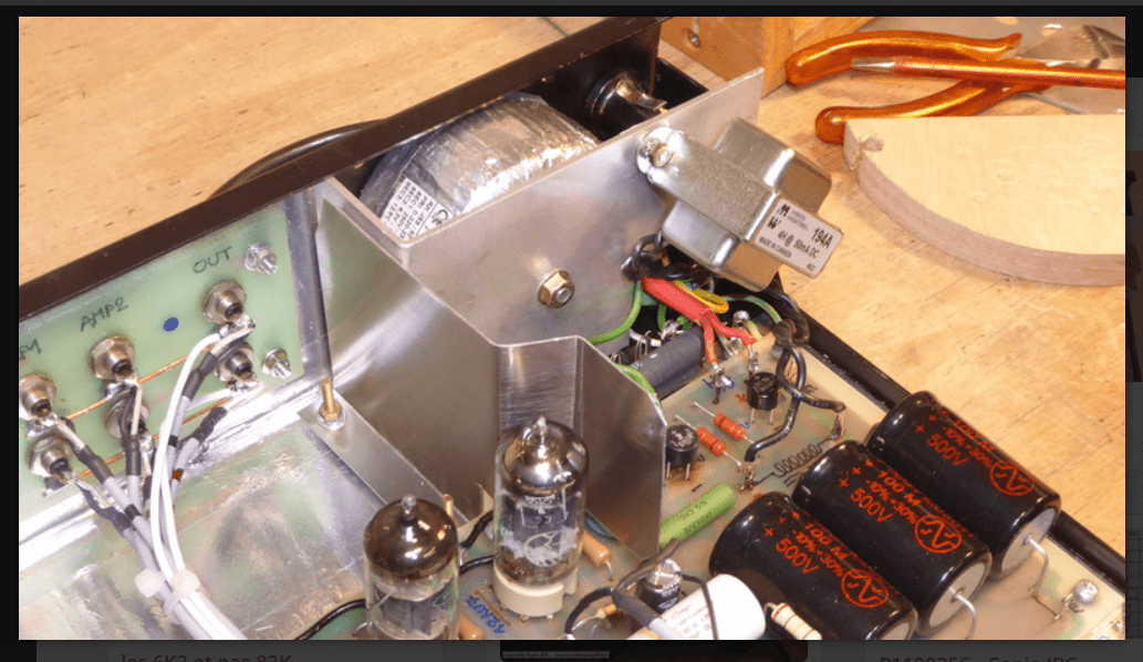

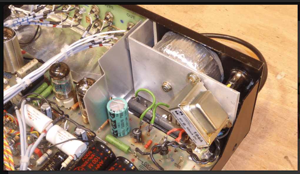

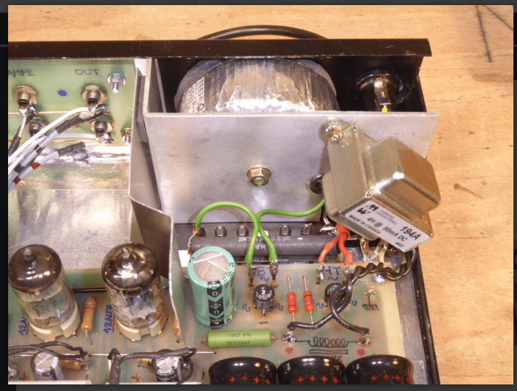

Another successfull example below, this time about a tube line/phono preamplifier - more in your field of application, @myleftear :
I firstly installed the toroidal transformer without special precautions, but nonetheless as far as possible of the circuits. Again : welcome to the unbearable hum and buzz world !
C'est bon, cette fois j'ai compris... Then :
The toroidal transformer is primarily encapsulated with 3 layers of aluminium conductive-adhesive foil, then placed behind a 2mm aluminium screen, plus an additional separation 0.5mm screen between the supply and the output tubes, all grounded. The chassis base, back and frontface bottoms have been covered with the same adhesive aluminium foil, in order to offer a continuous ground plane :
Doing this : I took great care not to short the transformer by the center screw and the aluminium shield, by creating a short-circuit buckle or turn.
Result : dead quiet preamp at any setting, complete eradication of any hum and buzzz... So yes again : aluminium is effective against perturbations.
In my next tube preamp build, I will go for the double boxing solution : the audio circuit will be completely encased in an inside Hammond aluminium box, with just the tubes protruding on their sockets and tubular locking shieldings. And for the PSU transformer, at least there will be screens if not a complete encasing.

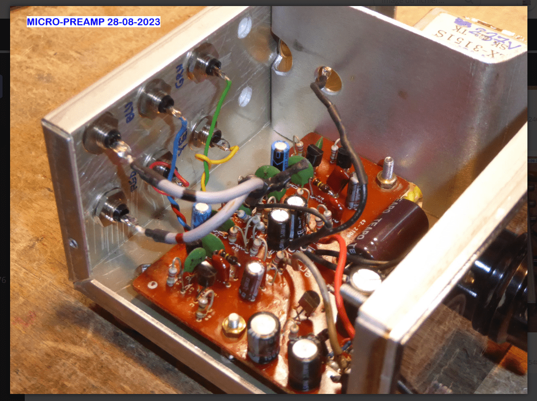

For those who still think that I am a fool, I'll take another example : my Micro-Preamp , a small Solid-State unit...
As you can see below, there's an Aluminium 2mm shielding that divide the small Aluminium casing in two parts :
A the start, this screen doesn't existed. I only relied on the fact that it was a SS circuit and that the transformer was far enough away from the circuit. But as is, there was still a light hummandbuzz remaining.
So I added that 2mm aluminium shielding as shown above and Voilà, Merci, Au Revoir : no more noise disturbance, dead quiet operation.
T

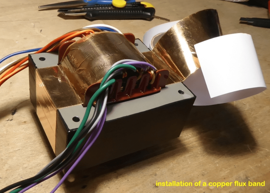

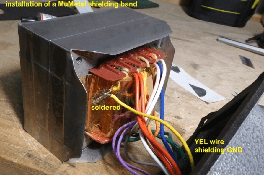

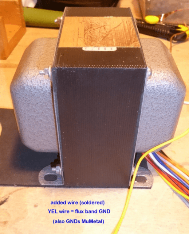

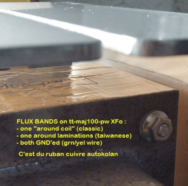

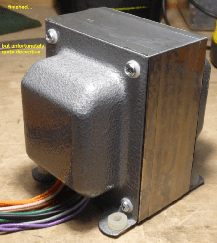

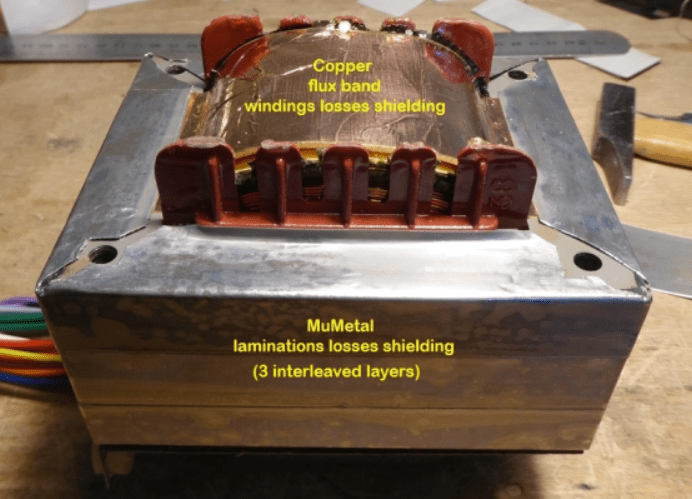

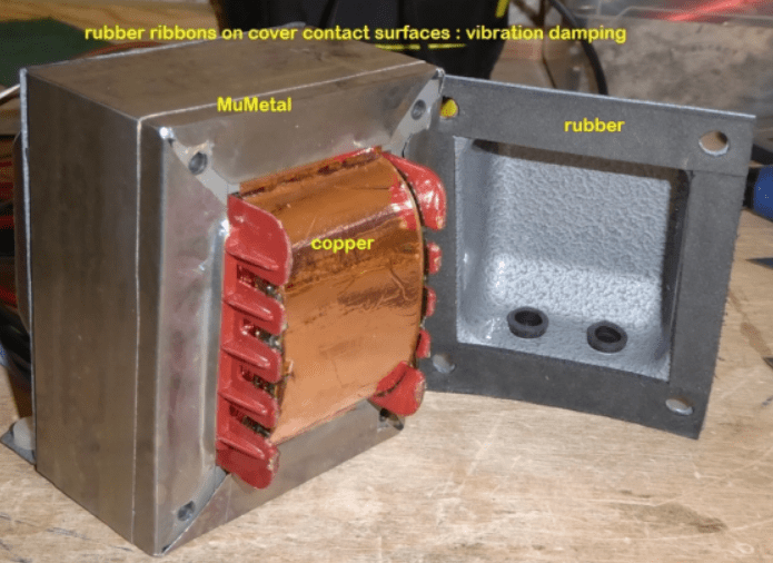

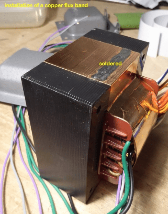

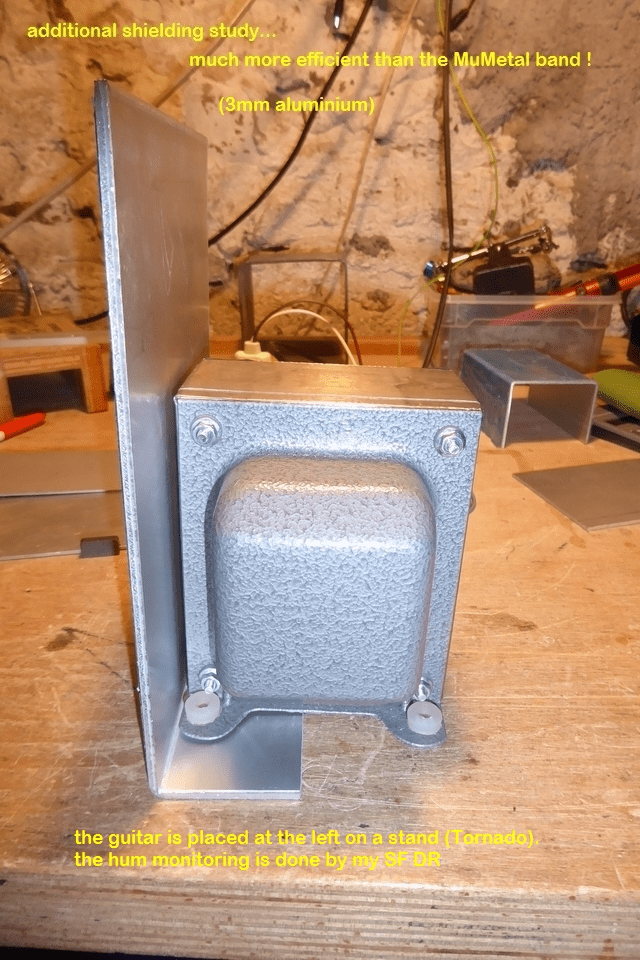

@tubelectron lovely builds! Would you happen to have any pictures of the fluxbands you created for the EI type transformer you mentioned?
Thanks @WntrMute2 ! Here you are :
I experimented µmetal also : I lost my money and my time for null result...
Only the aluminium proved efficient :

But, about these circulating currents, I assume they occur by the chassis picking up some radiation?
The stray fields generated by the transformer cause eddy currents in every part of metal around. When the transformer is just mounted on a plain, uniform conductive plate, like aluminum, the eddy currents die away relatively quickly, and so do the secondary fields and disturbances they cause (must be something like the inverse of the cube of the distance or even -4th power, I don't remember).
However the mounting plate and various accessories are rarely uniform and homogeneous, and this can funnel the disturbances in a precise direction, with a surprising intensity, as the demo setup shows.
To have ~500mA of eddy currents generated by such a relatively small transformer, you would have to be seriously unlucky, but only one tenth of that is already sufficient to ruin your day and your listening experience.
Note that although free-floating random pieces of 1 to 3mm aluminum have a relatively small effect on 50/60Hz fields, they will cause some distortion/deflection of the pattern, and if you are lucky you can have a small zone of cancellation happening to cover just the sensitive area you want to protect.
You cannot rely on luck or deterministic methods to achieve such a result: it is too improbable or complicated, like most magnetic problems. You need to experiment a lot, moving various parts in a convergent way, to end up with an acceptable result.
Of course, there is the proven, brute force method: first, distance, distance, distance, and then heavy mumetal shielding, for both the perturbator (transformer) and victim (sensitive circuit), but it is costly and requires tailor-made shields
