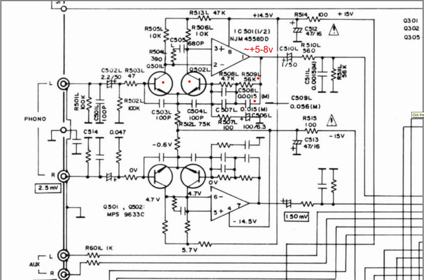

I've got a Sherwood S-2620 CP stereo receiver on my bench right now. It's not worth much, and probably not worth my effort, but I feel compelled to get it going. Figured this would be a good learning project at the very least.
It was functional when I put it storage several years ago, but now the phono stage has an issue. When pulled from storage the right channel behaved normally, the left channel has no audio signal but the left speaker pulsed in and out about twice per second with a loud clicking. Sounded like a heart beating. This only impacts the phono channel, CD/AUX, AM, and FM, all function perfectly. So the issue is within the phono eq/pre-amp portion of the board.
The dual opamp IC was faulty (TA75558P was on the board, different from schematic), pulled it out, popped in a NE5532AP as a replacement. All I had on hand. Right channel continued to function, left channel no longer pulses, but is just silent.
The left channel electrolytics have been pulled, and are confirmed to be healthy. Both Q501L and Q502L tested perfectly with a Peak analyzer when pulled from the board, so no issues there. Rail voltages appear to be normal. The ceramic caps all test OK. Replaced R505 and R506 just to rule that out. No improvement.
Kind of at a loss here, any suggestions on what to check next?

The electrolytics may have started drying out, its 40 years old or so - in particular I'd suspect C506L and C510L

The electrolytics were replaced a few years back before it went into storage. I pulled the ones in the left channel and verified health just to rule out any early failure. So all checks out there.

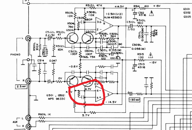

Not sure how 😀😛.......🙄
Right half of the dual opamp IC survived apparently.
I would check all switches in the receiver, first.
Switches and controls have all been verified. I wish it was that simple with this one.
You missed the point/joke, take a look at the circled area in my attached circuit
Ahhhh, I see now.
Motorboating. I would look to C512 C513; I can't know if these are in "left channel electrolytics".

Took a few days off from this to come back to it with a clear mind. Things are a bit weird here, but still trying to find the source.
Pulled C512 and C513, both test OK.
—Prior to replacing the failed opamp, the voltages were as follows——
The base of Q502L had measurable voltage on it slowly varying from .001VDC to about .380VDC. The base of Q502R had 0VDC.
Measuring DC on the phono signal path at the input selector switch, volume at 0, the right channel showed 0VDC, the left channel gave slowly oscillating values ranging from -7.5VDC to +7.5VDC.

How can you state the rail voltage is 11V and then say it's -8.2v and +8.4v ??
The IC is either damaged or the PSU is, it's being pulled down to ~8v on both rails.
The rails should be closer to 15v (+&-) as indicated by the schematic.
Remove the IC and check rails again
You replaced like for like ? , and it's in the right way round ?
Original IC was a TA75558P, schematic spec'd a NJM4558DD. I swapped in a NE5532AP dual opamp I had on hand to test with, figured this wasn't an issue since the right channel continued to function with this IC.
The rail voltage was measured on the posts where the power supply reaches the board, so the voltages at V+ and V- on the IC are dropped with the IC installed.
With the IC pulled pins 4 and 8 in the socket measure roughly -16VDC and +16VDC. As do the posts where the power supply connects. So the voltages are rising to normal levels with the IC pulled.
I found a 4558D JRC in my parts bin, popped that in. Still no left channel audio, but pins 4 and 8 are at 15.5 VDC. I guess I'll use that for troubleshooting going forward.

I'd flip both transistor pairs to the other channel (now that you've replaced the obviously faulty or incorrect opamp) and retest
Alright, I found the problem. Got too tied up looking at this darn IC I totally missed something obvious.
