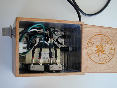

Nope, my CT transformer had no wires coming from it, either on the primary or secondary side. The connections were via quick connect. There was only one tab for the CT.
I crimped a single wire into the quick connect that connected to the trafo. I ran that wire to a euro style terminal strip. I came out of the terminal strip with two wires which I connected two wires which I connected to AC1N and AC2H.

are your diodes all oriented the same way? (heatsink side up.) i can't quite make that out.
also i see four wires on the tx side of the right terminal. but the second green i see is just the loop you made so the CT would have two outputs, yes? this would be as you have described and drawn before.

I tried a couple ways of hooking things up using the CT trafo and this one worked just fine. I have no idea why as other seem to think it shouldn't.
All the diodes are installed the same way.
Exactly right about the green wire. It goes from the CT on the trafo to one position on the terminal strip. I looped it to the other position so I could run two leads to the board.
I took the output from the board- (V+, PG+, V-, PG-) to that 6 position Molex connector. I also connected my earth/safety ground (green wire in the three conductor AC cord) to it and one position is unused. Five wires make up the umbilical that runs from the PS box to the amp box. The chassis ground of the amp box connects to the same point that the safety ground goes to.

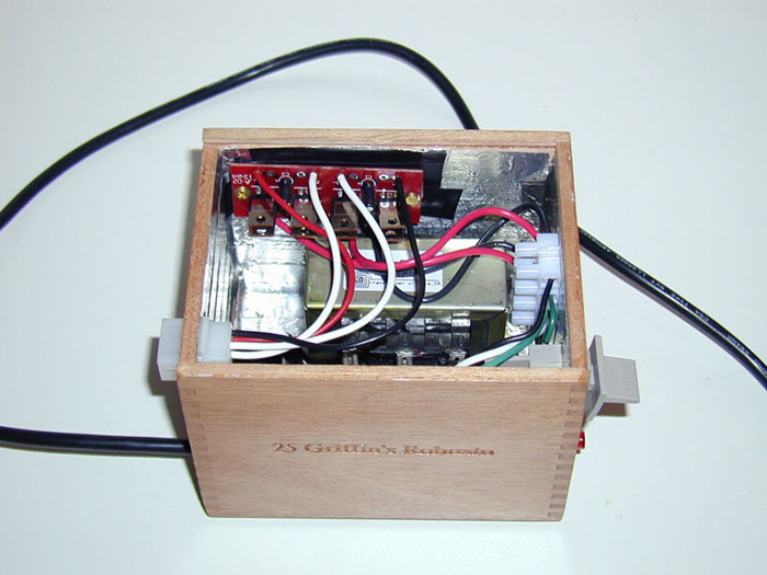

I actually also hooked this up using two bridges as well and that setup worked too. Here is a shot of that before the wiring was completed. (I had to add my own caps of course and in the end the board that Brian supplied was smaller and easier to mount so I went with it.)

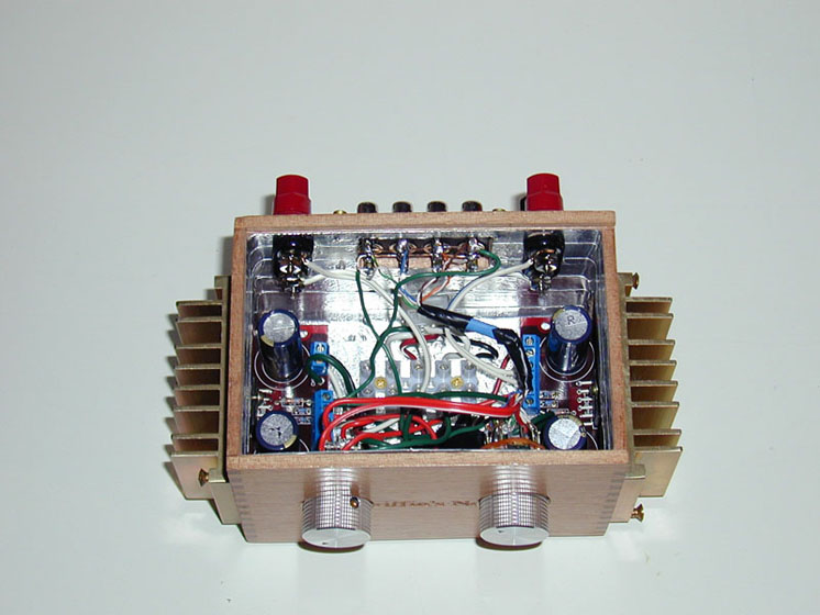

Good question, no one else has asked it. Attached is a pic of the finished amp case interior. It is sort of hard to see but I connected the wires from the Molex connector to another terminal strip inside that case. I then connected two wires into the other side of each position of the terminal strip. I then ran one of those wires to each amp.
Long explanation short, yes, both PG+ and PG- run to both amp boards.
