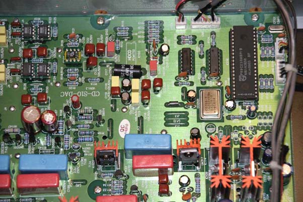

I purchased beauthiful player Sheng Ya cd-s10. But I found sound little not bright... And I started my work:) .Cheap no-name electrolitics was changed to Balck Gate p-k,Black gate n,Elna Cerafines.After long testing I stopped on following config:
2xad825 in i/v section,8xopa627 filter and pre-tube.Cheap tube was replaced with Elektro-Harmonix Gold edition. Now sound is so perfect,it kill denon 2910 in sacd mode easily.... Even pcm1732 can deliver excellent sound!!!Now I have player sounding as many models for 3000 euro.

Here is photo
