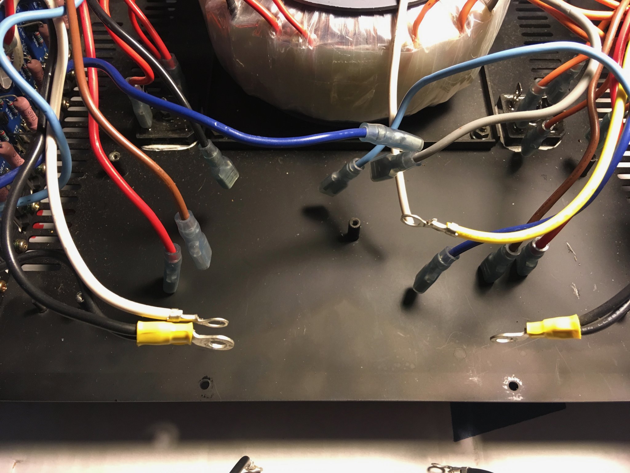

Here's a picture of an old Adcom 5400 amp which I recapped: Note the two round circles of oil originating at each of the two diode bridges, showing that the oil runs out way farther over time (20+ years in this case) than the oxide particles, which more or less stay in place.

Yes, it is grease which flows away under pressure and thermal cycling, not the solid oxides as somebody suggested earlier.
