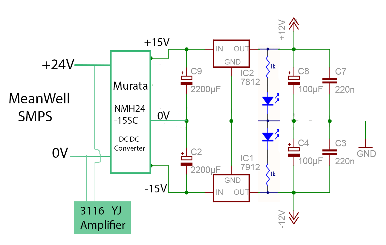

OK, thanks for the guidance. I feel I'm getting somewhere but could really do with some advice. I have comprised a circuit to allow me to tap a dual rail supply form an SMPS that will also be powering the 3116. The dual rail will supply a simple NE5532 LPF.
I understand the reasoning behind the LEDs providing some drain so the DC DC converter sees some load but I have simply guessed where they would go in the circuit. I have also added further regulation with the use of the 7812 and 7912 but I have no idea if this will work or even if it is necessary?
My proposed circuit is attached below.

Thanks Dug, you don't think I've over complicated it? Do I need the 7812 regulation or could I just use a simple LC filter after the DC DC Converter?
Also, do I need to ground the 3116 board?
Stu
Stu
C2 and C9 should not be that large.
47uF is adequate.
Some DC-DC converters will shut down ( or just not start up ) with large capacitive loads.
Grounding
This is a function of safety.
I think it is a good idea to connect the GND of the output of the power supply to safety GND. (wall outlet GND)
One place... Research "star ground" theory.
The DC-DC GND (or common) goes to the pre-amp or op-amp board.
The output and GND from the pre-amp or op-amp board connects to the 3116 board along with the audio signals.
Do not attach a second GND line from the DC-DC converter to 3116 GND or star safety GND.
This is multiple ground paths and can create what is called a ground loop. Research that.
Hope that helps.

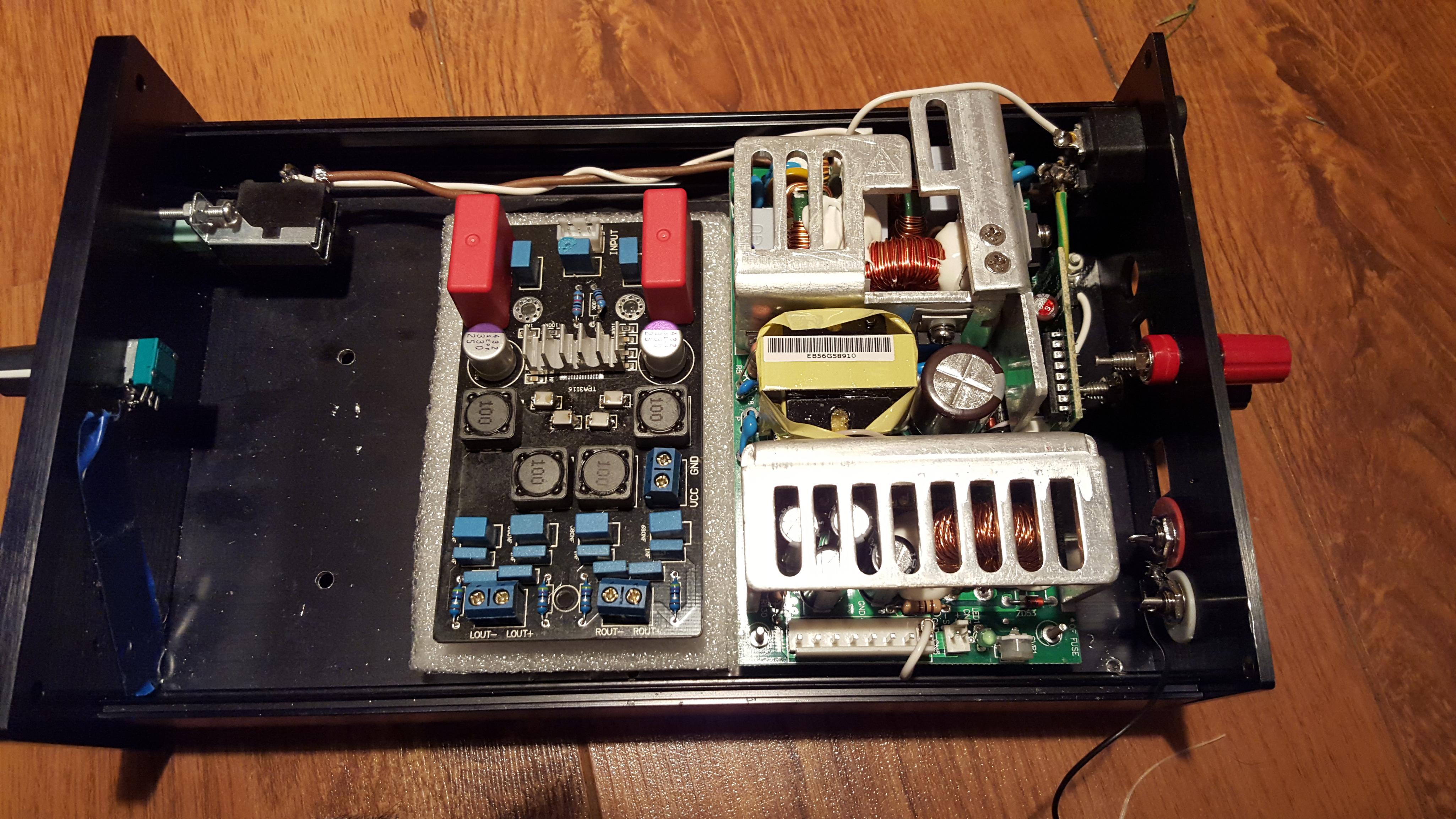

Have attached some pics just to show how pleased I am of my smps selection that fits perfectly into an old chassis I had lying around

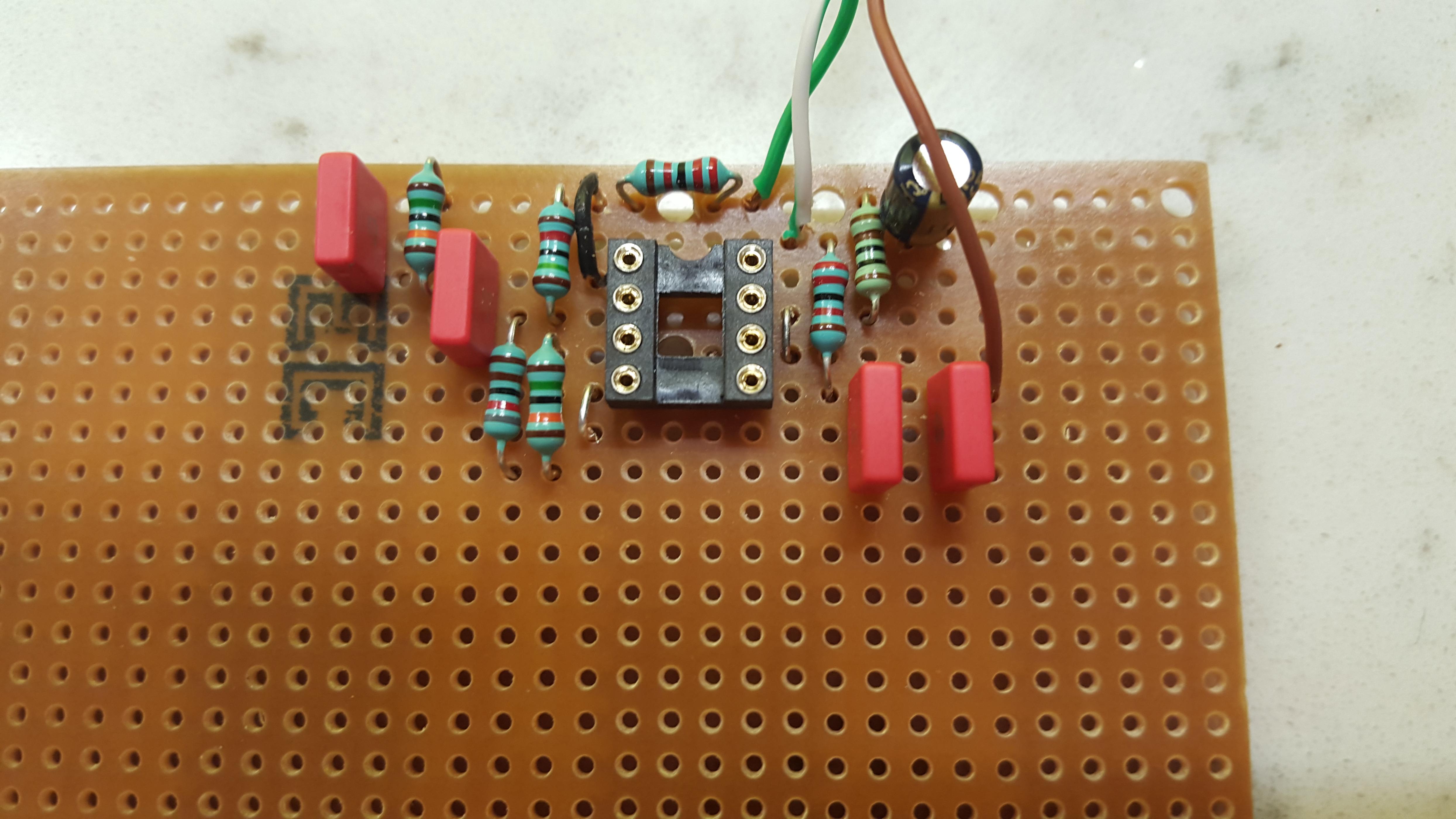

Have also attached pic of my first ever opamp build for the filter. Since choosing and building the opamp 2nd order RC filter - I have done lots more research and realised that I may be very soon building a better filter section. But if I get the PSU and grounding right then this will be quite easy to swap out. I just wanted to build my first filter around a circuit I 'vaguely' understand.

Looks like you have a bit of space left.
Make sure you keep all of the AC section of your power supply well away from the DC/Audio parts.
Keep the amplifier inputs away from the AC line as well...noise pickup.
cheers Dug, AC live will be near either the input or output of the 3116, I thought it best to put the 3116 output nearest if anything as this will be less sensitive.

Another question, have built my regulated dual rail supply but the 7812 is giving me 11.66 volts, the 7912 is giving -12.03V
Could this be a faulty 7812? I pulled it from a cheap chinese DAC. I read somewhere that the tolerance should be 2.5% max for a 7812.
stu
11.66 won't hurt the cct, only limit the output swing to .34V less than with 12V.
I don't think you will need 10Vpeak signal for a 3116 amp.
I would replace it but it will work.
According to TI's datasheet for LM78xx the tolerance is ±2% for LM78xxCT and ±4% for LM78xxACT. yours 7812 is 3% off. Not a big deal.Another question, have built my regulated dual rail supply but the 7812 is giving me 11.66 volts, the 7912 is giving -12.03V
stu
If you want to rise its output voltage then add a low power Schottky diode from ground pin of 7812 to ground, that will give you 0.2-0.4v boost.
