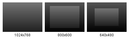

I just bought a Sharp QA-2500 and I'm very frustrated that I'm seemingly unable to get it to work with my TV-4000. Can anyone please help? Is anyone getting a good picture out of this thing with a DVD player as a source (not a computer)? Please tell me how!
S-Video straight in from my DVD player works, but the picture is really small.
I can press "enlarge," and the picture fills the screen but looks really lo-res and rough. That's no good.
VGA-in from my computer works (1024x768@60Hz), but I'm not using it with my computer, so that doesn't help me.
I'm using a TV-4000 "XGA Theater" line doubler from www.avtoolbox.com
I know the TV-4000 works because I can get it to work with my 2 other panels - in all resolutions.
The QA-2500 senses the signal and displays a picture for all resolutions of the TV-4000, but the image is always black. I mean just black - no picture at all. Very strange. I believe the TV-4000 has a 60Hz refresh rate as well - pretty standard.
I should clarify about the black... At 1024x768, the "black" fills the screen... at 800x600, the "black" is a little smaller, surrounded by a margin of "darker black." At 640x480 from the TV-4000, the "black" is smaller still, surrounded by big fat margins of "darker black..." Does this give you any ideas?
Do you know why I'm having these problems? I've pulled my hair out and dug through every on-screen menu. Nothing seems to have any effect. (I have no idea what those "sense" items are, though... do you?)
I'd appreciate any help anyone can give me. As things stand right now the panel is doing nothing for me 🙁
Is anyone using any kind of line doubler to drive this panel??? Tell me what kind and I'll probably sell my TV-4000 and buy whatever you've got!!!

your best bet is to use the panel with your pc instead of a line doubler. the problem you are having is most likely due to a conflict between the line doubler attempting to scale the dvd feed( resolution from standalone dvd is about 800x600) into the panel native resolution, 1024-768(?). but since the panel has an automatic resolution sensor, a conflict in the signal decoding occurs and you get a "lite black signal". you can see how the sharp works with different resolutions by plugging in a dvd player, a cable signal or any video signal directly onto the s video input, then comparing to the pc input (vga). most likely you'll see the pc image filling the whole panel, whereas the dvd feed will be centered in the panel, but with an inactive border. no real solution. that's how the panels where programmed back then.
More research about my problem...
I decided it would be more clear to post a picture of what I'm obsering on my QA-2500 from my TV-4000's 3 different output resolutions. Hopefully the JPEG will come thru OK.
I called AVToolbox and the tech guy said the TV-4000 outputs *roughly* 60Hz, but it might be more like 59.5Hz. He said something about the 3:2 pulldown produces this effect.
I just wonder if that's the whole problem. Maybe the QA-2500 is more finicky than my other panels about getting just the right refresh rate.

i think this is a "feature " of earlier panels that supported high resolutions. i don't think anything can be done besides changing the controller board that drives the lcd, which is a pain unless you work for sharp or something🙂 . i had a qa-1800 and did exactly the same thing(black border when using video feed, no border when using vga). why not make a cheap computer that works as yout dvd player/ line doubler thingy?? get a VIA epia M board (it has the cpu already attached, for $150) some cheap ram from best buy (on sale now with rebate, 256 mb PC2100 for $39), a cheap hard drive (western digital 40 gb for $49 at best buy this week) and a cheap 16x dvd?? the whole setup could run your video, dvd, and it has 5.1 surround sound out. maybe it's going overboard, but if you're not using the high resolution input then there really is no need to own a high resolution panel. remember standalone dvds operate around 640x480.
My pics show the results from VGA input (from my TV-4000).
From s-video straight from my DVD player I get the small video image inside a black border - which I suppose is the "correct" result.

Sharp QA-2500 / NextVision 5 UPDATE
OK I watched 2 movies on my QA-2500 now, and here's the scoop with my 2 XGA line doublers, the TV-4000 and the NextVision 5.
The TV-4000 beats the NextVision 5 in straight-up image quality hands down. Seriously - there's no comparison. The TV-4000 is crystal clear with super rich and smooth colors. The NV5, by comparison, gives kind of crunchy edges and dull colors.
The TV-4000 is apparently totally incompatible with the Sharp QA-2500.
The TV-4000 only outputs ~60Hz at 800x600 and 1024x768.
The NextVision 5 outputs 60 or 75Hz at 800x600... the higher scan rate seems to improve the "horizontal splitting" effect I've observed on the PowerView 820. This resolution also looks OK on the QA-2500, but the panel won't scale the image up so it is very small in the middle of the display, with big fat black margins.
The NV5 works with the QA-2500 at 1024x768@60Hz... but there are wavy interference lines - or something like that - moving diagonal lines across the whole image. These lines reduce greatly as the panel runs or heats up (or as I tweak the video settings to my liking, I don't know which), but they never totally go away and the image quality is not overwhelmingly good.
Fast motion on the QA-2500/NV5 is much much better than on the PV820. Hardly any artifacts at all, which is nice.
My next step is to purchase a VB50HRTV, another ViewSonic line doubler, which seems to have a selectable 75Hz rate for 1024x768... maybe that will give better results on the QA-2500.
I'll be selling my TV-4000 and either my QA2500 or PV820... depending on which winds up working the best for me.
