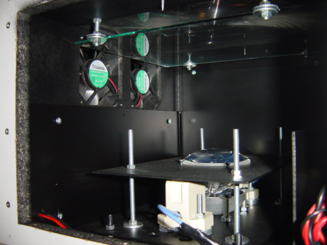

From a 3M retailer here in Greece.The polarizers come with adhesive glue in one side and you must be very carefull so everything is very clean .Removing the old ones also is a little bit difficult but doable.I will post some more pics soon.

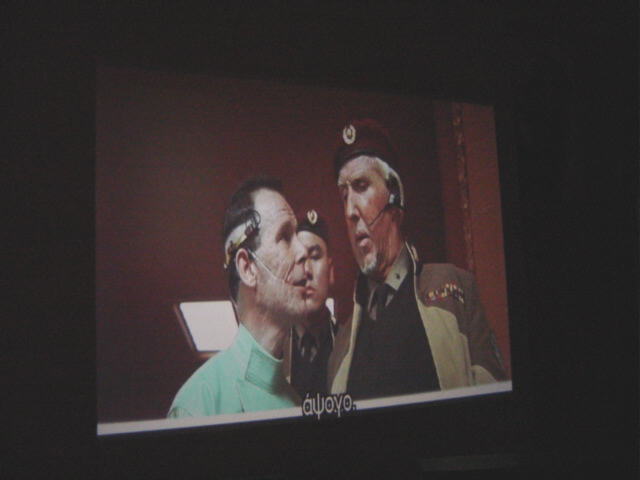

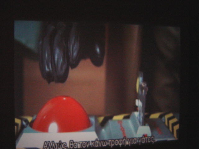

Wow😱 !!! Looks great! really like the clarity on the windows shots! Never expected tha from a qa-1650!
Well done!😀
Well done!😀
