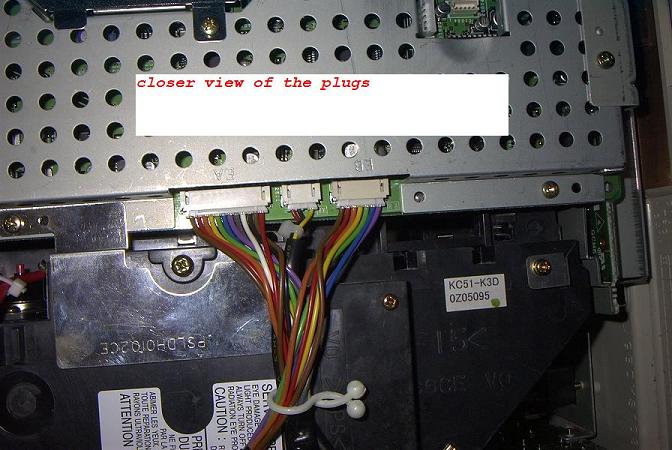

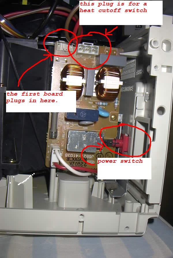

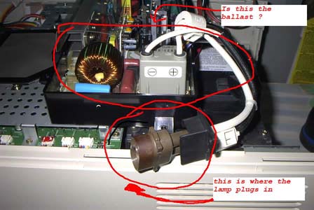

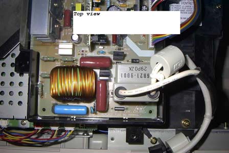

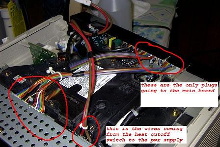

i got a viewsonic pj501...i took it apart and figured out a few things..just need some help from you guys...i turn it on..not much happens cause it wants a bulb...so i need to figure out how to trick it..i think i found the cable that goes from the mainboard to the ballast but i dont know how to short it...its got 3 brown wires and a yellow one
here is a pic:

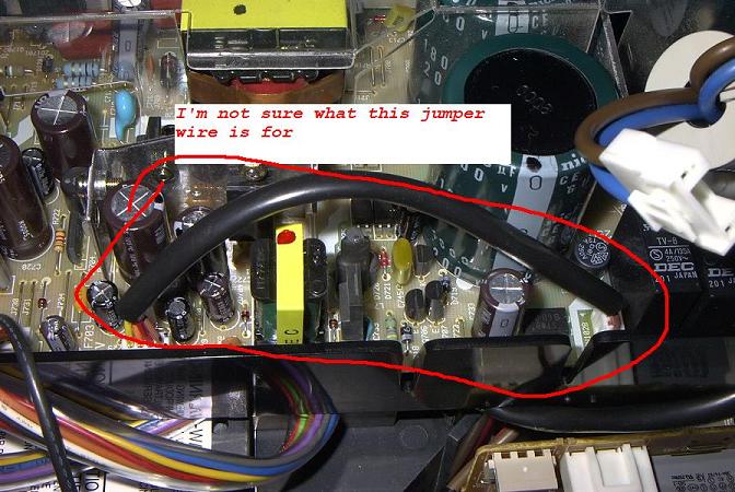

another question is in the front coming out of the mainboard are two wires connected to a black thingy what is it?
here is a pic:

mindless_fool said:i got a viewsonic pj501...i took it apart and figured out a few things..just need some help from you guys...i turn it on..not much happens cause it wants a bulb...so i need to figure out how to trick it..i think i found the cable that goes from the mainboard to the ballast but i dont know how to short it...its got 3 brown wires and a yellow one
here is a pic:
I knows this is really old but hey if you are still around This is what you have to do. jump the 2 middle brown wires and thats all there is to it. You probably have a switch where the bulb goes so you will have to make sure that switch is closed. I guess this can help other people to. 🙂
